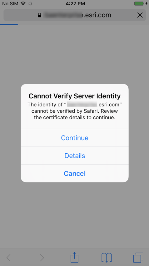

  1. Open a Safari mobile browser and navigate to https://MyServer.esri.com/portal/home/
Safari Browser
Safari Browser

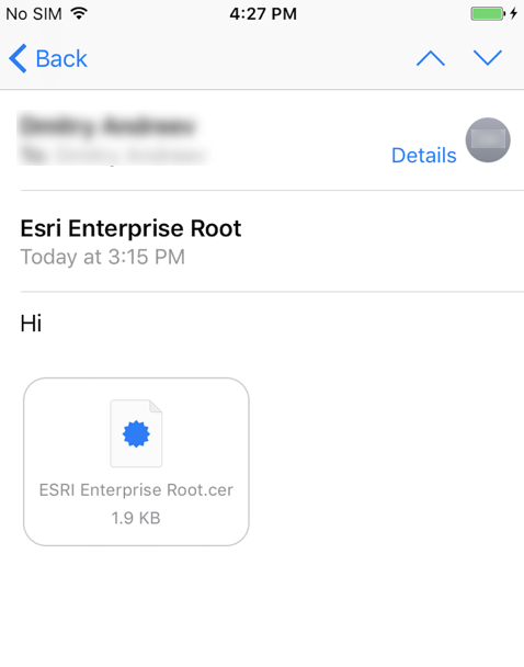

2. Download the SSL Certificate (For example, Esri Enterprise Root certificate) for this site, in the device.
email attachment
email attachment

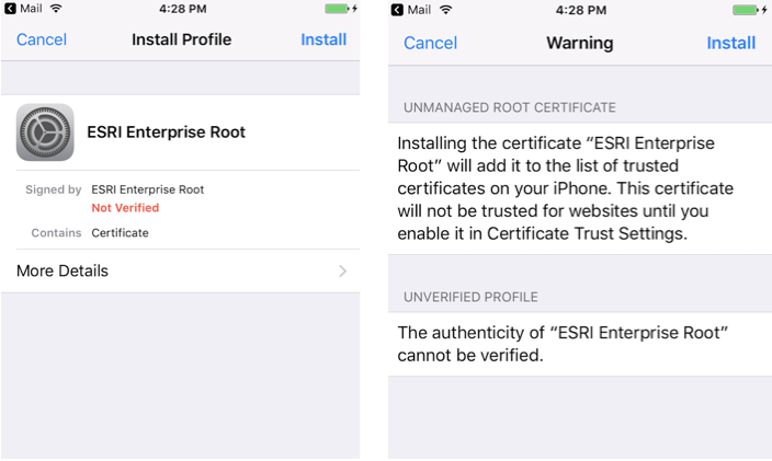

3. Tap on the certificate attached to download. Tap Install.
Install Profile
Install Profile

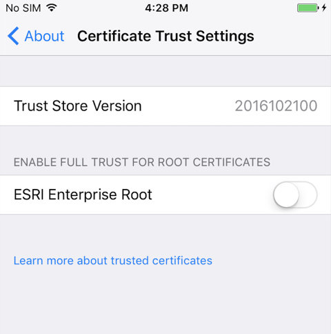

  1. Go to Settings -> About -> Certificate Trust Settings, enable Esri Enterprise Root certificate.

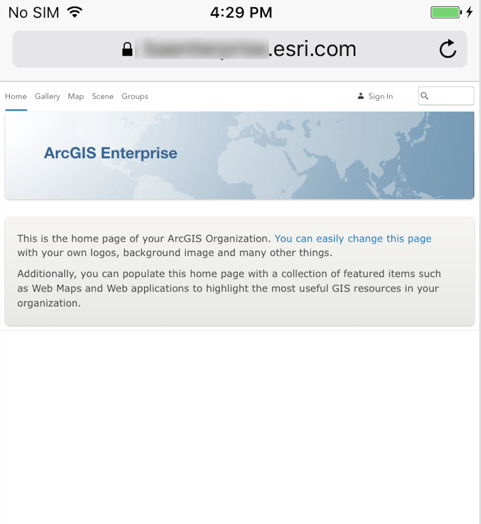

5. Now open the Safari mobile, navigate to https://MyServer.esri.com/portal/home/ and you should now be able to access the site with no issues.
Portal in a browser after installing the certificate

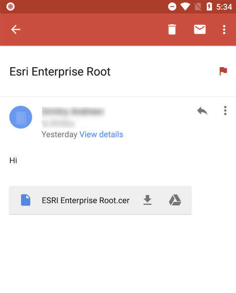

  1. Download the SSL Certificate (For Example, Esri Enterprise Root certificate) on the android device.
email attachment
email attachment
2. Tap on the certificate attached. Name the certificate appropriately. Click OK

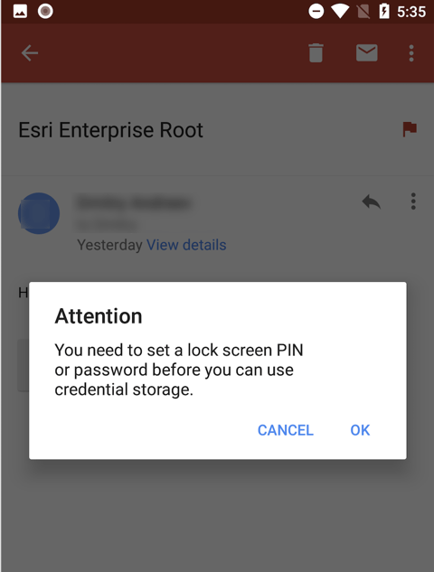

3. Android will require you to lock the device. If you do not have one set up already, you will have to do it now.

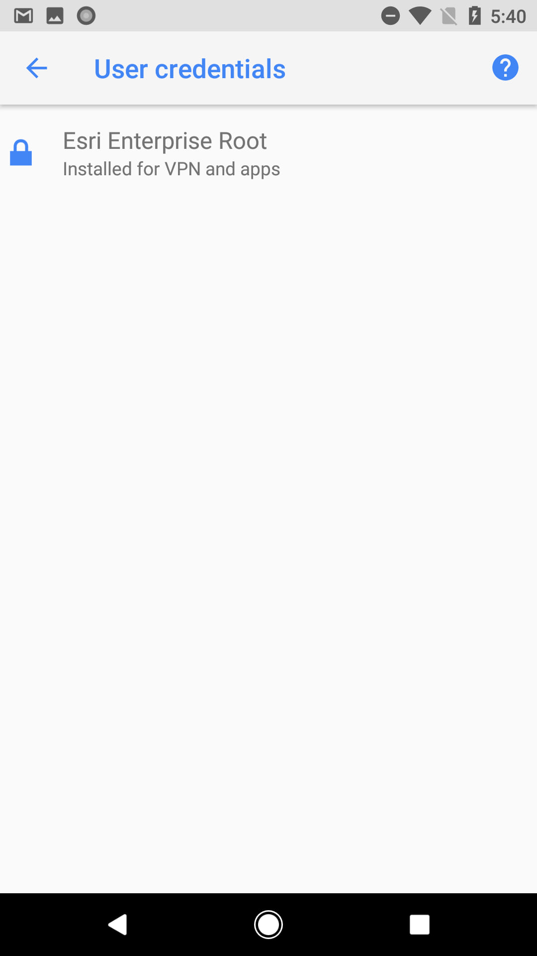

4. Go to Settings -> Security & Location -> Encryption & credentials -> User credentials and verify that the certificate is installed.

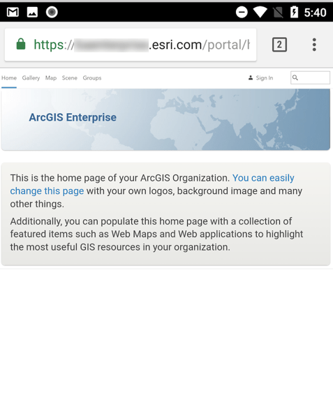

5. Open Chrome, navigate to https://MyServer.esri.com/portal/home/ and you should now be able to access the site with no issues.
