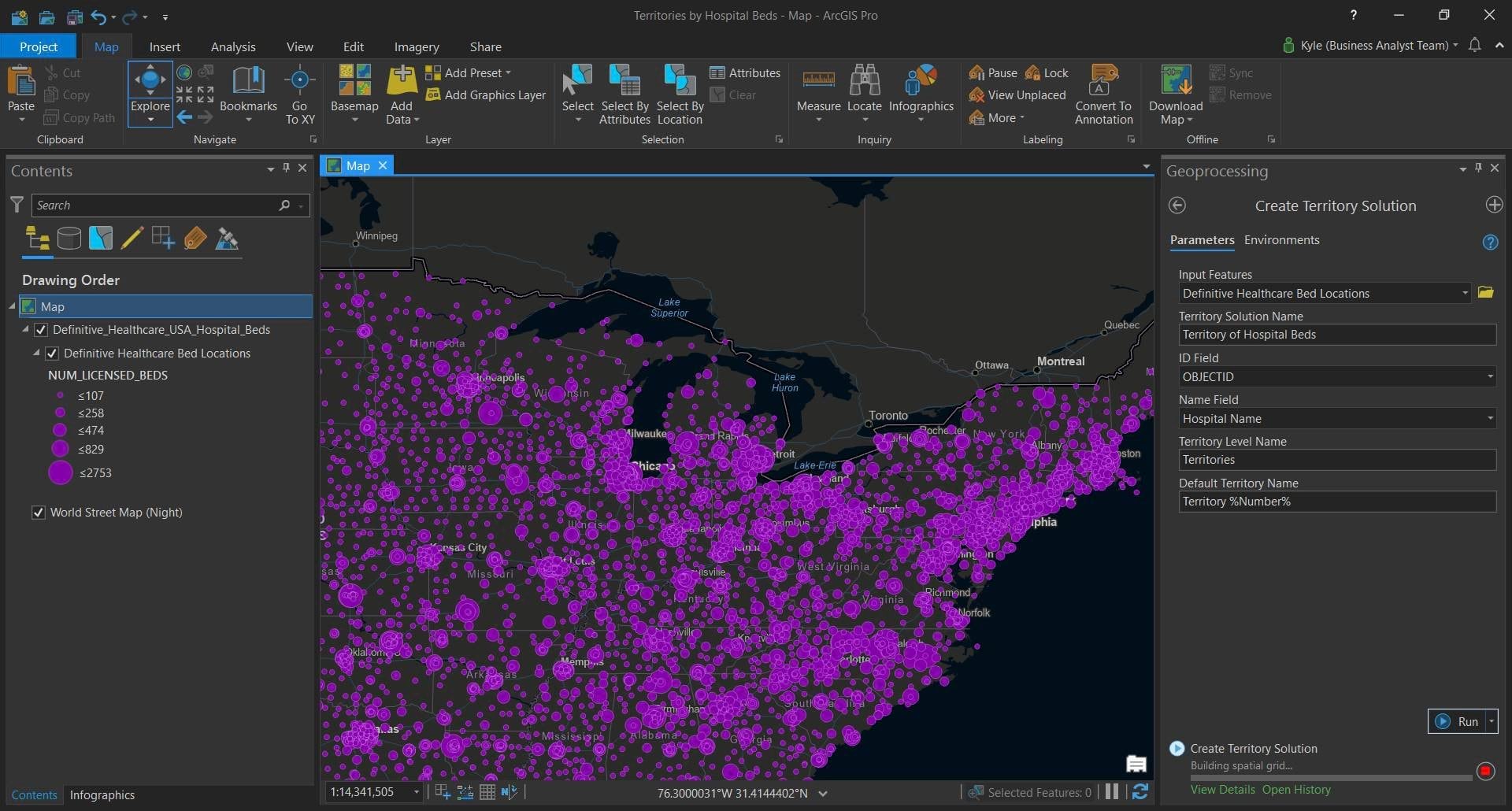

1. Bring in the hospitals/beds data and set up the Create Territory Solution. The territory solution is the foundational structure for all-things-territories, based on the input layer.
Once created, the territory solution layer activates a context menu at the top with options for working with territories.

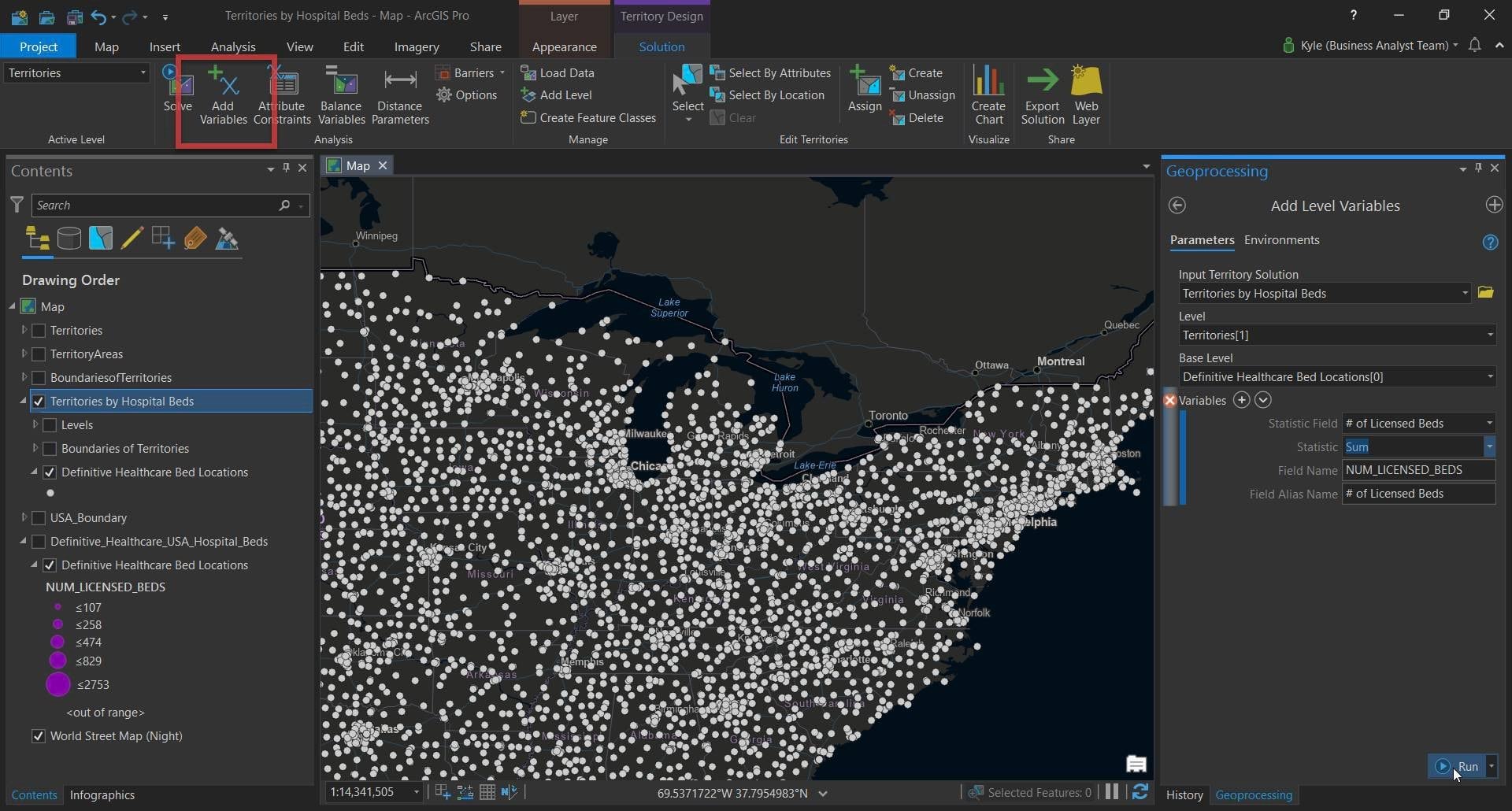

2. Adding variables lets you tell the system what rules you want to apply to the territory creation. In this case we will keep it very simple and generate territories based on a balanced number of beds, so we’ll need to add those up.

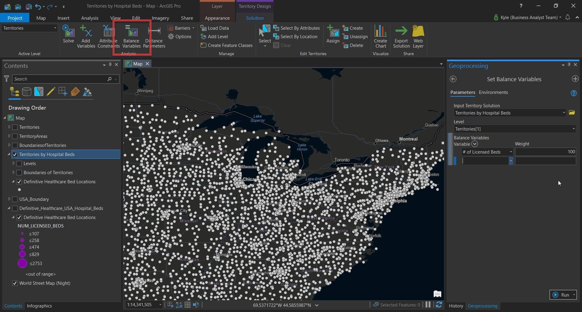

3. Next we tell Territory Design how to equally distribute territories. In this example we apply a simple balancing based 100% on the number of beds. This could be enhanced to also consider ICU beds, staffing, protective equipment, number of facilities, the proportion of elderly or vulnerable population, etc. Whatever data you have.

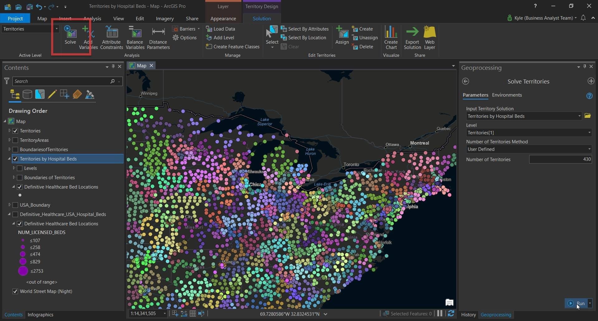

4. Then we apply our settings—we “Solve” it. And we’ll tell the software how many territories to create. Looking at the hospital bed count we know we have approximately 863,000 beds. If we carve out areas of roughly 2,000 beds we’ll need 430 territories. 2,000 seems like a reasonable size to manage, but of course this is flexible based on your needs. The Solve operation generated 430 territories based on these very limited inputs. This geoprocessing took around 5 minutes.
That’s it. All input hospital locations (and their constituent beds) have been assigned to a new territory, with each territory representing roughly 2,000 beds.

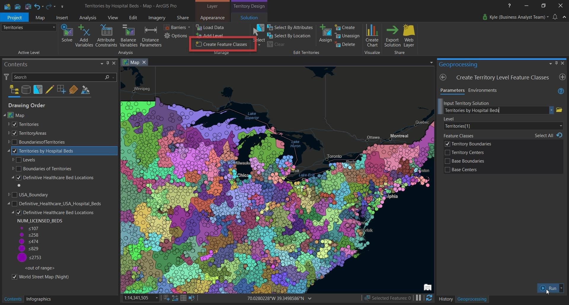

Lastly, and optionally, we can create polygons to encompass these areas so that we can enrich these nascent hospital bed territories with critical underlying demographic, economic, or industrial data. This aids in benchmarking, impact planning, and supply-chain consideration.
