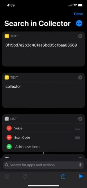

The first two actions in the shortcut define the web map (using its itemID) and the app you want to use to search in.  Currently you can use both Collector and Explorer to execute a search.
iOS Shortcut defining Map ID
Define the web map ID and target app.

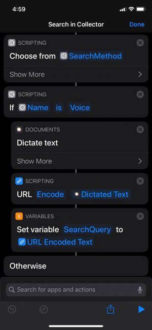

The second portion gathers input from the user based on the search method they selected.  In this case you can search using your voice or by using the camera to scan a barcode or QR code.
IOS Shortcut Defining Search Entry
Gather input based on search method

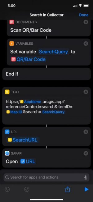

Finally the input to be used for search needs to be configured (encoded) to meet the requirements to search via a URL.  This is important for cases that use special characters or spaces.  Thankfully there’s an action that does all the encoding for you.
IOS Shortcut Execute Search
Execute the search in Collector
