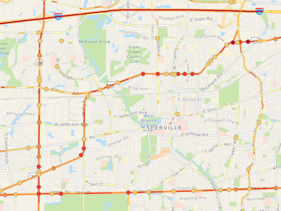

Here is an ArcGIS Pro tool that helps build a HIN with relative ease. All the tool requires as input is a shapefile of streets/intersections of the city, another shapefile comprising all crash locations, the time range (in days/weeks/years) across which you want to perform analysis, the snap to street distance (in feet/meters). The result, as generated for Naperville, IL, is a shapefile of the crash rates color coded based on frequency of crashes on each street:
naperville_hin
The beauty of this tool lies in its simplicity.
  1. A HIN for any place can be built with minimum datasets, and can be easily published and shared online.
  2. Results can be generated in both Shapefile and GeoJSON formats.
  3. The outputted map and data can then be shared with concerned city officials that are involved with decision making, thus exempting them from the process of generating the HIN themselves.
