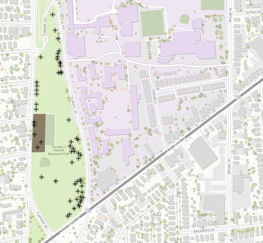

Based on your feature count in a gauge in GeoPlanner Tools and Methods – Part II, you see that you are close to your goal of 60 trees in the park. However, you need to take into account the fact that the municipality has already approved a plan to expand the parking lot adjacent to the ball field. Any trees that are currently located within the new planned extent of the parking lot will be cut down during construction. This pertinent detail must be included in your decision-making process.
Trees on the chopping block
It is possible to remove these trees from your feature count considerations using GeoPlanner’s analysis tools. Such a task could be performed in ArcGIS for Desktop using the Clip tool, with the trees in the park layer as the Input Feature to be clipped and the planned parking lot layer as the Clip Feature. The same output can be produced in GeoPlanner using the Overlay Layers tool.

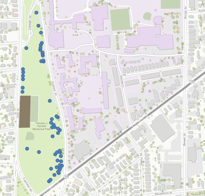

Step 4: Choose Erase as your overlay method.
After you have run the analysis, you will see that the trees that will be cut down during parking lot construction have been removed from your output layer.
The trees represented by the blue points will be unaffected by the parking lot construction.

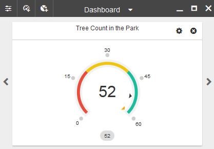

In the Evaluate segment, open the dashboard and switch to your Tree Count in the Park dashboard. You will notice that GeoPlanner has dynamically updated your feature count displayed in the Tree Count in the Park dashboard.
A gauge is a dynamic monitoring system for your project, allowing you to view project changes in real-time.
After taking into consideration the trees that will be removed for parking lot construction, you observe that there are 52 trees planted in the park that will not be removed. This means that you should plan to plant approximately 8 more trees to reach the target for your beautification project. Based on the data gleaned from your dashboard, you can now accurately estimate the cost and extent of the project and present this information to municipality decision-makers.
