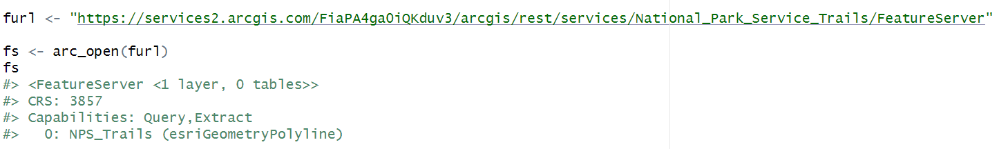

Now assign the URL to an object, furl, and use arc_open() to retrieve the metadata for the National Park Service Trails FeatureServer:
arc_open()

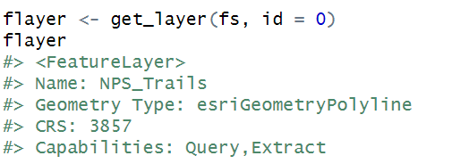

This FeatureServer just contains one layer. You can access that layer by its ID (0) using get_layer():
get_layer

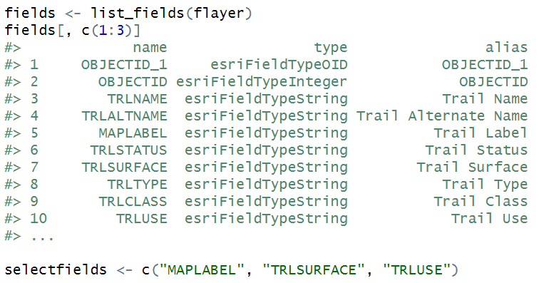

Start by viewing the fields and selecting a relevant subset:
list_fields

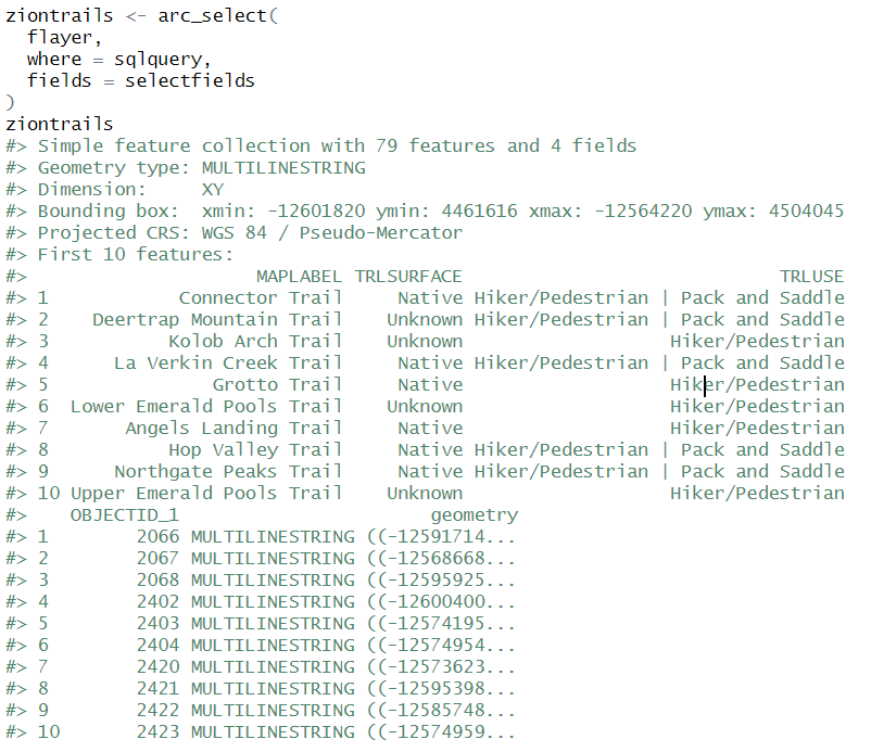

Now use these objects to load a subset of the feature layer’s trail data:
arc_select

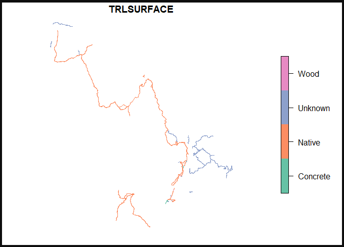

This returns an sf object containing the Zion National Park trail features. You can use plot(ziontrails['TRLSURFACE']) to view the spatial features, symbolized by trail surface type. From here you can conduct analysis, build apps, or create visualizations in R!
A plot of the Zion trail features symbolized by trail surface type
