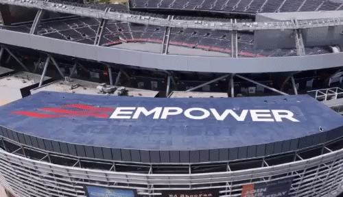

Gaussian splat layers
Version 300.1 introduces support for Gaussian splat layers, enabling highly realistic visualization of complex built and natural environments in local scenes. By preserving fine-grained detail, Gaussian splats support high-fidelity digital twins and are well suited for representing intricate infrastructure, including utility power lines, industrial pipelines, construction equipment, and plant facilities. They can also capture transparency and reflections in human-made features, such as windows and metal surfaces, while accurately representing vegetation and other natural elements.
Gaussian splatting is a computer graphics technique that reconstructs a 3D scene from millions of individual Gaussian splats. Each splat is a soft, ellipsoid-shaped element defined by its position, rotation, size, color, and transparency. When rendered together, these elements form a smooth, photorealistic 3D representation.
Gaussian splat layers can reference web layers published to ArcGIS Online or ArcGIS Enterprise for connected workflows. They can also use local Gaussian splat content distributed as a 3D Tiles dataset or archive, supporting offline, secure, and bandwidth-constrained workflows.
Gaussian splat layers are supported in local scenes using the local scene view. In version 300.1, this capability is available for desktop applications built with ArcGIS Maps SDK for .NET and ArcGIS Maps SDK for Qt. Support for mobile applications on Android and iOS across the Native Maps SDKs is planned for a future release.
GSL of Mile High Stadium
Gaussian splat layer. Map Data: Denver Mile High Stadium Drone 3D Gaussian Splat by bconnolly_IVT5.

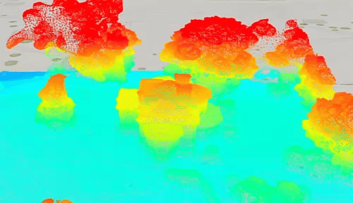

Point cloud layer renderers and filters
The 300.1 release adds support for point cloud layers in local scenes, bringing them in line with support already available in global scenes. This release also expands the point cloud layer API (available in local scenes only), giving you greater control over visualization and filtering.
You can customize point cloud layer display using several renderer types. Use a class breaks renderer to symbolize quantitative attributes, a unique value renderer for qualitative text values, a stretch renderer to apply color stops, or an RGB renderer to display RGB values from specified fields. You can also adjust point size and modulate point colors to highlight patterns in the data.
Filters provide additional control over which points are displayed. Use value, return, or bit field filters to show points based on attribute values, LiDAR return types, or bit flags. By combining renderers and filters, you can more easily distinguish and focus on features such as buildings, vegetation, and ground surfaces.
PCL API changing renderers
Changing renderers on a point cloud layer at runtime.

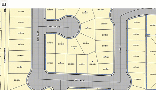

The MapView now also supports identify operations on vector tile layers published with feature IDs. Identify results include a new VectorTileFeature object containing the feature’s attributes and associated VectorTileStyleLayerType, as well as geometry for point-based styles such as symbols and circles.
This capability enables feature-level interaction with vector tile content without requiring a separate feature layer. For best performance, publish only the attributes your application needs, since storing excessive attributes can increase tile size and negatively affect rendering speed and memory usage.
Vector Tile Identify
Identifying features in a vector tile layer.

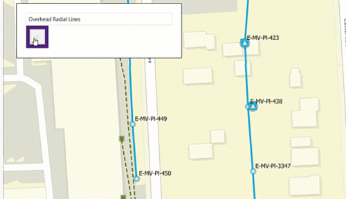

  • Template-driven feature creation now also supports the creation of radial lines. The CreateFeaturesAsync() method on ServiceGeodatabase can now use a single template to generate multiple connected features from a common origin. This is particularly useful for utility network workflows, such as creating several service connections from a transformer or distribution junction.

Shared edit templates for radial lines
Using a template to create connected, radial lines from a common origin.

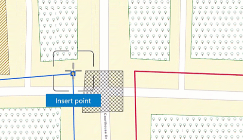

Track geometry changes during edit events
New geometry editor events allow applications to respond dynamically to user edits and changes in edit state, helping you guide users toward valid edits as they work and reducing the need for manual post-processing, further streamlining data capture workflows. The new InteractionPreviewChanged event on GeometryEditor enables your application to react to an ongoing edit before the edit is completed. You can use the information included in the event to provide immediate user feedback, such as:
  • Display a warning as soon as a potential edit crosses a restricted boundary
  • Change symbology when a property of the geometry reaches an invalid value
  • Block or discourage edits that exceed allowed area or length thresholds
This event is particularly valuable when used with the ProgrammaticReticleTool, because the event data and granular reticle control let you enable or disable editing actions in real time as the user performs their feature geometry edits.
Editor interaction events
Using interaction events to inform the user while editing geometry.

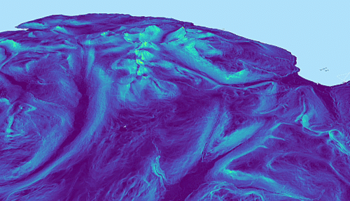

New slope and aspect functions calculate terrain steepness and the direction a slope faces. The analysis APIs can also now process datasets larger than 2 GB by dividing the work into smaller GPU-queued regions and then combining the outputs into a single result file.
Analysis API Slope and aspect
Calculating slope and aspect on terrain.
