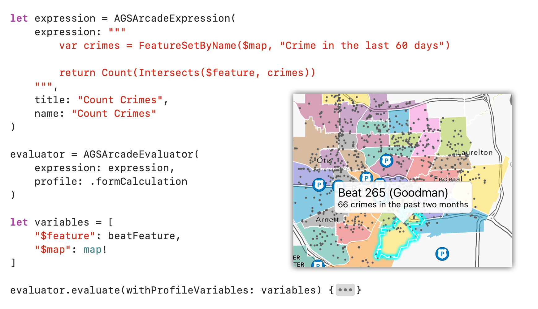

Arcade is a powerful scripting language that permeates throughout the ArcGIS system (in ArcGIS Online, ArcGIS Pro, ArcGIS Enterprise, and elsewhere). It’s used in rendering, symbology, popups, attribute rules, attribute calculations, and more. ArcGIS Runtime SDKs have long supported Arcade, but a frequently requested feature has been to allow developers to execute Arcade themselves. Use cases include validating Arcade expressions, or building custom user experiences around Arcade found in web maps or elsewhere.
Runtime 100.14 comes to the rescue with a powerful new Arcade API. Simply create an Arcade Evaluator from an Arcade expression. Whenever you need to see what that Arcade expression evaluates to, you create a dictionary of Arcade variable names mapped to Runtime objects and call Evaluate. You can then use the result however you like. The Arcade API will even tell you which variables a particular Arcade expression needs you to include in the dictionary. And because you pass in Runtime objects, all the bridging is done for you.
Runtime Arcade Evaluator example (iOS)
An example of using the new Arcade Evaluator in Swift to count point features within a polygon.
As a bonus, we’ve also exposed an Arcade console. Any time your Arcade script makes a call to the Console() function, that console message will be bubbled up to your Runtime app to display or log however you like. This should simplify working with and debugging Arcade expressions, whether through the new Arcade API or through other parts of Runtime such as utility network or Geotriggers.

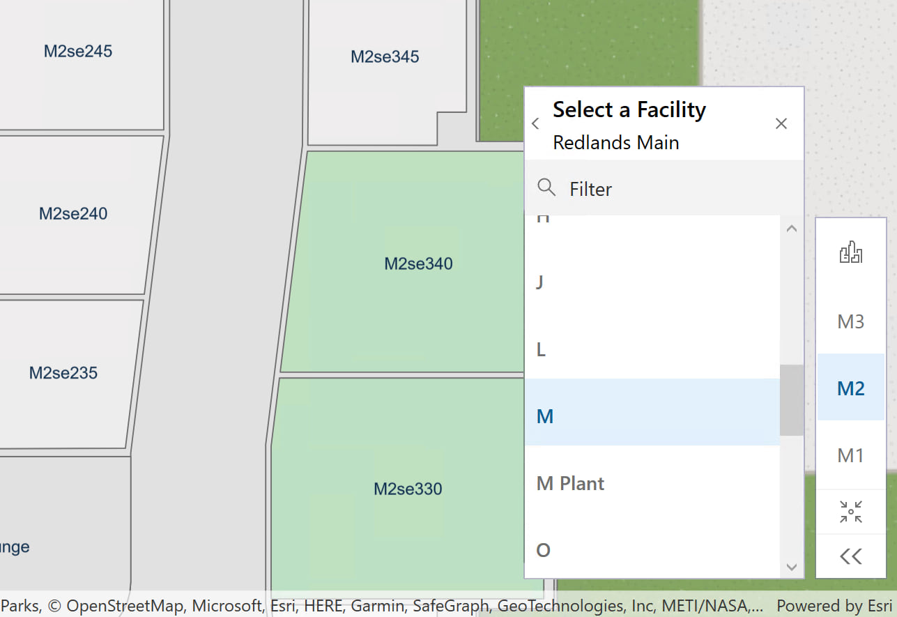

The toolkit team has been hard at work to bring you a brand new interactive Floor Filter component, available for .NET, Android, iOS, Java, and Qt.
Floor Filter component from the toolkit for the ArcGIS Runtime Toolkit for .NET
The Floor Filter component from the toolkit for the ArcGIS Runtime SDK for .NET showing facility and floor selection capabilities.
The picker allows you to select sites, facilities and floors from your floor-aware maps and scenes, and can be context sensitive to adjust itself as you navigate the map. See each SDK’s toolkit for more details (.NET, iOS, Android, Java, Qt).
