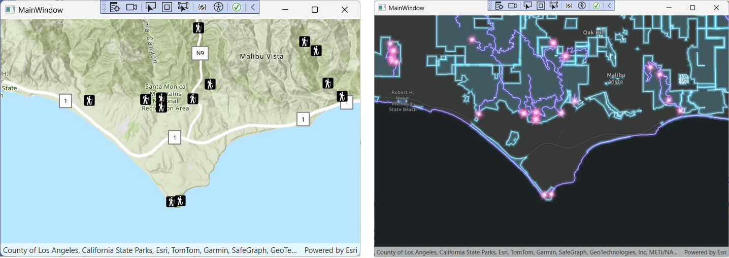

In this blog, I’ll show you how I take the Malibu data used in Native Maps SDKs tutorials and change its symbols for its feature layers of points (trail heads), lines (trails), and polygons (parks) into glowing, besparkled symbols using the Firefly style, which was created by John Nelson.
		In this blog, you’ll see me use ArcGIS Pro to create a mobile style file to fill with styles I want. I add styles to it from the Firefly style, then I show how you can grab other styles and add them to the same mobile style file. Lastly I use the mobile style file in my app to style the Malibu layers.

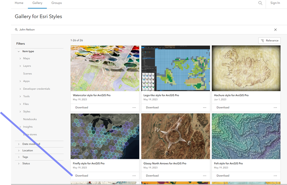

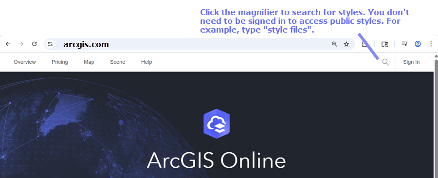

First, I went to arcgis.com to see what styles were available. I chose Firefly.

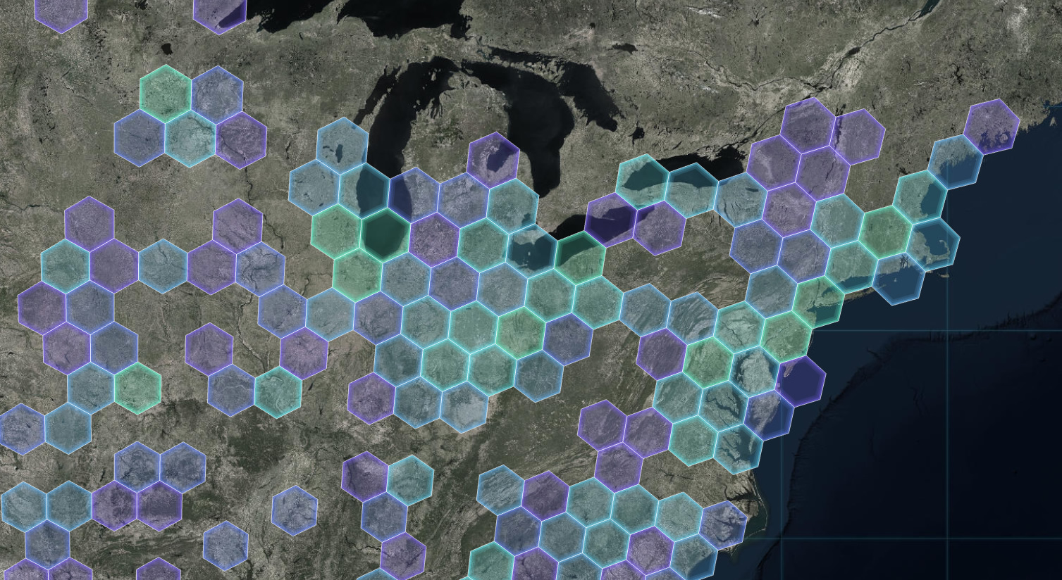

I love the Firefly style because it can make your map elements appear to glow and sparkle. But let’s suppose you want a different style. A multitude of styles are available for you to choose from in John Nelson’s gallery as well as in ArcGIS Online.

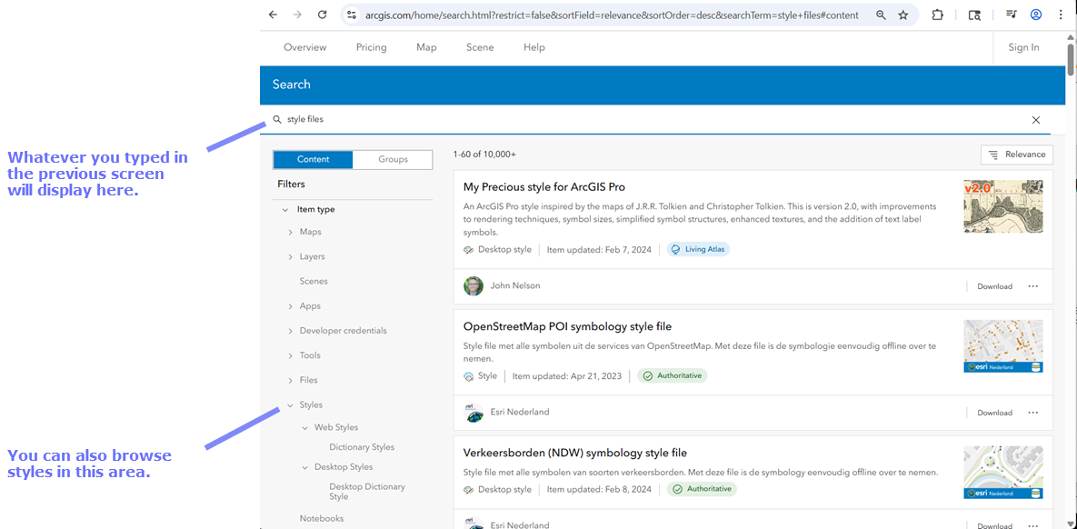

The following images show how you can find a style you want to try.
		After you enter “style files,” the public style files display. You can type additional or different keywords in the search to filter the results, or you can browse all style files. For example, you can type “firefly style for arcgis pro” to quickly get to the style used in this blog.
		2. Download the style file you want
I chose the Firefly style because it can make your map elements appear to glow and sparkle.
I downloaded Firefly to my computer by going to John Nelson’s style files and clicking the Download button for Firefly style for ArcGIS Pro. I downloaded the style to my project folder (the folder with my .csproj file).

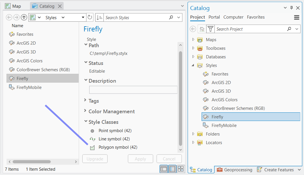

- In ArcGIS Pro, in the Catalog pane’s Project category (tab), I created a mobile style by right-clicking Styles then clicking New > New Mobile Style. I navigated to my ArcGIS Pro project folder, then typed FireflyMobile as the name of my new mobile style file, then clicked Save.
- I added the Firefly style to the project. On the ArcGIS Pro ribbon, I clicked Insert, then in the Styles area, clicked Add Style.  I navigated to the location I downloaded Firefly.stylx to (the folder with my .csproj file) and double-clicked Firefly.stylx.
 Tip: If you don’t see it where you expect, remember to click the Refresh button near the top of the Add a Style File dialog box.

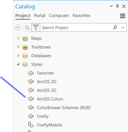

- After I saw Firefly.stylx in the Styles folder in Catalog, I double-clicked it.
- In the Style Classes area that displays, I selected the first style class that stores the styles I want to bring over, Polygons.
		Another pane displayed that shows the 42 polygon styles available. From there, I selected the style items I wanted to bring over. In this case I selected FireflyPoly_8 to style my polygons. I used Ctrl+C to copy it, then I Ctrl+V into FireflyMobile.stylx to copy the styles there.
I repeated this step for FireflyLine_5 in Lines and FireflyShimmer_2 in Points.

I could also select style items from other styles, such as from ArcGIS Colors, and bring those over into the same FireflyMobile.stylx style file, the same way I brought over the Firefly styles.

In this first block of code, I create the map with a dark basemap style.
