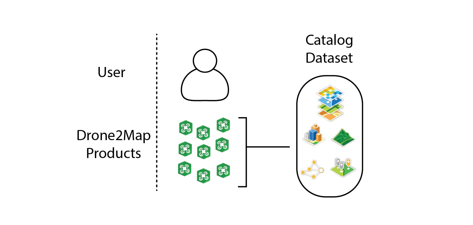

Local catalog
Local catalog organization diagram
Local catalog dataset organization.
You have collected and processed multiple projects and are now looking to store all your drone project results on a single machine. A local catalog dataset is a great option for when one individual is maintaining all the results from many Drone2Map projects.

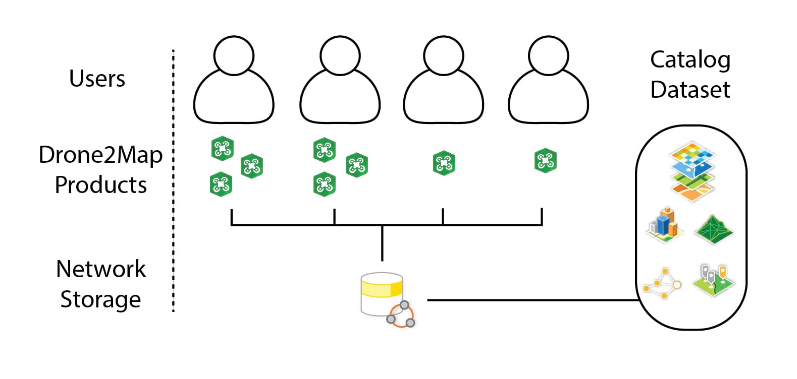

Shared local catalog
Shared local catalog organization diagram
Shared local catalog dataset organization.
You and multiple coworkers frequently process different Drone2Map projects. These projects can be over the same area or different areas or times. Due to an ever-increasing number of projects, it has become hard to store and quickly reference results without the need for multiple projects across multiple computers. With a shared local catalog dataset, the catalog and file-based products are stored on a shared network drive. This option is ideal for catalog users who process and analyze file-based products on multiple machines and want centralized and shared storage for their drone products.

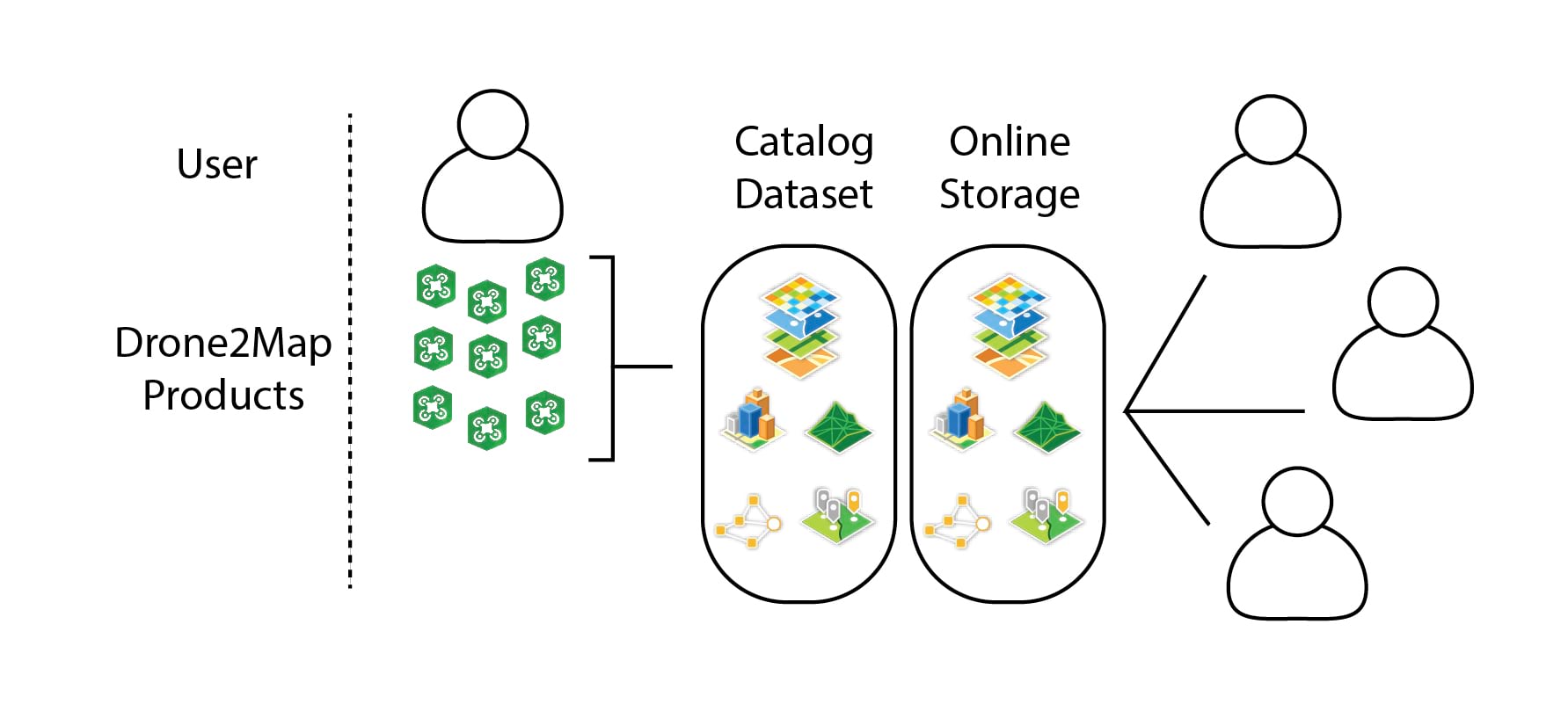

Web catalog
Web catalog dataset organization diagram
Web catalog dataset organization.
You need to organize and store output Drone2Map products where your remote coworkers can view them. However, they only need to view them, and you oversee the processing and organization. Web catalog datasets can be stored locally or on a shared network drive to reference products that are shared as web layers from ArcGIS Enterprise or ArcGIS Online. This option is ideal for users who work with web layers in their desktop applications (ArcGIS Pro and ArcGIS Drone2Map) and want to quickly search and discover web layers over any area of interest.

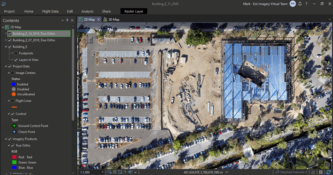

Change over time
Using catalog datasets, you can monitor a site for change over time. By loading products from flights over the same area, you can stack the layers and use visualization tools to get an idea of the project or area’s progress.
Catalog layers depicting change over time.
Catalog layers can be overlaid to show change over time.

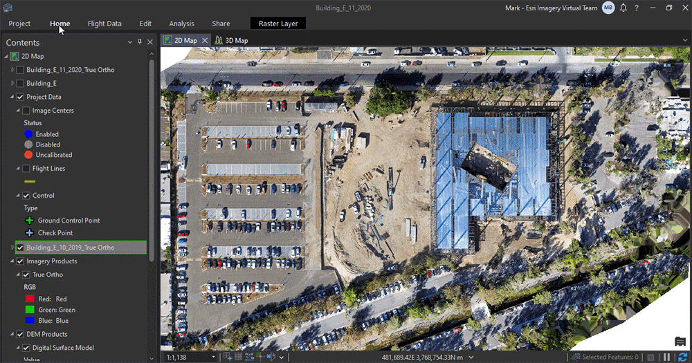

Generate ground control points
If you have collected multiple flights over the same area and stored them in a catalog dataset, you can use past true ortho outputs to generate ground control points for future projects. This helps ensure that your future flights will align with your existing catalog layers.
Creating ground control points from layers
Marking ground control points from an existing catalog dataset layer.
