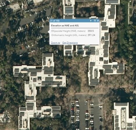

You can check if your RTK values are refencing an orthometric or ellipsoidal datum by using the Sample Heights for World Terrain map. Navigate to the location of your project area and click any pixel:
Screenshot of the world elevation web map after a point has been selected and the pop-up showing the ellipsodial and orthometric height values for that point
A pop-up window will show the elevation values of that location in ellipsoidal and orthometric heights.
If you are not able to change the values by configuring your drone’s RTK hardware, you can configure Drone2Map to import the image metadata with ellipsoidal heights (see the choose a vertical reference section in the Vertical reference topic in the Drone2Map help). If you are working in Site Scan, after uploading the images and before you start processing, you can set the input image vertical datum to a specific ellipsoid datum, and then the output to a specific orthometric datum. If you are trying to add your output products to an ArcGIS Online Scene, please be aware that it uses ellipsoidal heights from the EGM96 ellipsoid so make sure your Z values are using the same datum.

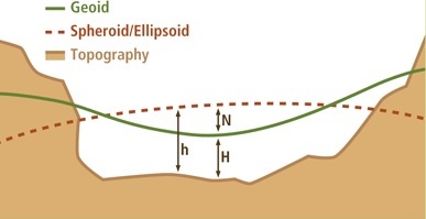

Geoid—An equipotential, or level, surface of the earth’s gravity field, which is approximately the mean sea level (MSL). The geoid is influenced by the composition of the earth, so it has nonuniformities in its slope, considering its surface is an analytic surface as opposed to a mathematical surface (ellipsoid).
Diagram showing an example of the different vertical surfaces (geoid, ellipsoid, topography)
In the illustration above, the green line represents the geoid surface. It gently curves to follow the topography. The dashed line represents the surface of the ellipsoid. The h is the height above the ellipsoid (HAE). In this case, height is a negative value. Geoid undulation, N, is the distance between the spheroid and geoid surface. The orthometric height, H, is related to the ellipsoid height by the following:
h = H+N

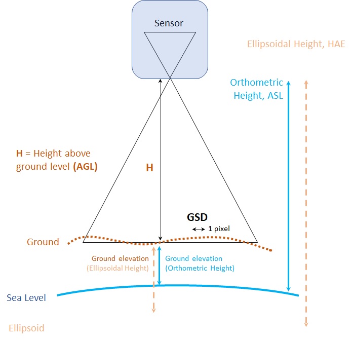

It’s important to understand that there can be many different height values:
  1. Height above ground (AGL) — In this case, you or your client are interested in seeing only the difference in elevation values between two points on the surface, point clouds, or 3D mesh created in the software.
  2. Orthometric height (ASL) — In this case, you are looking for the height above sea level, which is how we usually describe heights of objects. This height is generally used when describing the heights of natural features, for example, the height of Mount Everest—29,032 feet (8,848 meters) —or Mount Kilimanjaro—19,341 feet (5,899 meters).
  3. Ellipsoidal height — This case is rarely requested but may come up with some clients who choose to work in a separate, custom vertical system. Ellipsoidal height is the native measurement made by GPS, but in most cases, GPS values are translated to orthometric height. If you have GPS data from a surveyor (for example, for ground control points), you’ll want to verify if it is expressed as ellipsoidal or orthometric height.
The following diagram illustrates the different heights:
Diagram showing different height values from a sensor above the ground
