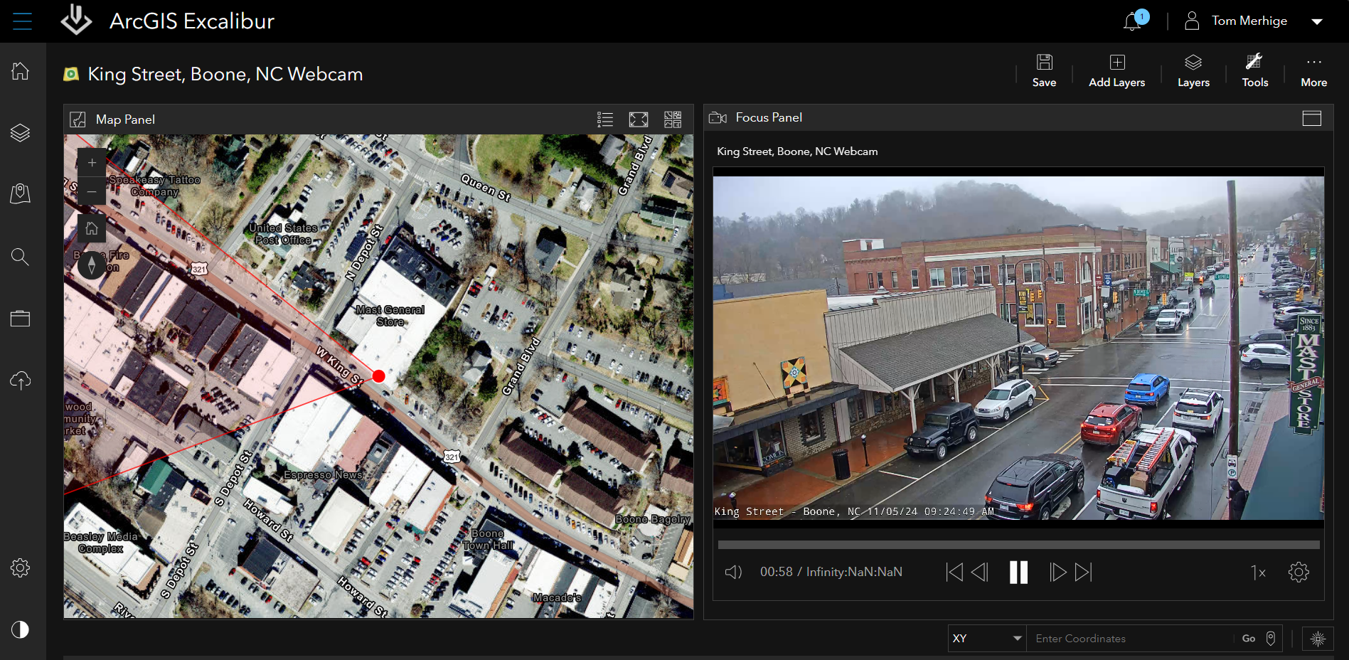

Initially, our team published video services through ArcGIS Excalibur’s publishing workflow, enabled by ArcGIS Video Server. ArcGIS Video Server preserves any spatial metadata our videos contain, retaining that information and using it to map out the location of sensors, cameras, and other devices. As a result, we carefully determined where damage and potential emergency situations had arisen by comparing the sensor locations to the video in question. We also created a livestream service for the purpose of allowing us to monitor the ongoing situation on the ground and maintain a level of awareness regarding the status of the downtown Boone, NC area.
Figure 1: Livestreaming Webcam Video

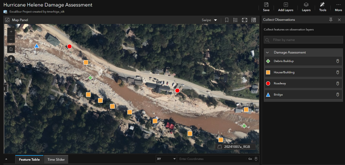

By comparing imagery taken prior to the storms with that taken immediately after, we were able to quickly assess the extent of damage in Western North Carolina. We observed that numerous roads were washed out, areas of blowdown were common in the forested areas, and entire homes were destroyed during this tragically historic event.
Figure 2: Damage Assessment Swipe
ArcGIS Excalibur as a Web Application for Analysis
One of the most crucial issues we needed to monitor was the collapse of roadways.  These roads were necessary for delivering supplies, bringing in aid workers, and ensuring infrastructure could be rebuilt in a timely manner. We noted several locations which were in particularly bad states, requiring workers to repair them so that others could get into the region with additional aid.
These damaged areas were then analyzed to determine next steps. Using the Observation Tools in ArcGIS Excalibur, we identified points of interest.  Mud slides and flooding had destroyed roads, which would require a team to clean and rebuild where possible. A number of low-lying homes had severely flooded, with the torrent of water from the hurricane having washed away entire buildings. Additionally, roadways, bridges, and buildup of debris were found which all pose serious issues when it came to evacuation, rescue, and repair operations.
Figure 3: Hurricane Damage Assessment
