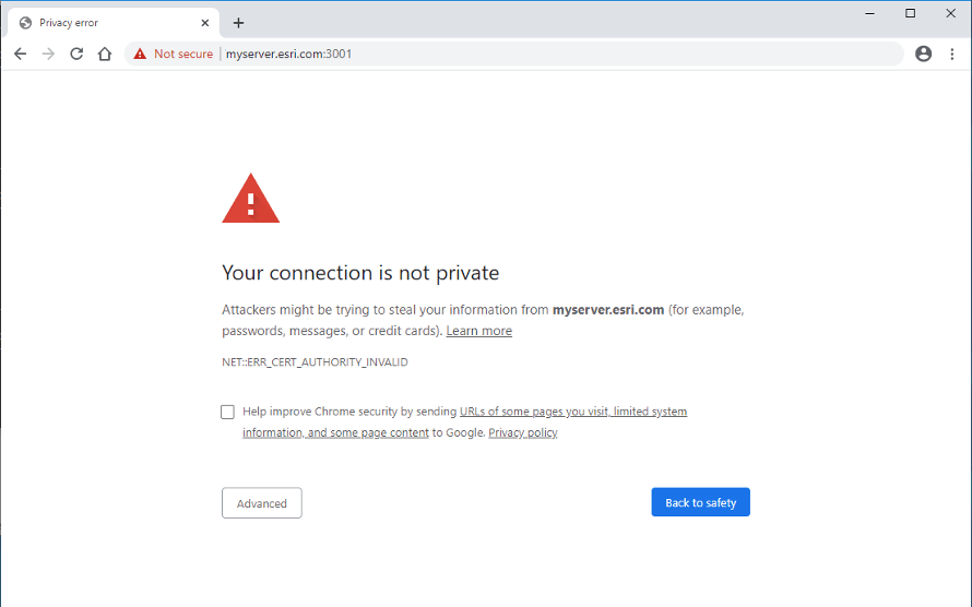

We delivered the initial release of the ArcGIS Experience Builder Developer Edition recently.  For those of you that have deployed it already you may have noticed the first time you browse to the site you’re presented with a message from your browser that looks something like this:
Warning message
First, let’s dig into why you’re seeing this warning message from your browser.  The browser is warning you because ArcGIS Experience Builder Developer Edition is using a self-signed certificate when communicating over https.  Many ArcGIS components create self-signed certificates during the initial installation process so they can communicate via https immediately after installation.  The easy thing to do is to make a browser exception, move on, and not think about it again.  This is not a security best practice, however, and in many environments can be a downright showstopper.  The ideal solution is to replace those self-signed certificates with signed certificates from a trusted certificate authority.  All ArcGIS components allow for this to ensure the highest level of security when communicating over https.  If you’re interested in more details about SSL here is a great overview provided by SSL Shopper.

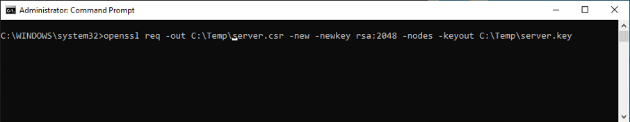

Step1: Generate a new private key and Certificate Signing Request
  • Open a command prompt as administrator and run the following command:
openssl req -out C:\Temp\server.csr -new -newkey rsa:2048 -nodes -keyout C:\Temp\server.key
Generate a new private key in command prompt

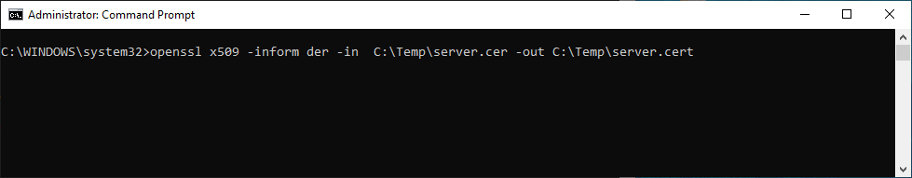

Step3: Convert the signed server certificate (if necessary)
  • It’s likely the signed server certificate will be returned to you in the form of a binary .cer file, and since we need it in a base 64 encoded .cert format we’ll need to run it through a conversion process using openssl. Please note that if you’re able to get the certificate returned from the certificate authority in a base 64 encoded format this step is not required.  Assuming it is, once again open a command prompt as administrator and run the following command:
openssl x509 -inform der -in  C:\Temp\server.cer -out C:\Temp\server.cert

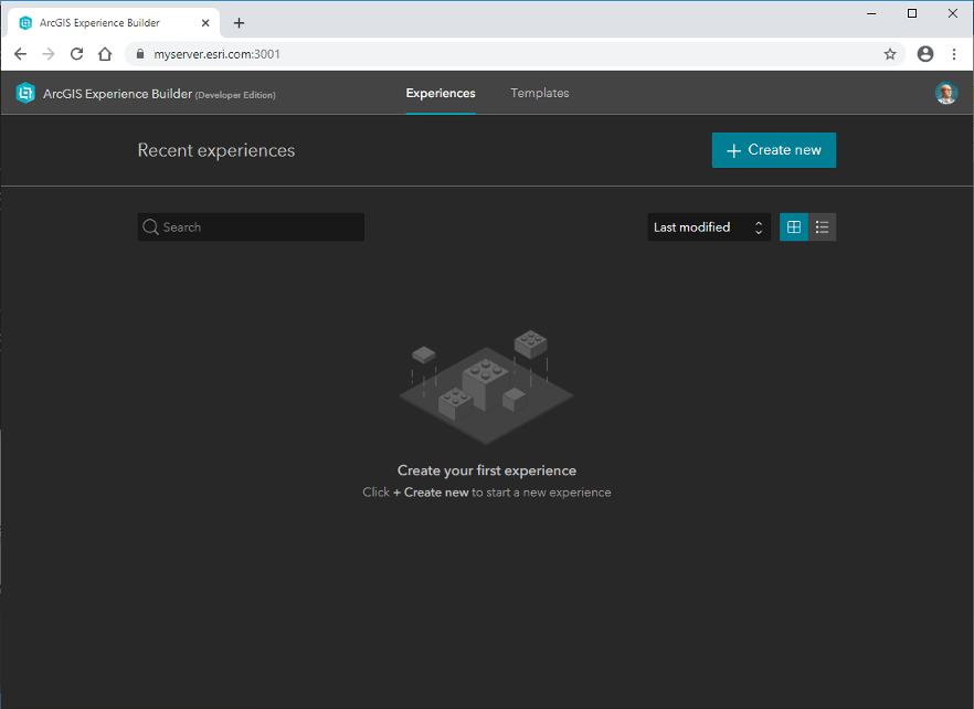

On the next startup ArcGIS Experience Builder Developer Edition will now be running with a signed server certificate, and the familiar lock can be seen in the address bar of your browser signifying you have a secure connection.
Secure connection
