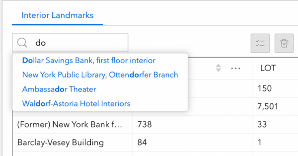

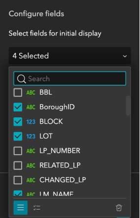

Table
A drag-and-drop component has been added to Table and other widgets when applicable. You can now easily reorder fields with drag-and-drop when you set the initial display of the table.
Reorder fields with drag-and-drop
All fields are turned on by default. You may turn off the fields you don’t want or the other way around—turn off all fields, then choose those you want.
Select display fields in Table
You can also get search suggestions when you search the fields.
Search suggestion in Table

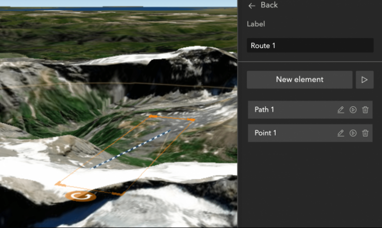

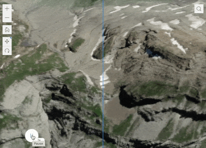

With the new Plan routes mode, you can preset routes with points and paths to fly through.
Fly planned routes

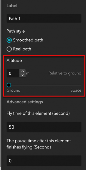

Specifically, you can mix multiple points and paths together in a route, define their flying order with drag-and-drop, and fine tune each of their properties, including Altitude, Fly time, and Pause time, etc.
Set a path for a planned route
For the path, it is important to adjust the altitude so you can see the outlook along the path. By default, it is zero to the ground.
Set fly altitude

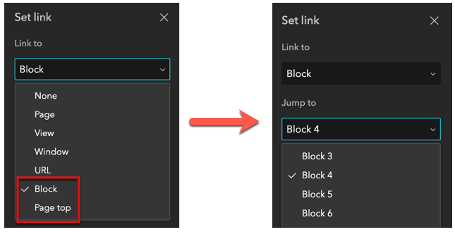

Link to anchor on scrolling pages
Sometimes a scrolling page is long, making it challenging to navigate the page. You can now set links on widgets to scroll to a particular block or return to the top of the page.
Link to a block
