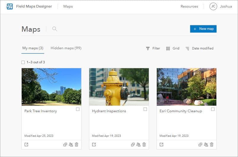

Step 1—Browse to https://www.arcgis.com/apps/fieldmaps and sign into your account.
The Maps page opens, displaying all the maps you own or have privileges to edit.
Step 2—Click the + New map button.

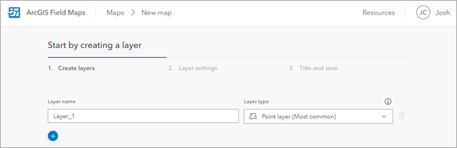

The New map page appears with on-screen instructions to help guide you through the map creation process. On the Create layers tab, you’ll define the layers used for data collection.
New map page
New map page
Step 3—Under Layer name, replace Layer_1 with Amenities.
Keep the default Point layer type so that when mobile workers collect park amenities, they appear as points on the map. To learn about the different layer types and when to use them, click the Information button next to Layer types.

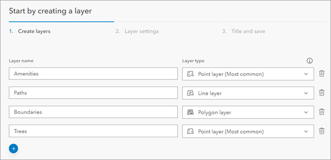

Step 4—Click the Add button three times to add three new layers.
Step 5—For these layers, enter the following information:
  • Layer name: Paths | Layer type: Line
  • Layer name: Boundaries | Layer type: Polygon
  • Layer name: Trees | Layer type: Point
Your map should have four layers in total, as shown below:
Create layers tab
Create layers tab
Step 6—Once you’ve added each layer, click Next.

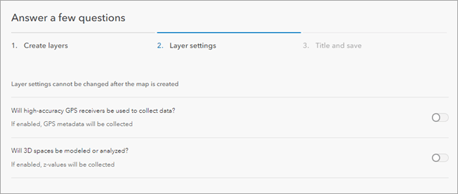

The Layer settings tab opens. Here, you’ll answer the following questions:
  1. Will high-accuracy receivers be used to collect data?
  2. Will 3D spaces be modeled or analyzed?
Neither are relevant for the map you’re creating, so you can leave each toggle button disabled.
Layer settings tab
Layer settings tab

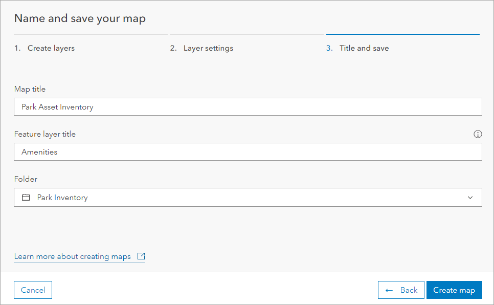

The Title and save tab opens.
Step 8—Give your map a title that mobile workers will recognize when opening the map in the field. For example: Park Asset Inventory
Step 9—Optionally, change the feature layer title.
The feature layer is the item in ArcGIS Online that contains all of the layers you added to the map. The default title is the layer name for the first layer you added.
Step 10—Click the Folder drop-down menu to select what folder to save the map in or to create a new folder. In this example, I’ll go ahead and create a new Park Inventory folder.
Once you’ve entered all the information, the Title and save tab should look like the following:
Title and save tab
Title and save tab
Review all the information you’ve provided, and when you’re ready…
Step 11—Click Create map.
