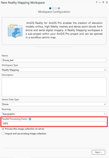

For ArcGIS Pro, you can set the PPF value on the workspace configuration page during workspace creation. When using ArcGIS API for python, you can set the PPF value through the context parameter of the appropriate reality mapping method.
PPF in ArcGIS Pro
Setting PPF in ArcGIS Pro

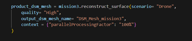

PPF for ArcGIS API for Python Reality Mapping reconstruct surface mission method
Generating a DSM Mesh using a PPF of 100

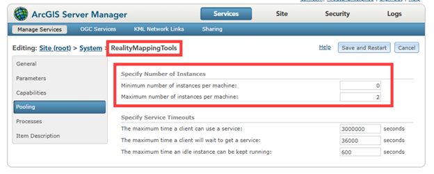

The support for running multiple concurrent jobs from different users is managed through the RealityMappingTools GP service’s instance configuration. To support more users processing simultaneously in your enterprise deployment, increase the maximum number of instances for the RealityMappingTools GP service:
  1.  Sign in to ArcGIS Server Manager as an administrator
  2. Navigate to the RealityMappingTools service
  3. On the Pooling page, set the maximum number of instances to match the number of concurrent users you expect
RealityMappingTools GP service's instance configuration
