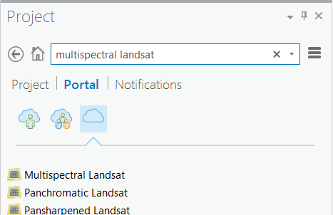

  1. Open the Projects Pane
  2. Click on Portal and then on the cloud icon on the far right to see everything that’s on your portal.
  3. Search for “Multispectral Landsat” in the search bar.
  4. Drag and drop.

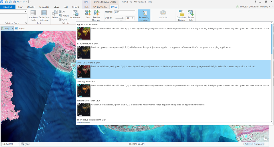

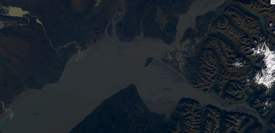

To take advantage of the archive, we’ve designed a number of pre-defined band combinations and indices. You can find these from the Data tab, under Processing Templates.
Play around with these. Here’s some cool stuff that I found poking around in Alaska for a few minutes.

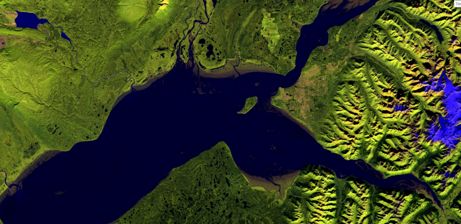

Above and below are images of Anchorage. You can see the cold, glacial melt rivers cutting through the sediment on the western side of the bay. The top image uses bands which can penetrate shallow water, revealing coastal bathymetric information. You also get a sense for why Anchorage is where it is. It’s not sitting on a sponge and the mountains to the east protect it to some degree from precipitation. The bright blue stuff below is ice.

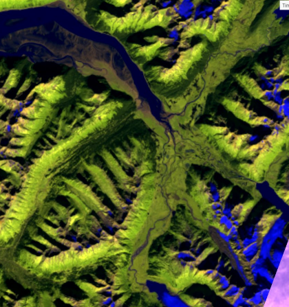

Not too far from Anchorage is the Portage Glacier which is at the lower-right of the image below.

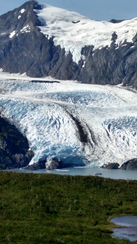

It’s hard to get a sense of scale when looking at glaciers from imagery. Here’s a photo I took of the same glacier with a pretty large ferry thrown in for scale. I’m guessing that what is in the photograph is showing maybe 15% of the glacier.

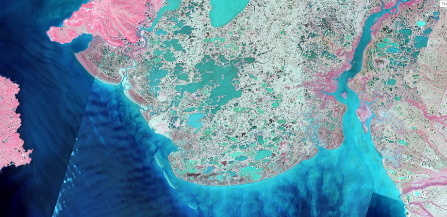

The image above is from far western Alaska with Nunivak Island at the far right of the image. I’ve never seen vegetation look pink in a false color image before. I have no idea why it looks this way. Feel free to take me to school in the comments.

  1. “Projects pane”? I’m using ArcGIS Pro 2.4.0… so far as I can tell, there is no such thing as a “Projects Pane”. If I select “Project” at the top of the ribbon, I get something that looks a lot like the screen you get if you select “File” in the top of a current MS Office program’s ribbon, but nothing at all like the screenshot in this article. There is a “Portals” option in there, but if I select it there’s no “Cloud” option, just an entry for my institutional ESRI login, and an “Add Portal” button that takes me to an “Enter URL” box. And, of course, I have no idea what portal URL would correspond with the “Cloud” option in this article’s screenshot, or with the Landsat archive hosted on Amazon.
    • Hi Patrick. The Projects Pane was renamed to the Catalog Pane some time ago. At 2.0 I believe. At the time of this article, we were still on version 1.x. Current build is 2.6.3 at the time of this comment. Be sure to download the most recent version to take advantage of the newest features and functionality.
      The Multispectral Landsat data mentioned here can now be found in the Living Atlas of the World (https://livingatlas.arcgis.com/en/home/) as opposed to the ArcGIS Online cloud icon referred to in step 2. You may access it through ArcGIS Pro in a similar fashion. Instead of clicking the ArcGIS Online cloud icon in the Portal tab of the Catalog Pane, click the Living Atlas icon (cloud icon with a book), and search for multispectral landsat. Also, check out this document for the most up-to-date information on how to access Landsat 8 data hosted on AWS (https://docs.opendata.aws/landsat-pds/readme.html).
      Lastly, here’s a link to our most recent imagery and remote sensing training available through our Learn ArcGIS Hub (https://learn-arcgis-learngis.hub.arcgis.com/pages/imagery-and-remote-sensing). Hope this helps!
