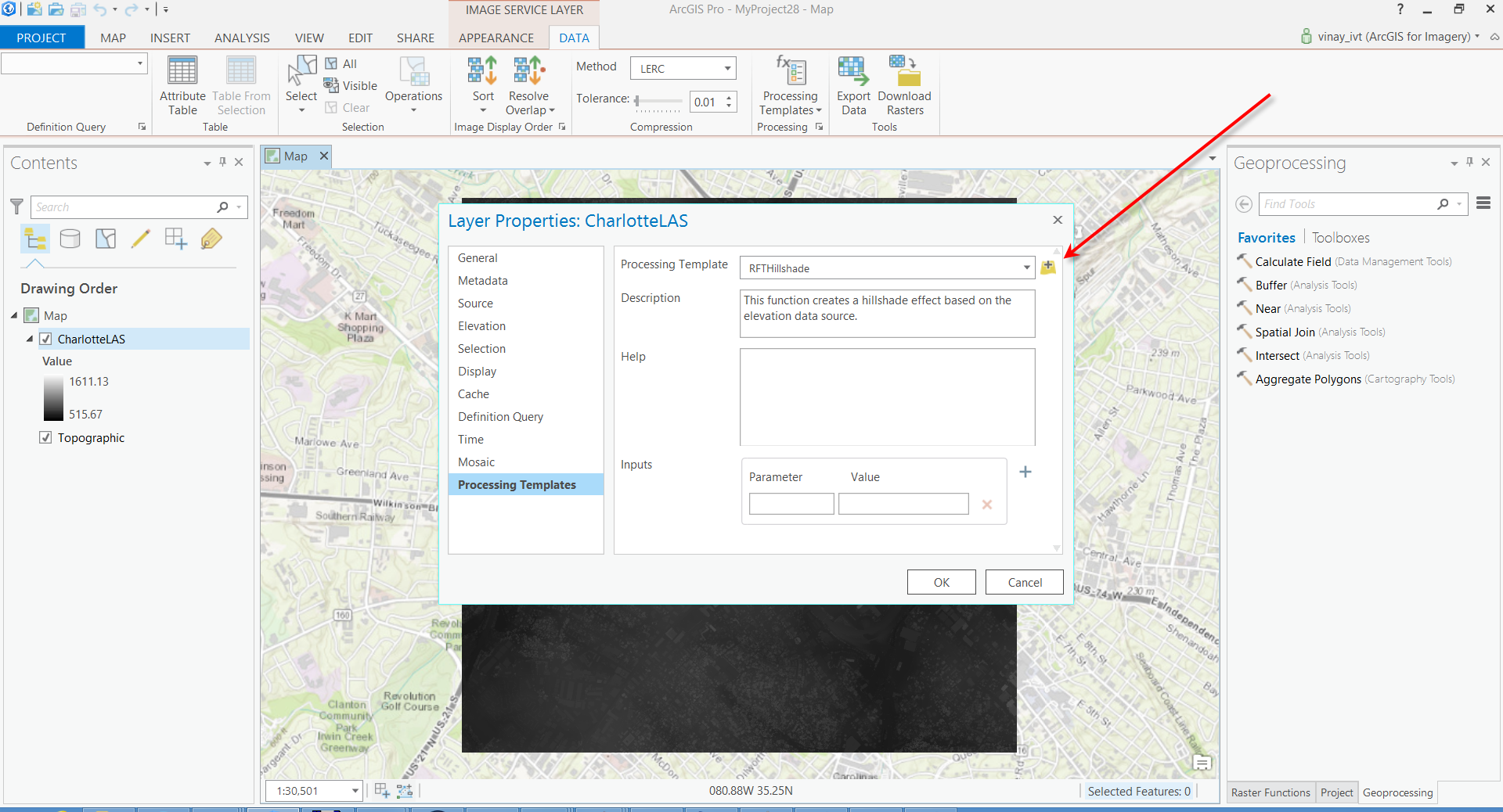

From the Data tab, click on the Processing Templates launch button. (It’s the little icon in the lower-right corner of the button.)
processing templates icon
Then, hit the add button next to the Processing Templates input.
processing templates ui
In the window that appears, find the function chain that you want to use. When you select it, it will then appear on the Processing Templates button under the Custom section.
