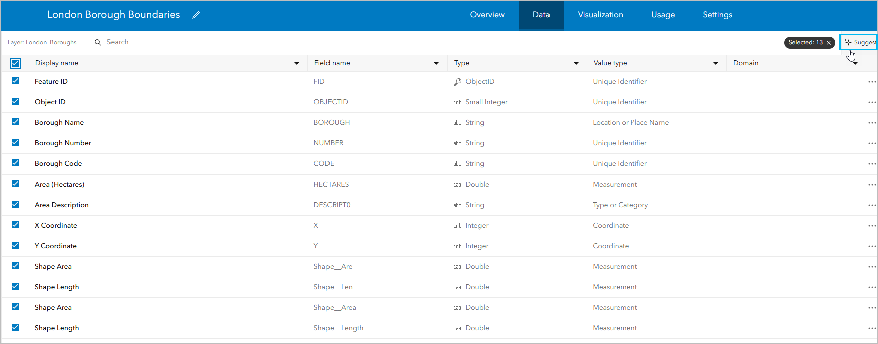

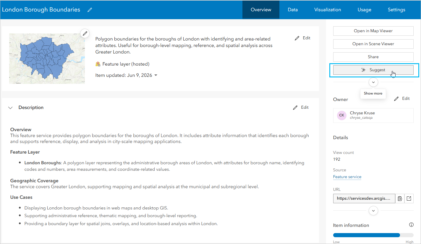

Let’s take a closer look at preparing your data to ensure the best experience of the app. You should start with feature layers, which are currently the only supported layer type for agents in ArcGIS. Layers should have thorough metadata with meaningful names to help the agents understand their purpose. Fields should also have descriptive aliases and field descriptions to provide additional context about the data.
Both requirements can be completed using the Item details assistant (beta), which can generate field and layer descriptions for you, saving time. On the item details page, click Suggest to use the Item details assistant (beta).
London Borough Boundaries item details page
Suggest button in the fields of the Data tab

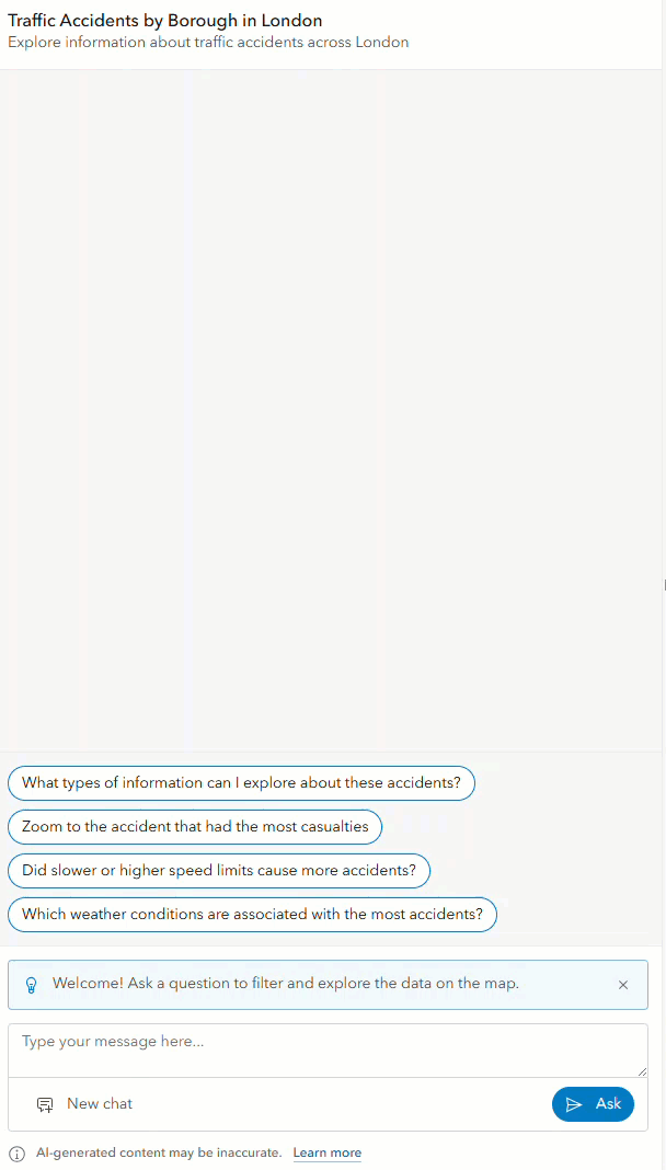

On the Data Explorer tab, you can also customize the chat experience by adding a header, description, welcome message, and sample questions to help users get started.

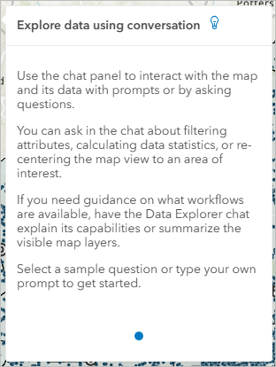

Additionally, upon launching a published app, a help panel is provided to guide app users on how to use the chat. While this text isn’t currently configurable, it can be turned off by the app author in the configuration.
Preloaded app guide message

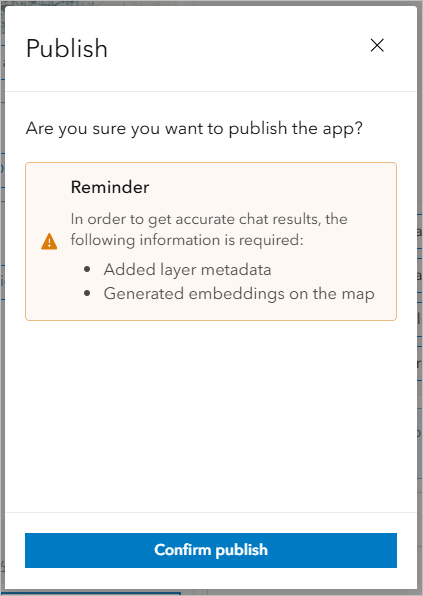

When you publish the app, a message appears to confirm you have thorough metadata and have generated embeddings:
A message to confirm you have thorough metadata and have generated embeddings

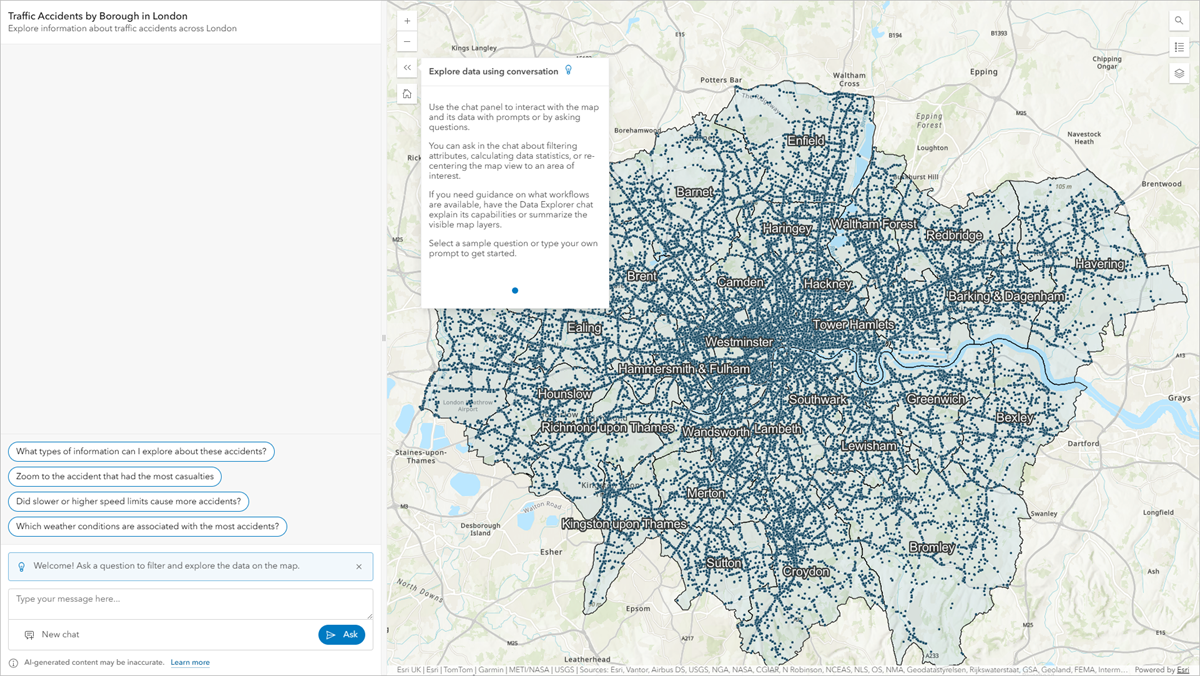

Let’s walk through one example of how Data Explorer (beta) can be used. For example, you may have an app showing car accidents in London. The dataset is large, and finding information about how many crashes occurred, under what conditions, or in which areas can take a lot of manual effort.
Data Explorer app of traffic accidents in London
This is where Data Explorer (beta) lets you utilize the chat to pull out insights without needing to manually filter or analyze the data.
You can start by using a sample question provided by the app author in the configuration or type your own. If you’re not sure where to begin, you can even ask the chat for guidance. The chat provides high-level options of ways you can explore the data and the map.
Chat responding to provided prompts

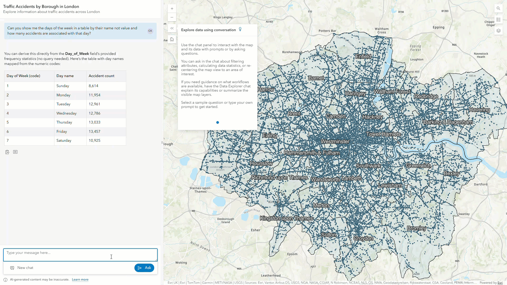

Behind the scenes, the help, navigation, and data exploration agents work together to answer questions, navigate the map, and guide the overall experience. You can ask a wide range of questions depending on what you want to explore. For example, you might ask about patterns in the data:
  • Which areas have the most accidents?
  • What time of day crashes are most common?
  • How does accident severity vary across different road types?
You can also dig into road conditions—like showing accidents that occurred in poor weather, low light, or at junctions—or compare quantities like vehicle counts and casualty counts.
If you’re looking for something more specific, you can filter the map by asking for accidents that meet certain criteria, like those involving multiple vehicles or on weekends. In addition to exploring the data, you can also navigate the map by searching for a location or asking to zoom to areas with high activity. Alternatively, ask for help understanding what kinds of questions you can ask about navigating the app.
