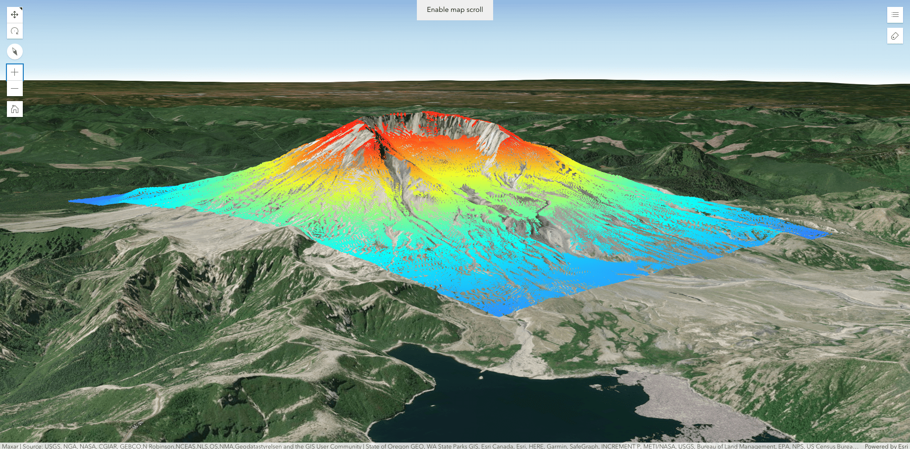

In this Basic app, a web scene of the elevation of Mt. St. Helens after its 1980 eruption is displayed. For the purpose of this app, there are minimal tools needed for data exploration so only the legend, slides, and the disable scroll option were added.
  • The legend can help to decipher the symbols that show different elevation in the scene.
  • The slides can be used to quickly navigate to areas of interest in the scene.
  • The disable scroll tool can be helpful if this app were to be embedded in another site.

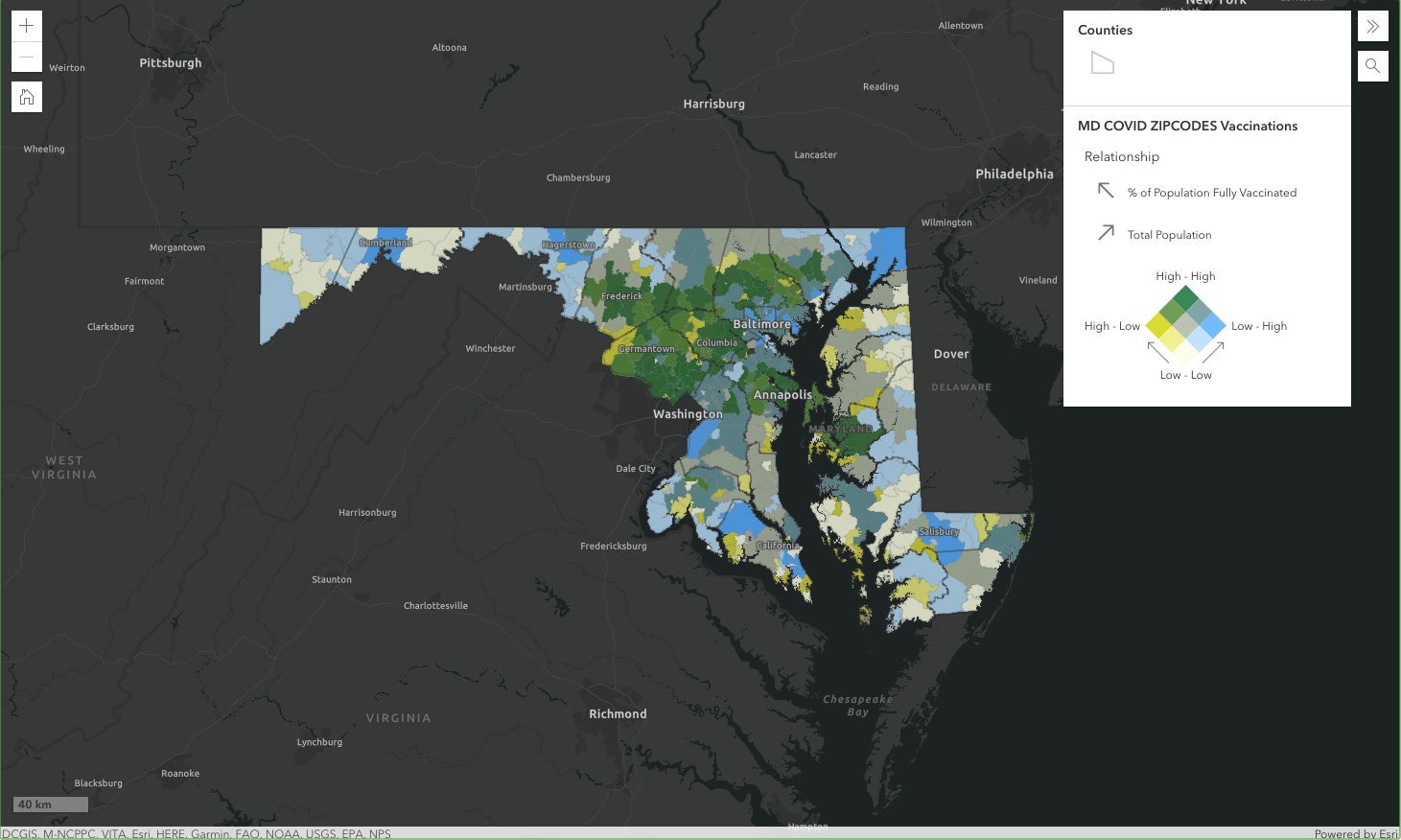

In this Basic app, a web map of Covid-19 trends in Maryland is displayed. This app also includes the legend tool, along with the search tool and the scalebar. To make sure that the app stays focused on Maryland, the navigation boundary has also been configured.
  • The search tool can find locations on the map based on specified search parameters.
  • The scalebar provides a visual indicator of the distances between features on the map.
  • The navigation boundary is used to set an extent that cannot be panned or zoomed out of.
