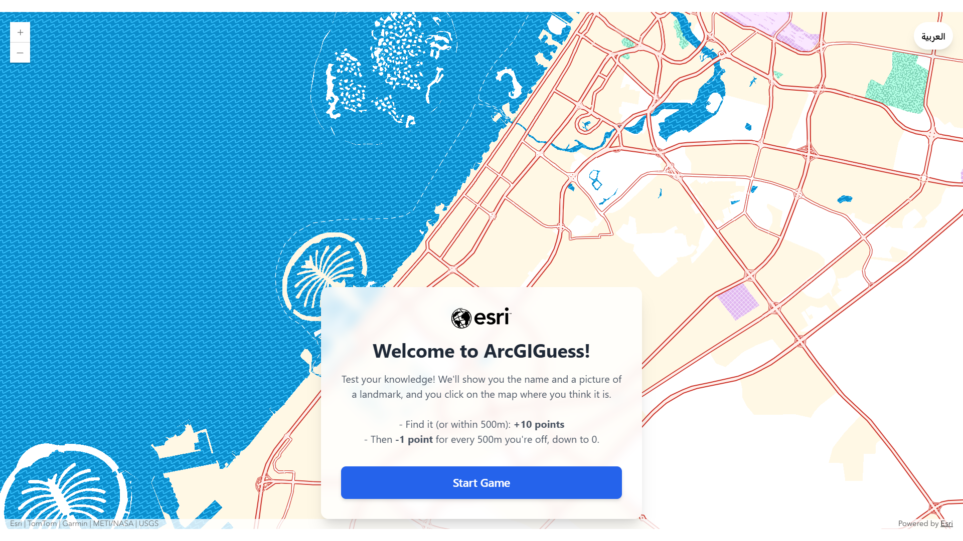

Looking for a fun, interactive way to showcase your spatial data, highlight local landmarks, or engage your audience? Meet ArcGIGuess: a lightweight, browser-based guessing game built with ArcGIS Maps SDK for JavaScript (v5.1).
Players are presented with a landmark name and photo and then challenged to pin its location on a web map. Using client-side geometry operators, the app calculates proximity which determines award points, culminating in a live leaderboard powered by ArcGIS Survey123.

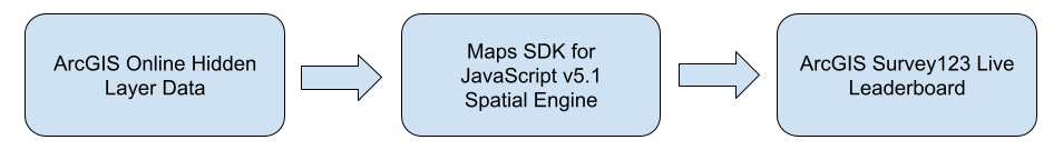

Rather than relying on complex server infrastructure or custom backend services, ArcGIGuess coordinates core ArcGIS tools into a client-side experience:

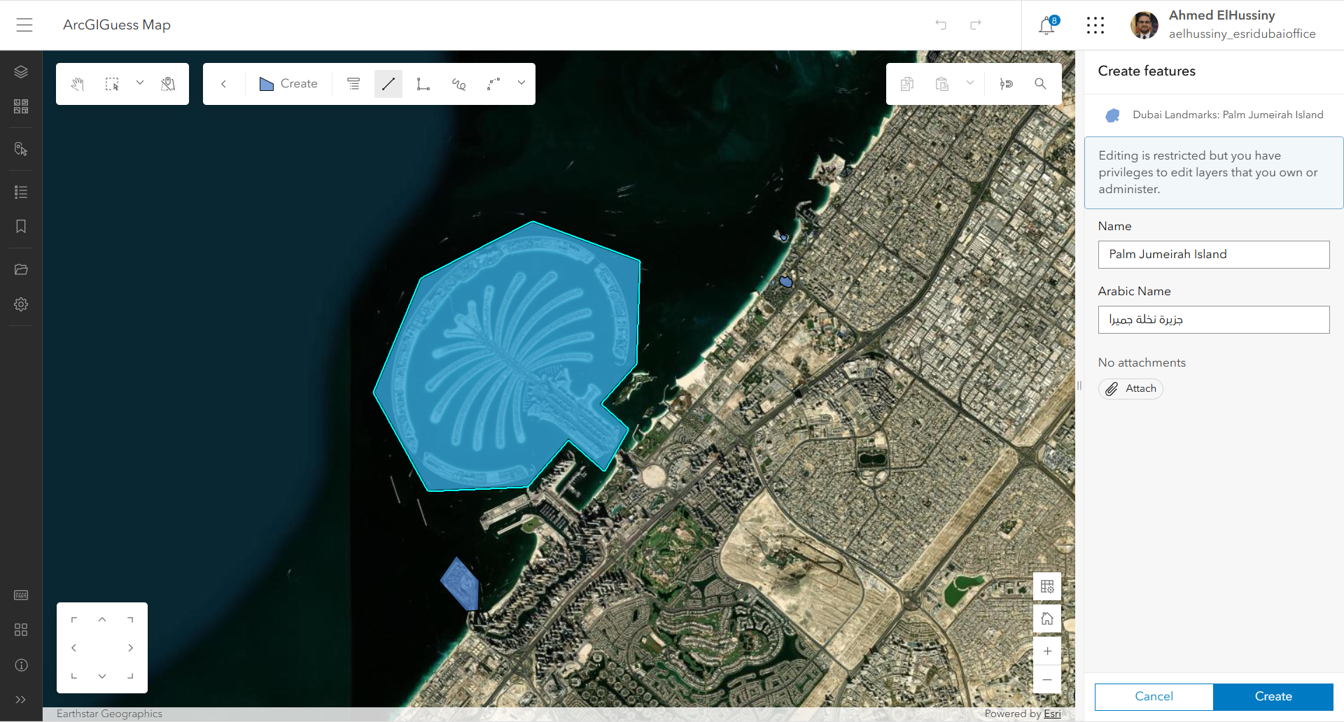

The backbone of the game is a hosted feature layer containing your landmark locations. Instead of point features, ArcGIGuess uses polygon footprints (such as stadium outlines, park borders, or airport boundaries). Polygons give players a fair target area to hit rather than requiring them to identify a single point coordinate.
Each feature stores landmark names—including localized fields for multilanguage games—and photo attachments uploaded from the web editor.

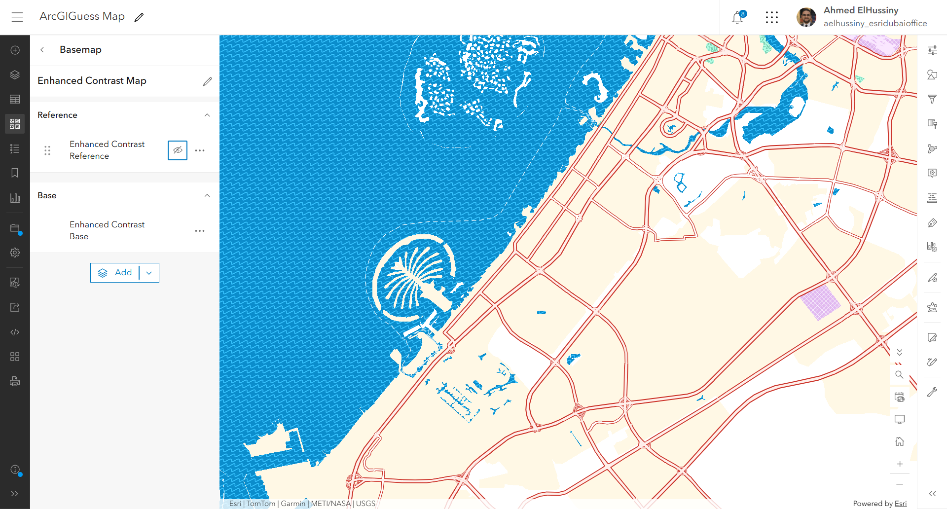

  1. Add the feature layer to a web map in Map Viewer.
  2. Choose a clean, high-impact basemap, such as Enhanced Contrast.
  3. Turn off reference labels so street names can’t be used as clues.
  4. Turn off layer visibility. The JavaScript SDK can still query hidden layers for geometries and image attachments in the background while keeping the answers invisible on screen.
Digitizing landmark footprints and uploading image attachments in the web editor

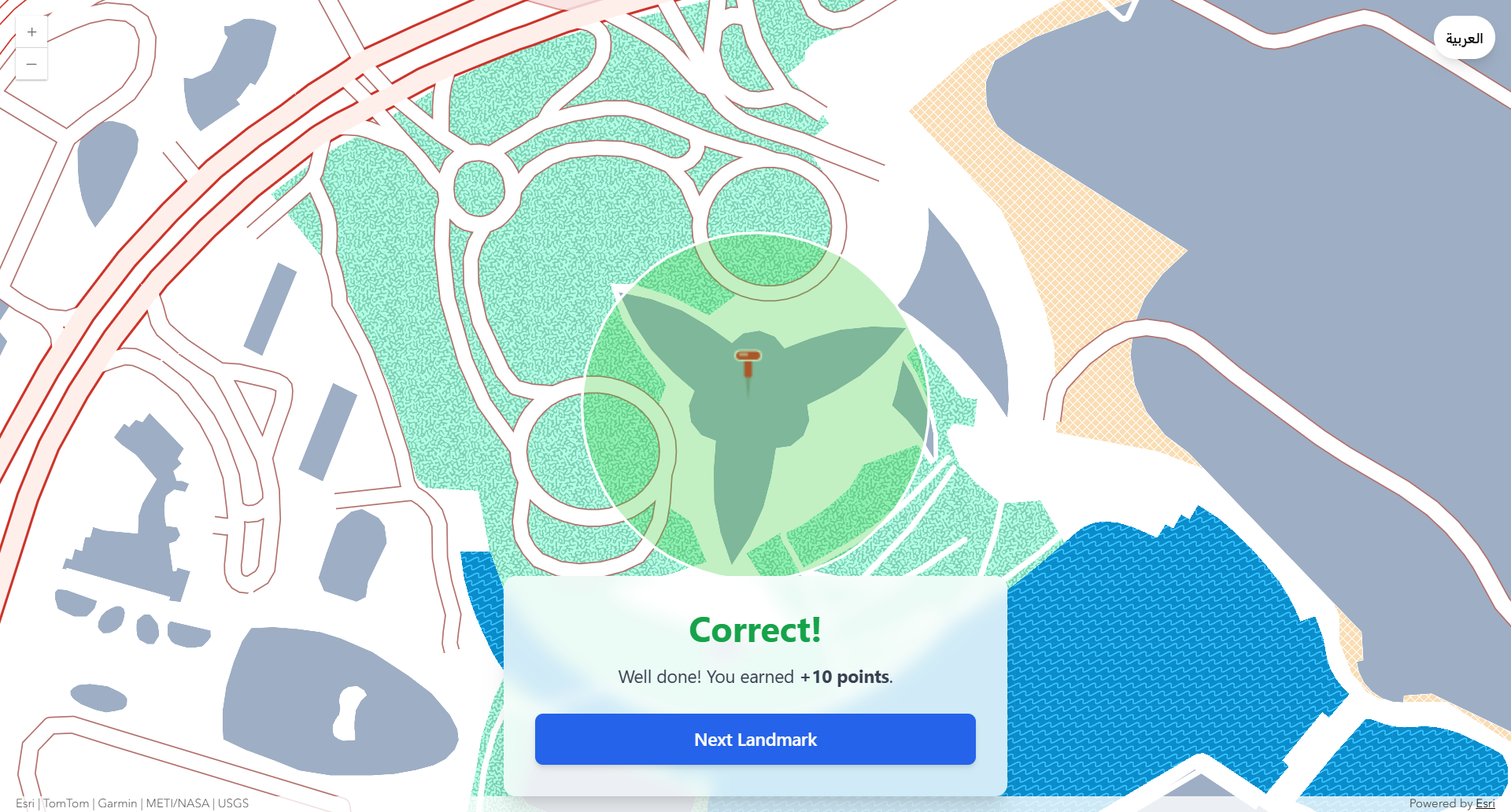

When a player clicks to guess a landmark’s location, ArcGIGuess evaluates the click geometry directly inside the user’s browser for instant feedback:
  • Direct hits—containsOperator checks if the clicked point sits within the hidden polygon boundary, instantly awarding maximum points.
  • Proximity calculation—If the guess falls outside the boundary, distanceOperator calculates the exact distance in meters between the point and the nearest edge of the polygon footprint.
Points are then deducted based on configurable distance bands (for example, deducting 1 point for every 500 meters off-target), down to a minimum score floor.
Revealing the landmark polygon geometry on the map after a guess is confirmed

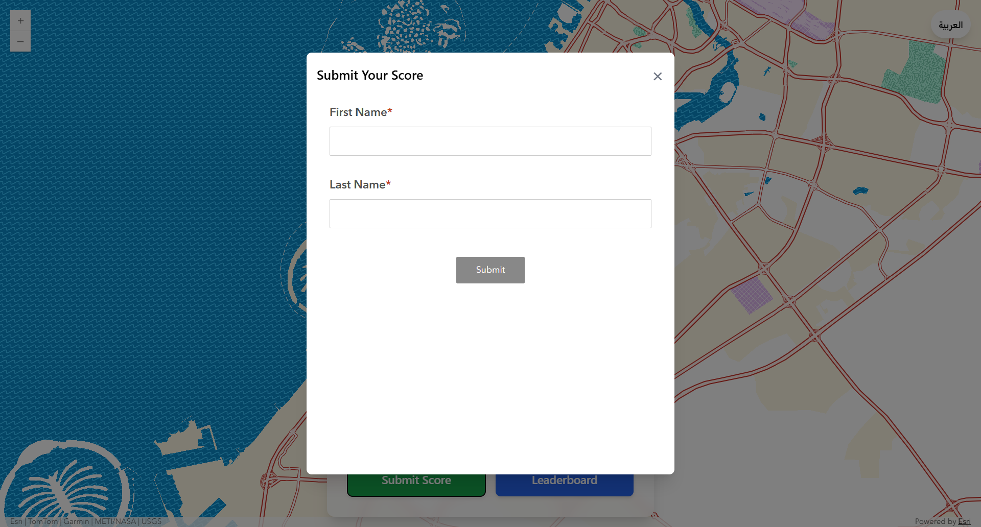

To record high scores without building a custom database or API, ArcGIGuess integrates with ArcGIS Survey123.
When a round ends, an iframe modal opens the survey with URL parameters that pass the player’s final score directly (?field:score=100). Additional parameters hide unnecessary elements like headers, footers, and score input fields (&hide=navbar,header,description,footer,field:score). Players type their name, click Submit, and the game queries a public feature server view to update the Top 10 Leaderboard instantly.
The embedded Survey123 form modal, streamlined with URL parameters so players only enter their name
