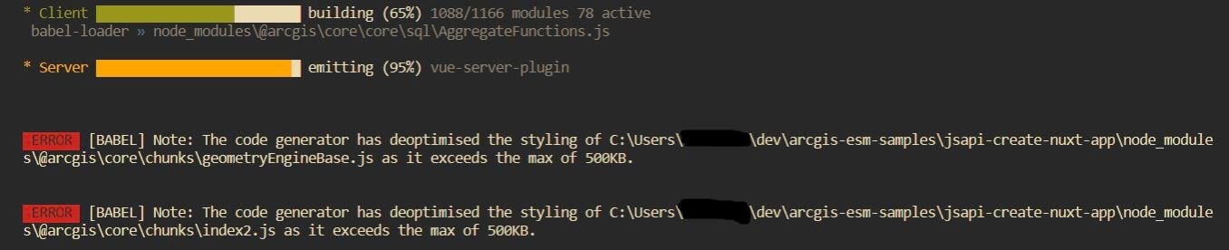

NuxtJS has a built in method for transpiling dependencies, documented here. Transpiling @arcgis/core will take several minutes on the first build, so have patience! You will also see a few errors (below) concerning file size.
ESM Babel Transpile Error
Once @arcgis/core is transpiled, you will be able to import the ES modules. That should solve the issue if your application does not render a map. I included an example of a no-map solution using module transpilation in the NuxtJS sample.
