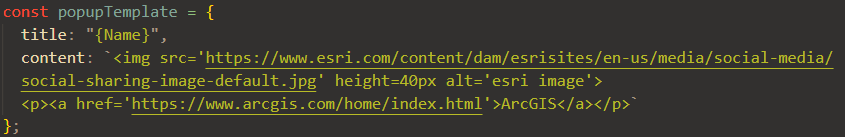

The HTML sanitizer used by the ArcGIS Maps SDK for JavaScript allows common HTML elements, while removing potentially harmful code. For example, let’s say you define your Popup Template as:
approved HTML popup
This code clearly contains HTML: there are paragraph, link, and image elements. However, the popup will work because there is nothing potentially dangerous that could run malicious code. Check out this page for a list of supported HTML tags. All of the elements on that list are not sanitized, as well as some additional elements supported after the v4.15 release.

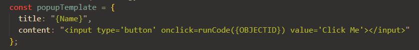

The next code snippet contains a button with an onclick function:
sanitized HTML button in popup
This code will be sanitized because it can be potentially harmful, depending on the function.

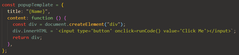

The work-around is to use a function to directly modify the DOM node of the popup, which bypasses the HTML sanitizer. Therefore, in order to add a button to your popup, you can define the Popup Template as:

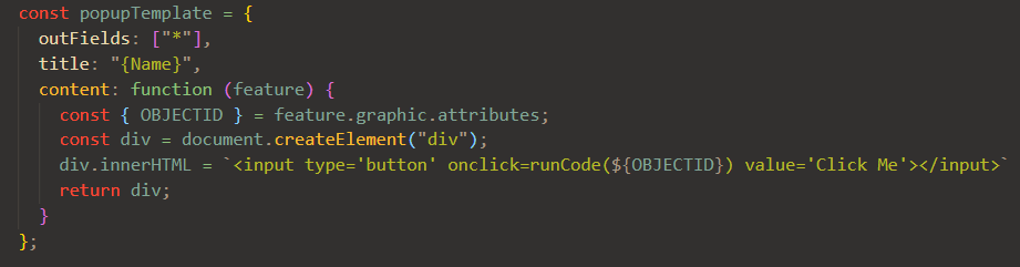

The above code will work for most people. Some of you may have noticed a slight change between the two previous code snippets. The Popup Template that modifies the DOM node of the popup does not contain any Arcade expressions. Here is a sample that demonstrates how to access feature attributes as well as use HTML in your popup, and here is the snippet:
HTML button and feature attributes in popup
