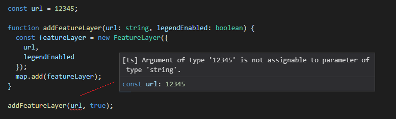

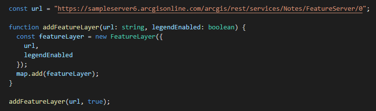

With TypeScript, you have the option to add type support to your code. This allows you to specify the type of value a variable can hold. Adding types to your code makes it easier to maintain and easier to read. In the code snippet below, the function accepts two parameters. The first must be of type string, and the second must be of type boolean.
2. Enhanced IDE support
While there are several IDEs that can be configured to work with TypeScript, we use Visual Studio Code for our code examples in this blog. In the example above, we passed the appropriate types to the function. However, if we did not pass the appropriate types to the function, our IDE would give us a compile-time error indicating that an invalid type was passed to the function (we tried to pass off an integer for a string). This typed environment also allows IDEs to perform refactoring and other productivity operations.

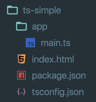

First, you will need to install node and npm on your machine. Once you have done that you will want to set up a basic folder that may look something like this.
This folder structure represents the minimum to get started writing a TypeScript application. The second step is to install the the ArcGIS API for JavaScript Typings by running the following commands in the root of your application:

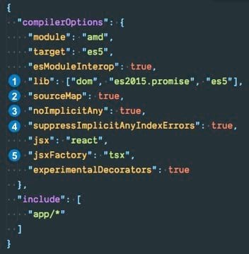

This is the bare minimum configuration you would need to compile TypeScript for use with the ArcGIS API for JavaScript. In this configuration we are doing a few things.
- Telling the compiler to output the JavaScript as AMD modules, that can be consumed by the ArcGIS API for JavaScript.
- We want the output JavaScript to es5 for optimal browser compatibility.
- Turn on esModuleInterop so that you can write your import statements for modules in the JavaScript API as
import WebMap from “esri/WebMap”instead ofimport WebMap = require(“esri/WebMap”). - Finally, you want to tell the compiler where your TypeScript files are located.
If you wanted to use more advanced features, you could update your configuration.
This configuration is more typical of what you would use for an application.
- List of library files to include your compiled code. This is useful if you want to use features like Promise or Geolocation.
- Source maps are useful during debugging, so that you can debug the source TypeScript files instead of the compiled JavaScript.
- The any type is useful when you do not know the type for a variable or when working with dynamic content. This tells the compiler, they are allowed, but you must declare them.
- This goes hand in hand with the next option, which will allow to index objects that have not been explicitly typed.
- These final options for JSX and decorators are used when you build custom widgets with the JavaScript API.

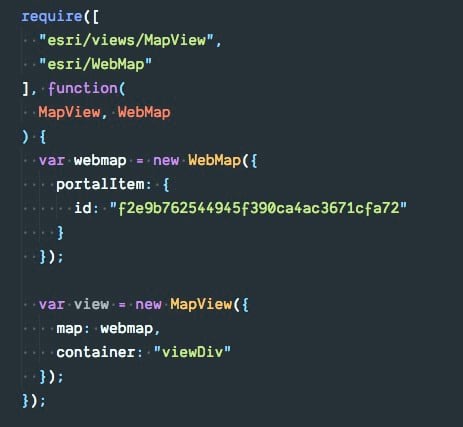

Here is a small sample of a basic application written in JavaScript using the ArcGIS API for JavaScript. This may be familiar to many of you already building apps with the API. We use a require function to load modules of the API as needed.

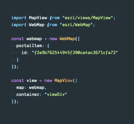

Below is a sample of the same code above, but in TypeScript.
The main difference in this code snippet is that instead of using the require method to load modules as needed, we can now use the import statement to load modules. The other difference is that we now use the const keyword instead of the var keyword. You could also use the let keyword here. The main difference is that const must be initialized with a value and you cannot change that value, whereas let does not need to be initialized with a value and you can change its value.
