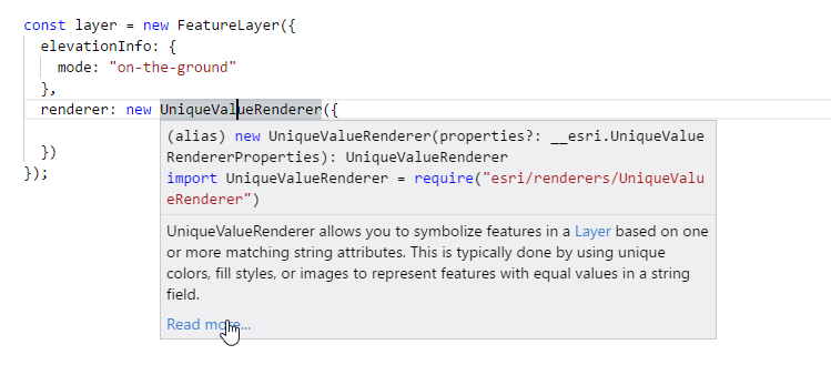

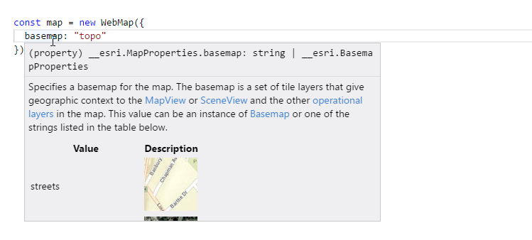

  • Added JSDoc definitions for classes, methods and properties: Classes and their members are now decorated with JSDoc comments. An integrated development environment (IDE) like Visual Studio Code, now shows an overview of the documentation while you type your code or when you hover a class, property or a method.
  • typings on property
    The documentation also includes a link to directly open the API reference at the relevant page.
    read more
