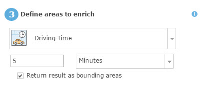

Points
Scenario: You have point data for hospitals in your area. You need to know how many low-income households are within a 5-minute drive for each of these hospitals.
For this scenario, Drive time >> 5 minutes >> Choose “Return result as bounding area”

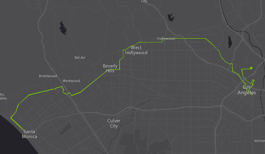

Lines
Scenario: You have linear data for the LA Marathon route. You need to know how many retail businesses are within a mile of that route so that you can assess the impact of this event.

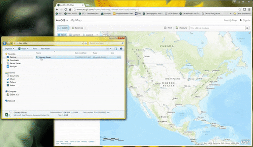

Excel/CSV
Scenario: You have a table of possible locations for a new grocery store. You need to know information about the income of the people living near these addresses so that you can select an ideal location.
Tip: you can also do this in Maps for Office and share your layer to ArcGIS Online
