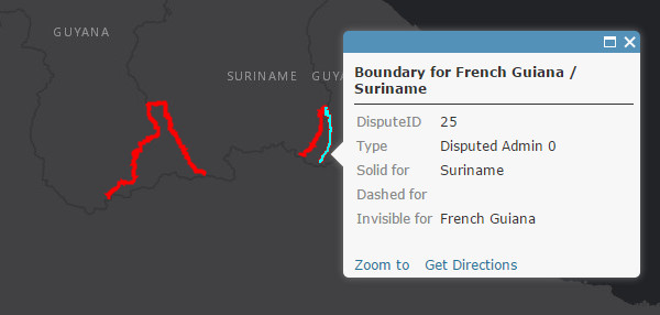

In this example, the World Topographic Map tile layer was updated by changing the “filter” used for a couple types of administrative boundary layers to show the boundaries as they are recognized by the country of Suriname (though not by most other nations):
- “Disputed admin0” layers: changed the filter to be “filter” : [“!in”, “DisputeID”, 80, 23, 24, 25, 26, 0],
- this filter excludes (i.e filter ‘not in’) the disputed boundaries of 23, 24, 25, 26 in this “Disputed admin0” (country-level) layer
- “Boundary line/Admin0” layers: changed the filter to be “filter” : [“any”, [“==”, “_symbol”, 0], [“in”, “DisputeID”, 24, 25]],
- this filter includes (i.e. filer ‘in’) the Suriname recognized boundaries of 24, 25 in this “Boundary line/Admin0” layer
In this case, because these layers appear two times in the Topographic map style for different zoom levels, the changes were made to two layers. These layers were found by searching for the “id” of the layers shown above (i.e., “Disputed admin0” and “Boundary line/Admin0”). The same changes could be applied to all of the available map styles that include boundary layers since they reference the same set of vector tiles.
The source Esri Community Map data used to build the vector tiles has disputed boundaries defined for many areas around the world. View this web map, complete with bookmarks for different regions, that show the set of disputed boundaries currently available in the Esri vector basemaps. If you click on a specific boundary feature, you will see a popup with important information on the “DisputeID” (needed to update the “filter” as described above) along with hints on how the boundary might be displayed for a different country perspective.
In the Esri vector basemaps, internationally recognized national boundaries (e.g. United States / Canada border) are typically represented with different types of “solid” lines while disputed boundaries (e.g. parts of French Guiana / Suriname border) are typically represented with “dashed” lines. In some cases, a country will want to not render (i.e. make invisible) a disputed boundary that it does not recognize.
