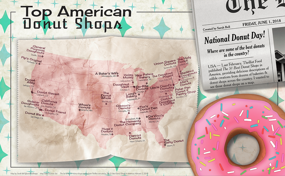

Graphic designers (and mappers who are into graphic design), this post is for you! I’m going to share the basic steps for getting a spatially accurate map with real map information into your graphic design project by showing how I started this map for this 1950s donut shop illustration. I used a KML file and Maps for Adobe Creative Cloud (M4CC), Esri’s mapping extension for Illustrator and Photoshop. If you want to learn more about the graphic design techniques, I’ve posted that here.

Without further ado, here is how I used M4CC to map a list of donut shops that Thrillist compiled back in February.
The 4 Steps to make this map

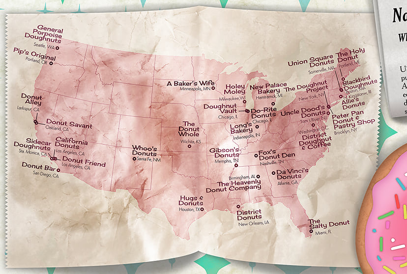

I made the KML file for my donut map based on this list of top donut shops by Thrillist. You can find the lat long coordinates of your own custom places using this site. Hey, that reminds me! Remember how I said that maps can stir emotions? This simple map of 31 donut shops is no exception. My personal favorite donut shop is not on Thrillist’s list, and maybe yours isn’t either. Of course I think my favorite donut shop should be on this list! But maybe your favorite shop is included on this list. Then the map probably makes you pretty happy, and maybe even a little proud. Regardless, a map about donuts makes a lot of us want to eat a donut, and that alone is indicative of the power of maps. But let’s be honest: inspiring a donut craving isn’t that hard to do.

- USA Contiguous Albers Equal Area Conic. This is a great projection for the mapping the entire lower 48 states in USA, and the one that I used for my donut map.

This brings up the labeling dialog, where you can choose which category to use to name your data. I had a tag for the shop name called “Name” in my KML file, and used that to label the donut shop locations. (Hint: using a small label size will help prevent the labels crowding out one another and getting bumped off the map. You can always increase the labels’ size in Illustrator after download.)

Getting accustomed to new software takes time, and mapping software is no exception. If this is your first time trying the M4CC extension, I recommend starting out with those useful links I mentioned earlier in this post. They have a lot of tutorials, videos, and blog posts that get you started with this extension. If you want to learn more about all the graphic illustrations and details that I made for this 1950s diner graphic design theme (did you notice that faint grease stain on the bakery tissue?) check out this post where I share some of those nifty design tricks.
