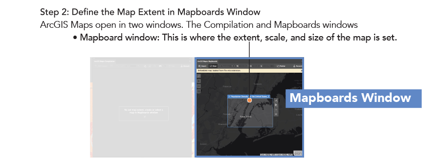

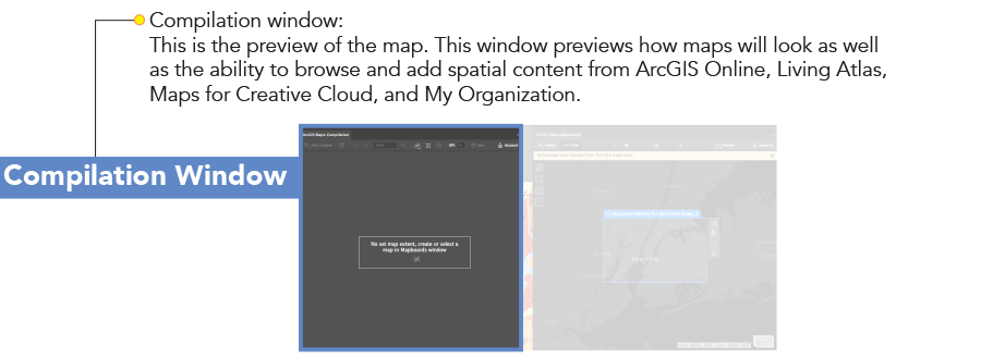

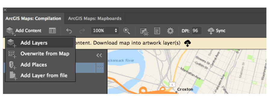

Step 3: With the Map extent selected Add Spatial Content in the Compilation Window
  • Compilation window > Add Content > Add Layers

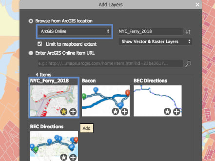

Step 5: Add NYC Ferry routes
  • Browse from ArcGIS location > ArcGIS Online > NYC_Ferry_2018

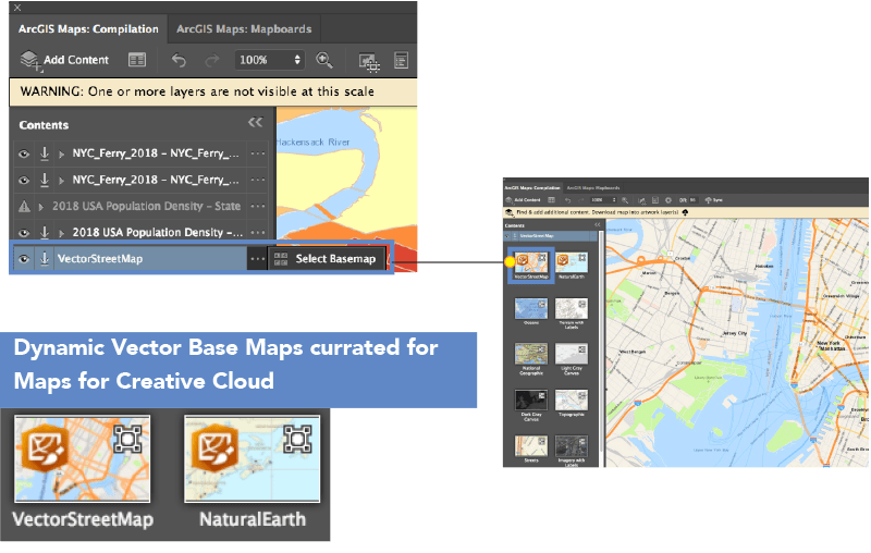

Step 6: Select a basemap
  • Select Basemap > VectorStreetMap

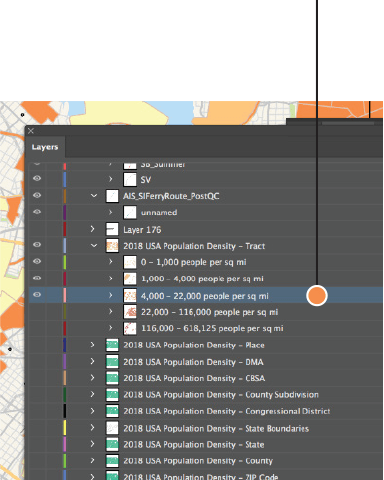

Based on your storyboard, determine the layers slated for animation.
  • In this example, we will randomly fade in the individual population data, starting with the
    “4,000 – 22,000 people per sq mi” layer.

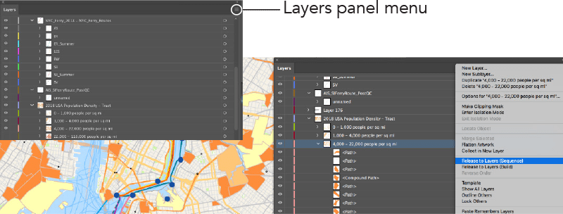

How to make Animated Maps in ArcGIS Maps for Adobe and Adobe After Effects
Choose “Release To Layers (Sequence)” from the Layers panel menu to release each item to a new layer.
With the “4,000 – 22,000 people per sq mi” layer selected, choose “Release To Layers (Sequence)” to break out the elements into individual layers. This will allow for each element to be imported into After Effects as an individual layer.

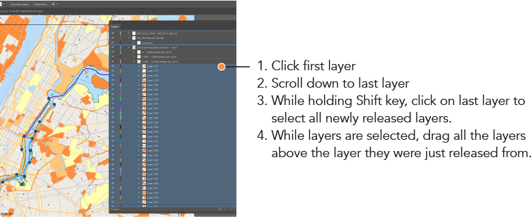

Step 2:
Select all the new layers and move them all above the layer they were just released from

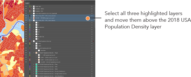

Step 3:
Now we will move the layer order for the following three layers:
1. 22,000-116,000 people per sq mi
2. NYC_Ferry_2018 – NYC_Ferry_Stations
3. NYC_Ferry_2018 – NYC_Ferry_Routes
  • Select all three layers and move them above the 2018 USA Population Density layer
  • Hold down the Shift key, select all three layers, and drag layers up

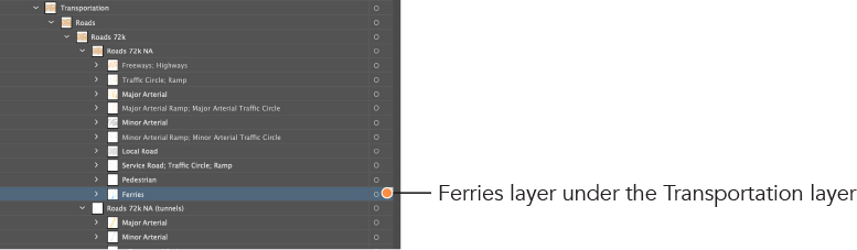

Step 4: The last layer to be moved is the Ferries layer from the basemap.
  • Select the Ferries layers under the Transportation layer
  • Click and drag it above the 2018 USA Population Density layer

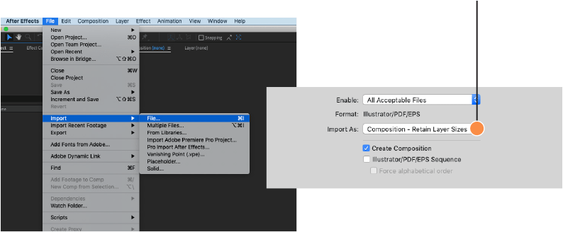

STEP 1:
  1. Under: File > Import > File
  2. Select your Illustrator file and Import As > Composition- Retain Layer

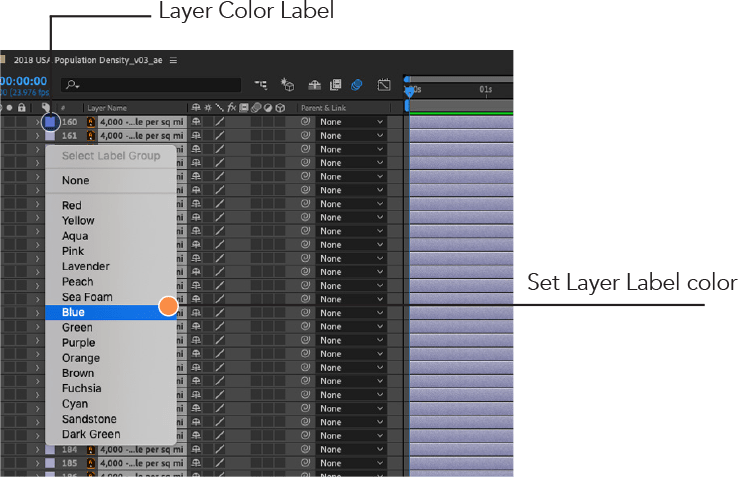

Changing layer label color
STEP 2:
  1. Select all 4,000 – 22,000 layers, by cliking on the first layer (4,000 – 22,000 Start) > holding shift> clinking on the last layer (4,000 – 22,000 Start End).
  2. With all 4,000 – 22,000 layers selected > click on the layer Label color and change all layers colors to blue
  3. While still selected move all the layers up in the timeline by holding command + ]

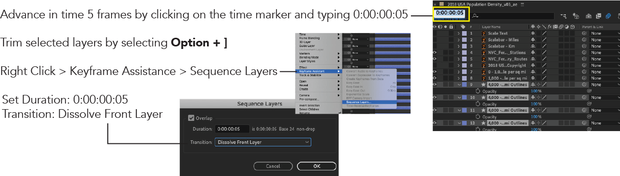

Sequencing the Layers
STEP 3:
The following steps will cover sequencing of the layers.

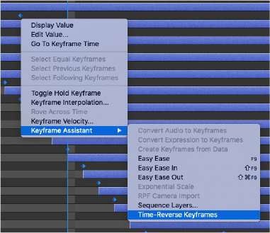

Time-Reverse Keyframes
Since we want to reveal the layers and extend the duration on screen, we will have to select all the opacity key frames and Time-Reverse the Keyframes.
STEP 4:
  • Hit (T) on the Keyboard to bring up all Opacity Key frames in selected sequenced layers
  • With the selection tool, select all the opacity key frames by clicking + dragging a marquee over all the opacity keyframes.
  • Right CLick > Time-Reverse Keyframes
Step 5:
  • With all Layers selected:
  • Hit (end) key on keyboard or manually move time indicator to the last frame in the time line:
  • Hit: Option + ]
  • This shifts the layers outpoint to the current time

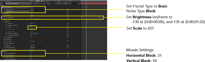

  • 1: Go to Composition > New Composition and name the New Composition “Noise Build-On”
  • 2: Create a new Solid: Layer > New > Solid
  • 3: Set color to Black and name the solid: Checkered Transition
  • 4: Apply Effects:
A. Select Effect > Noise and Grain > Turbulent Noise
B. Effect > Stylize > Mosaic
C. Apply the following setting and Keyframes

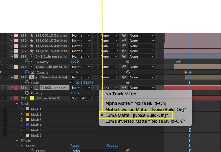

Place the Noise Build-On comp directly above
“22,000 – 116,000 people per sq mi” Layer.
Set the Track Matte to “Luma Matte {Noise Build-On}
