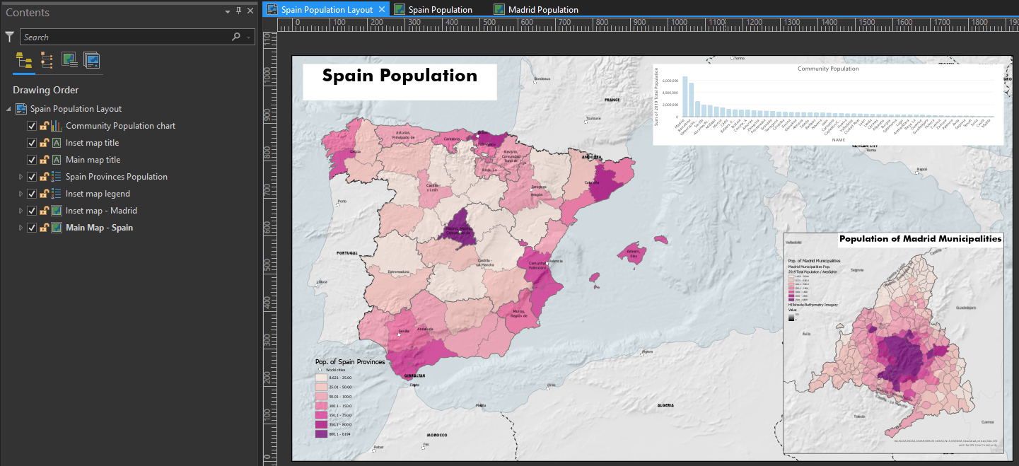

The AIX file supports ArcGIS Pro layouts with single and multiple map frames. After opening the AIX with Maps for Adobe in Illustrator the resulting AI file will have a parent layer for each map frame. This means that the two map frames for the Spain Population Map (“Inset map – Madrid” and “Main map – Spain” in image below) will be parent Illustrator layers when exported as an AIX file. Moreover, each map frame will load into Maps for Adobe as an individual mapboard in the Mapboards panel, which allows users to add new map data directly from the extension in Illustrator! For the Spain Population Map, this means that there will be a mapboard for the “Inset map – Madrid” and “Main map – Spain” map frames, and new data could be added to either of these mapboards and added to the illustrator file.
map of Spain with two map frames
The ArcGIS Pro page layout for Spain Population Map. The map frames have been collapsed in the Contents pane, so their respective layer names are not visible in this figure. Notice the two map frame names, “Inset map – Madrid” and “Main Map -Spain.” These two map frames will serve as parent layers in Illustrator, which contain all of the feature layers for each frame.
