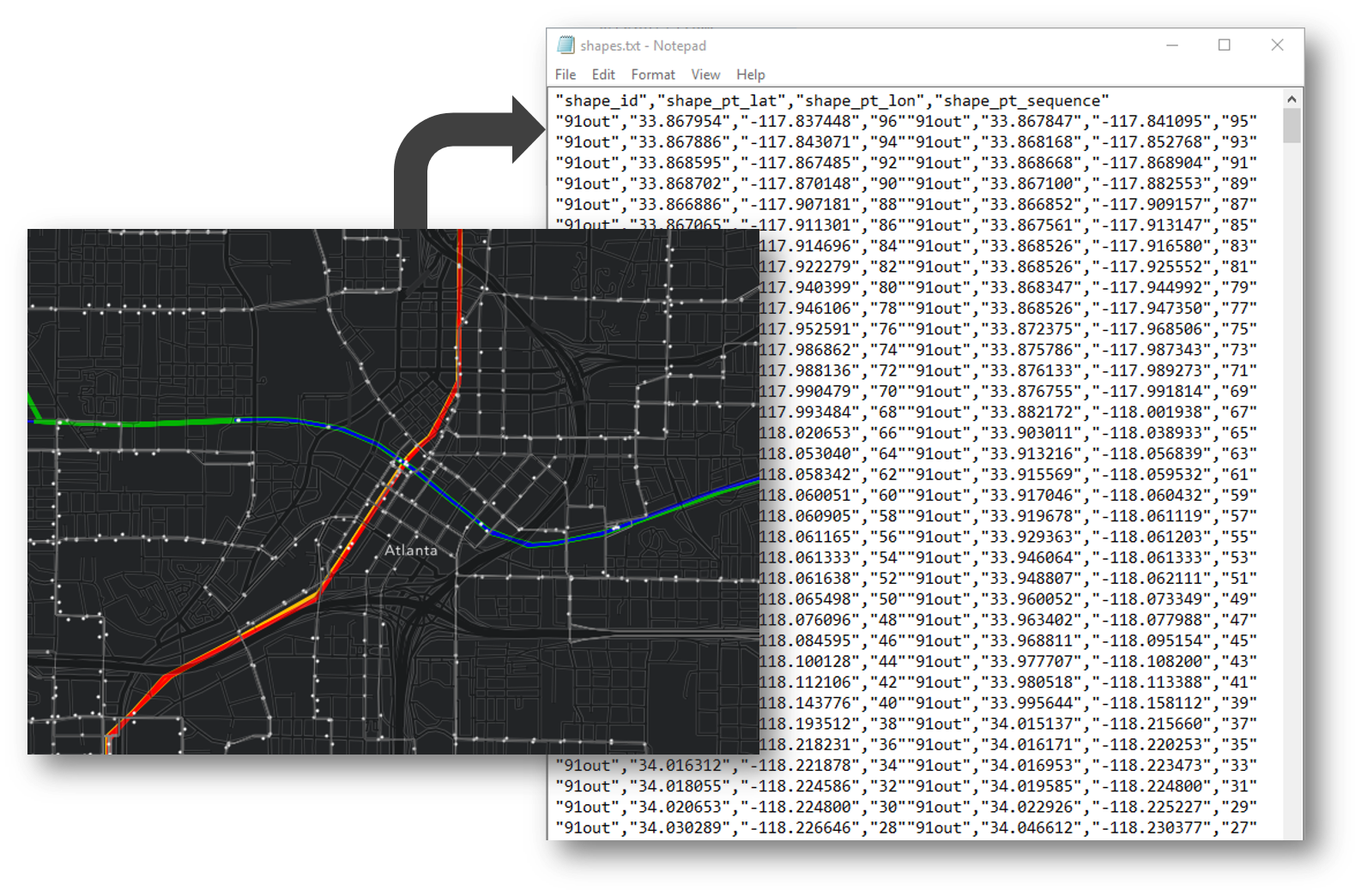

A shapes.txt file contains series of latitude/longitude points describing each unique “shape” in your transit system.  A shape corresponds to a particular sequence of stops.  You should have a unique shape_id for each unique sequence of stops in your transit system, which may or may not correspond exactly to the number of routes you have.  Some routes might require multiple shapes.  For example, half of the Bus 12 trips may divert to one end station, and the other half may end somewhere else, so you would need two different shapes to model that.  Also, if Bus 12 goes in both directions, you would need a separate shape for each direction, so four in total because of the two end stations.
Many agencies create shapes.txt files using the GPS tracks from their AVL systems or from various route planning software packages that export GTFS.  But if neither of these is an option for your agency, or if you’re unhappy with the results, give Generate GTFS Shapes a try.  You can download the tool for free using the link above and run the tool in ArcMap or ArcGIS Pro.
To use the tool, download it, unzip it, and follow the user’s guide included in the download and available online.  The first part of the tool gives you several options to generate an estimate of your shapes.  Then, you can manually edit the shapes in the map to get them exactly how you want them.  Finally, run the second part of the tool to export your shapes into GTFS format.  You can also just update a shape or two in your existing shapes.txt file if that’s all you need to do.
The Generate GTFS Shapes tool allows you to edit transit line features in ArcMap or ArcGIS Pro and export them to a GTFS shapes.txt file.
How does the tool work?  It reads your GTFS data to find all the unique sequences of stops, and for each one, it uses the Network Analyst Route solver to calculate the optimal route along the street network to visit the stops in the correct order.   The tool can either use the ArcGIS Online route service or run the calculation on your own machine with your own network dataset, depending on the settings you choose.  The tool can also generate shapes by just connecting the stops with simple straight lines.  You can choose to generate some shapes using on-street routes (like for all the buses) and use straight lines for other modes (like subways and ferries).  You can fine tune the results using several other options that are described in more detail in the user’s guide.
