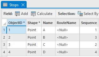

For example, you can set up a Stops table with four stops:
Table of stops with four stops and null RouteName field values
When you solve the route, you get a single route that visits each stop:
The results of a Route analysis showing all four stops on the same route
However, you can assign stops to different routes by setting a value in the RouteName field. Stops with the same RouteName field value will be assigned to the same route, and the analysis results will include a separate route for each unique RouteName in the table.

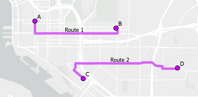

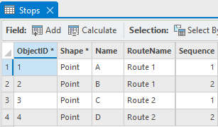

Revisit the example with four stops, but this time, use the RouteName field to split the four stops into two routes. Stops A and B both have a RouteName field value of Route 1, and Stops C and D have a RouteName field value of Route 2.
When you solve the analysis, there are two separate routes: one from Stop A to Stop B and another from Stop C to Stop D.

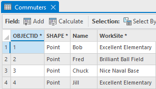

Suppose you have a dataset of commuters with their assigned work sites and another dataset with the locations of the work sites. You want to calculate the route and mileage of each commuter to their work site.
Table of commuters with unique names and a field for their assigned work site

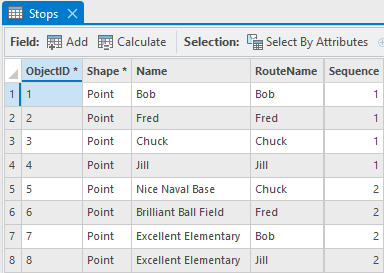

You want to add each commuter and their assigned work site to the Stops input table for the route analysis. Because you want a separate route for each commuter to their work site, you must use a unique RouteName field value for each commuter-work site pair. You’ll learn how to set this up in a moment, but first, the table below shows the output you want to achieve:
Stops table with a row for each employee and a row for each employee's work site and a unique RouteName for each pair
The Stops table has eight stops: four for each of the four commuters and four for the work sites each commuter is assigned to. Since two commuters work at the same site (Excellent Elementary), that site is included in the Stops table twice, once for each worker assigned there.

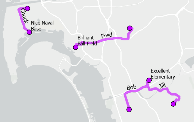

Each commuter-work site pair has a unique RouteName field value to ensure that there’s a separate route connecting each commuter and their work site. Since the commuter names are unique, you can use them for the RouteName values, but you could use anything, as long as each origin and its assigned destination have the same value and that value is unique to the pair.
The map below shows the resulting routes:
Separate routes from each commuter's home to their work site

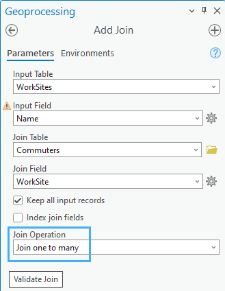

Loading the work sites is trickier because you must make a copy of each work site for each commuter who works there. You can do this using a one-to-many join with the Add Join tool.
The one-to-many join option in the Add Join tool
Joining the Commuters table to WorkSites using a one-to-many join results in a copy of each work site for each commuter assigned there. The fields on the right side of the table come from the joined Commuters table.
The joined WorkSites table with fields from the Commuters table and a copy of the Excellent Elementary record

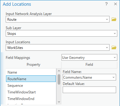

Now you can load the joined WorkSites table into the Stops table for the Route analysis. Use field mapping to map the WorkSites table’s Name field (the work site’s name) to the Stops table’s Name field and the joined Commuters table’s Name field (the commuter’s name) to the Stops table’s RouteName field. With the Add Locations tool in ArcGIS Pro, it looks like this:
Add Locations tool dialog with field mapping
As shown earlier, the resulting Stops table includes an entry for each commuter and an entry for each commuter’s work site with the RouteName field used to define origin-destination pairs.
