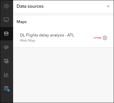

Located under the action bar on the left, the new Data sources panel gives you a bird’s-eye view of all your data sources—web maps, web scenes, standalone layers, and data expressions—all in one place. Using the Configure data source option, you can update or replace a data source in just a couple of steps.

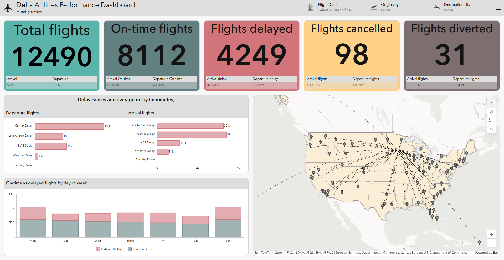

Take this Delta Airlines performance dashboard, for example— it provides a monthly performance review of the airline’s operations at the Atlanta hub. It tracks key flight metrics such as total flights, on-time flights, delays, cancellations, and diversions. Below the indicators, two bar charts effectively display average delay times categorized by cause and flight direction. Additionally, a stacked chart shows delay patterns by day of the week.
This dashboard has been carefully built with considerable time and effort. If we want to build another dashboard with a similar layout design for a different Delta hub, such as MSP – Minneapolis, we can now streamline the process using the latest ArcGIS Online update. With the new Data Sources panel , we can easily swap out the existing data source for a new one in just a few clicks. This allows us to maintain the integrity of the dashboard while updating the data.
Delta Airlines Performance dashboard for the Atlanta Hub

  • In the Data sources panel, click the Configure data source button next to the current data source.
Data sources panel in ArcGIS Dashboards
Data sources panel

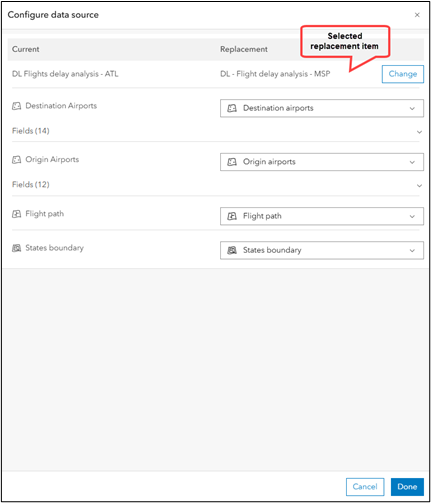

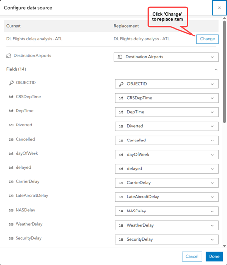

  • A window opens showing a side-by-side table: the current data source on the left and the replacement on the right. Click the Change button under Replacement to browse and select a new item.
Configure data source window to replace or remap data
  • Layers and fields are automatically matched based on their names and types. Otherwise, manually map any unmatched layers and fields, then click Done.
Configure data source window showing new replacement item on the right
That’s it! The dashboard preview updates with the new data, and the Data sources panel reflects the changes. In the example below, the dashboard now shows Delta’s performance at the MSP hub, created by reusing the original Atlanta dashboard as a template. Same layout, new insights—made possible with minimal effort.

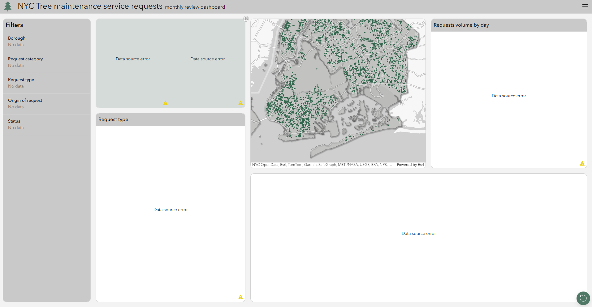

Here’s another example — a review dashboard that displays information about New York City tree maintenance service requests, including request status, total requests over time, request types, and more. However, this dashboard is currently broken.
Why?
One of the required layers is currently missing. As data evolves, this can happen for a variety of reasons—such as the layer being deleted, permissions being modified, or the layer being republished.
NYC Tree maintenance service requests review dashboard with a broken data source
Dashboard with a broken data source
Previously, fixing this meant manually investigating and updating each element—often leading to a full rebuilding of the dashboard.

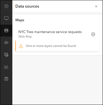

Now, the Data sources panel can immediately highlight what’s wrong—whether it’s an inaccessible item, a missing layer, or a mismatched field—giving authors a clear starting point for troubleshooting.
Data Sources panel showing an error message - "One or more layers cannot be found"

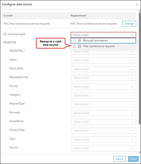

To repair the dashboard:
  • Open the Data sources panel and click the Configure data source button.
  • Replace the entire item or remap broken layers/fields to valid ones.
  • Click Done.
In Configure data source window, select a replacement to fix the broken layer

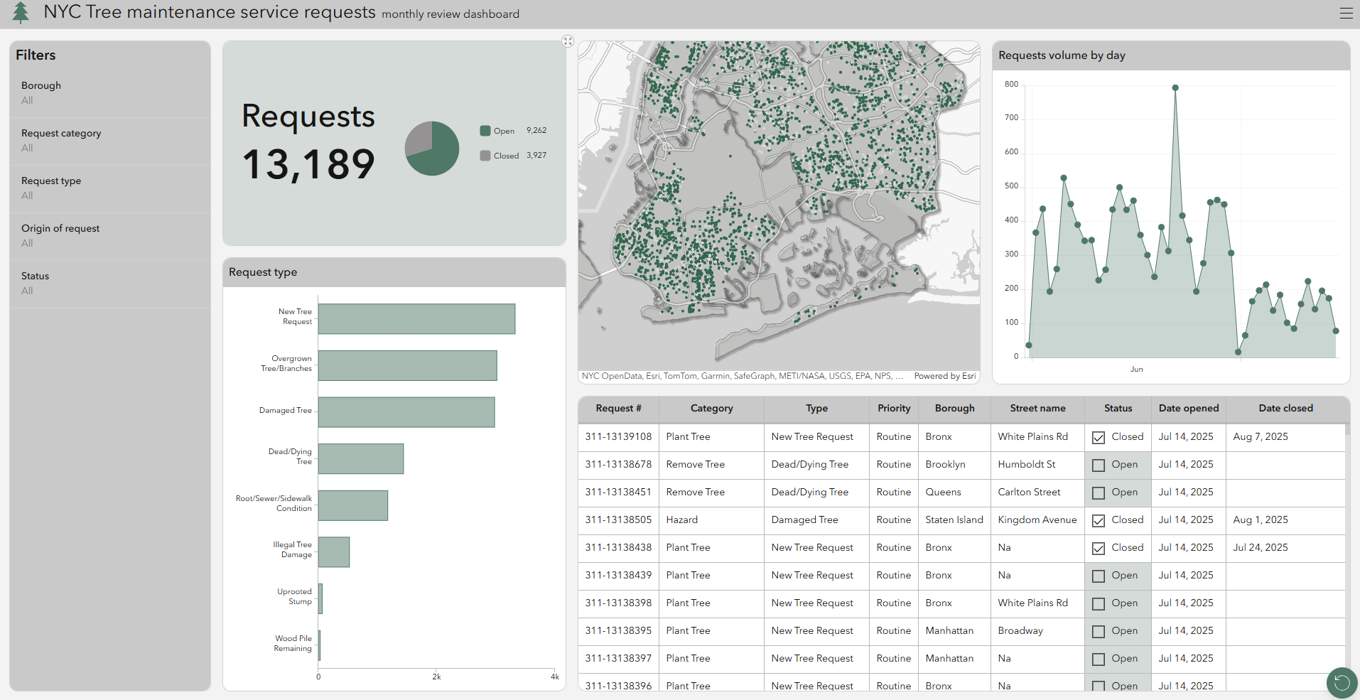

With just a few clicks, the dashboard is restored, and there is no need to rebuild elements from scratch. Here is the updated version of the example dashboard.
NYC Tree Maintenance Service Requests Review Dashboard after the error is repaired via the Data sources panel
