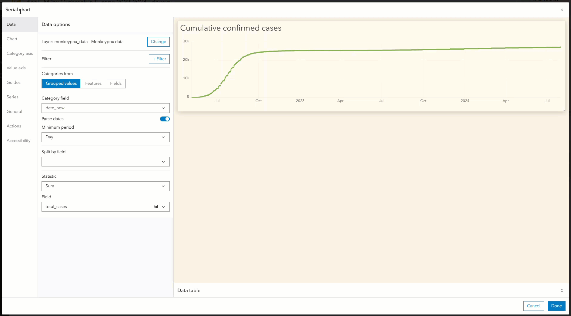

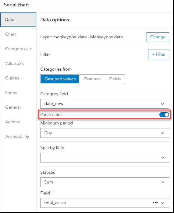

We want to add context about key dates related to the outbreak, such as when the World Health Organization (WHO) declared the Mpox outbreak a Public Health Emergency of International Concern (PHEIC). Instead of relying on sidebars or chart descriptions to communicate key dates, we can use date axis guides to display them directly on the charts. To do this, the first step is to ensure that the Parse Dates toggle is enabled in the serial chart settings. This ensures the chart correctly recognizes and displays date-based data, allowing us to add date axis guides.
Parse date setting in serial charts
Parse dates setting in serial charts

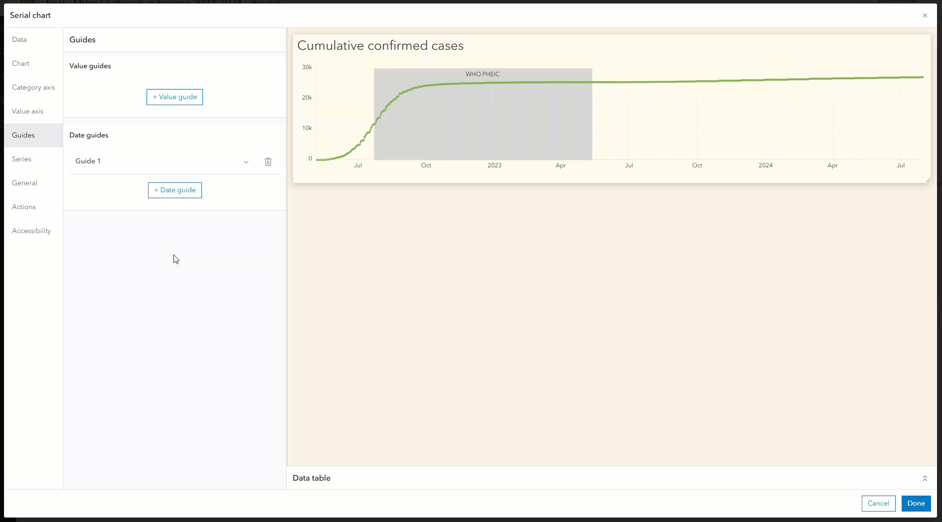

We can now configure a range date axis guide from July 23, 2022, when the WHO declared the outbreak a public health emergency, to May 12, 2023, when this status was reassessed. We can also add a label (e.g., “WHO PHEIC”) for clarity and hover text to give viewers more context on the significance of that period in the dataset.
Configure a range date axis guide

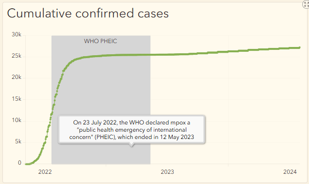

The chart immediately updates to highlight the selected date range, with the hover text providing additional details.

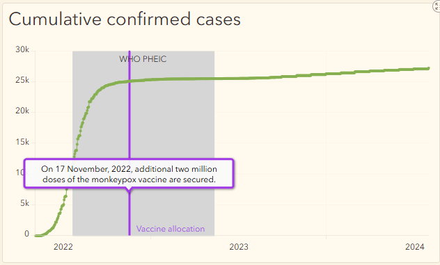

Another key date to highlight on the chart is November 17, 2022, when an additional 2 million doses of the Mpox vaccine were secured. We can add a single date axis guide with the label “Vaccine Allocation”, hover text and add a different color (e.g., purple) for easy distinction.
When labels overlap, we can easily adjust the positioning to ensure clarity—moving labels to the bottom or changing their color to make them easier to read.
Configure a single date axis guide
The chart instantly updates to show the single date axis guide along with the hover text.

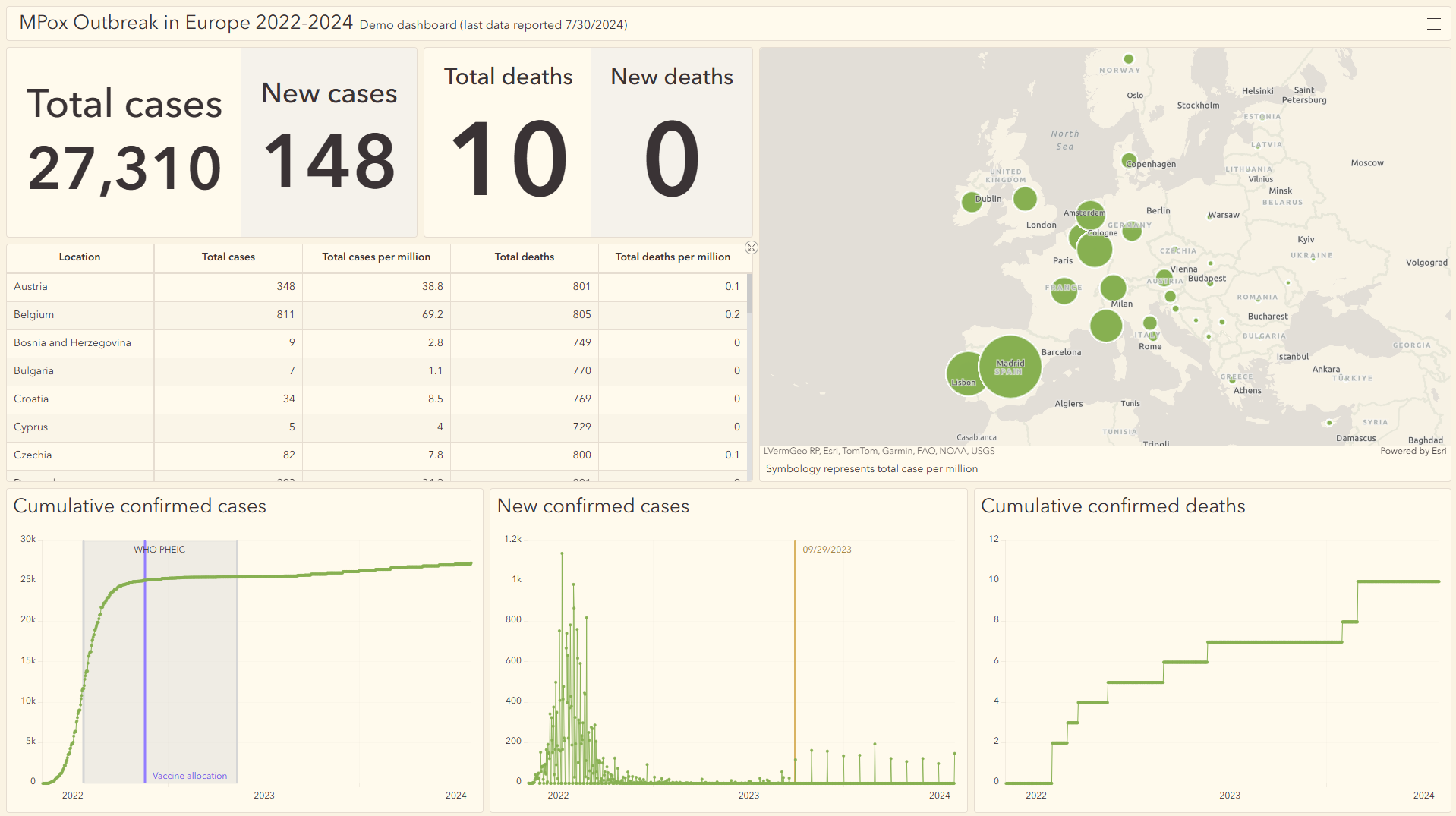

Maximizing space and improving clarity
By adding these date axis guides, we’ve effectively reclaimed space on the dashboard that would otherwise be occupied by long text descriptions. The result is a much cleaner, more streamlined dashboard that provides the same level of information—only now, it’s easier for viewers to digest.
