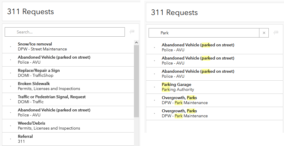

List search
You can now add a search to your list elements.  Add a search field to the top of your list to allow dashboard viewers to quickly find list items. As viewers search, the list narrows down results and highlights text matching the search input. The highlight color is configurable in the list element’s configuration.
list element search
The search field only searches for what is displayed and rendered on the list, including text from custom HTML code and advanced formatting. For example, if you have a maximum number of records set on your list, it will only search those records.

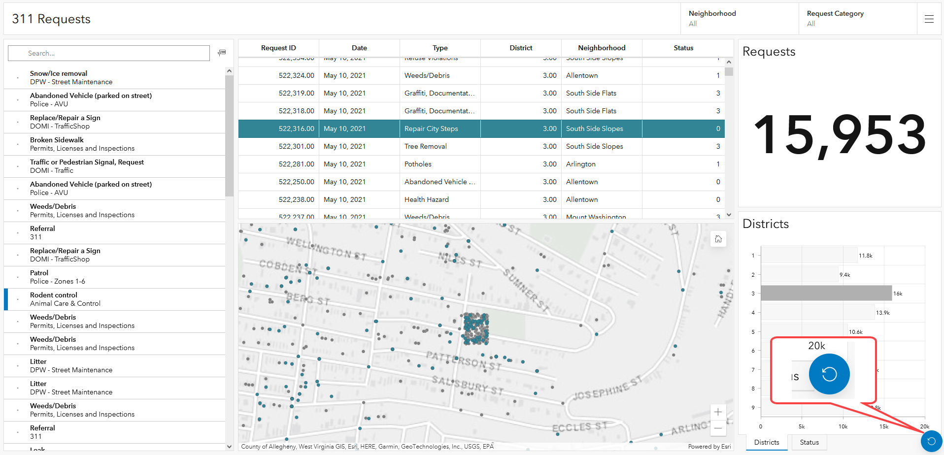

Dashboard reset
In the dashboard settings, you can turn on Allow dashboard reset to allow dashboard viewers to reset the dashboard after interacting with it. A reset button appears on the bottom corner of the dashboard when a viewer makes a selection on an element or selector, pans and zooms the map, or interacts in any other way.
dashboard reset button
Resetting the dashboard does the following:
  • Clears all selections on elements and selectors
  • Clears search inputs
  • Sets any maps to their default extent
  • Sets any map tools to their defaults
  • Returns stacks of elements to the first tab
  • Returns elements showing individual features back to the first feature

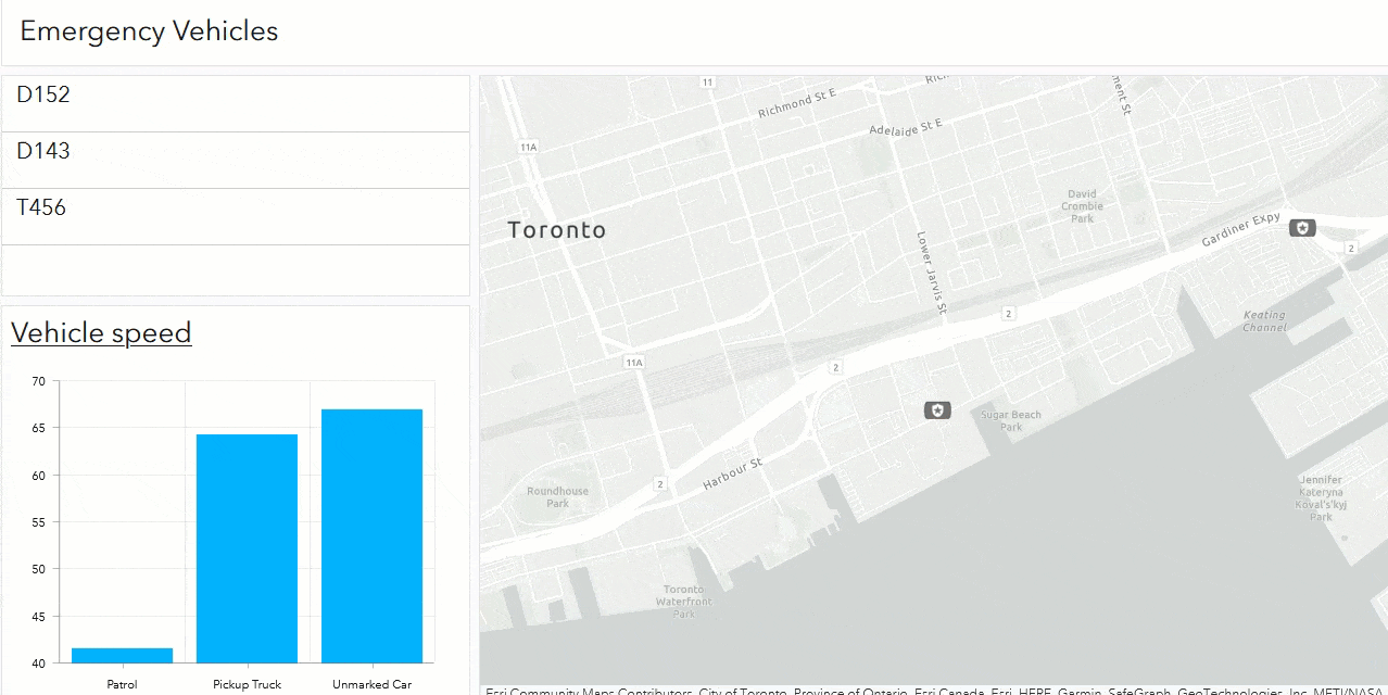

The follow feature action is now available when configuring dashboards (again, for those who previously used ArcGIS Dashboards Classic).
You can enable the follow feature action on elements configured to show features to have a target map element to pan to and remain centered on a specific feature.
following feature on map
The follow feature action is only available when the data source is point geometry and has a refresh interval set. If you previously configured the follow feature action in a dashboard that was last updated with ArcGIS Dashboards Classic, you must reconfigure the action in ArcGIS Dashboards.

  1. The reset does not reset the sizing of individual elements when allow element re-size and allow element expansion is turned on, despite the reset button appearing when resizing/expanding. Is that intentional? I would want it to reset those things, too, otherwise, refreshing the page and waiting for it to reload is still preferable.
