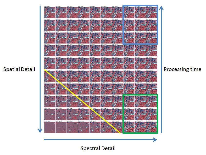

Here’s an image that shows where you want to be parameter-wise. The green box in the lower right is the good enough zone. This is the fastest processing time (high spatial and spectral detail). The blue box in the upper right is the high quality zone (high spectral and low spatial detail). You want to stay away from anything below the yellow line.
segment parameters
