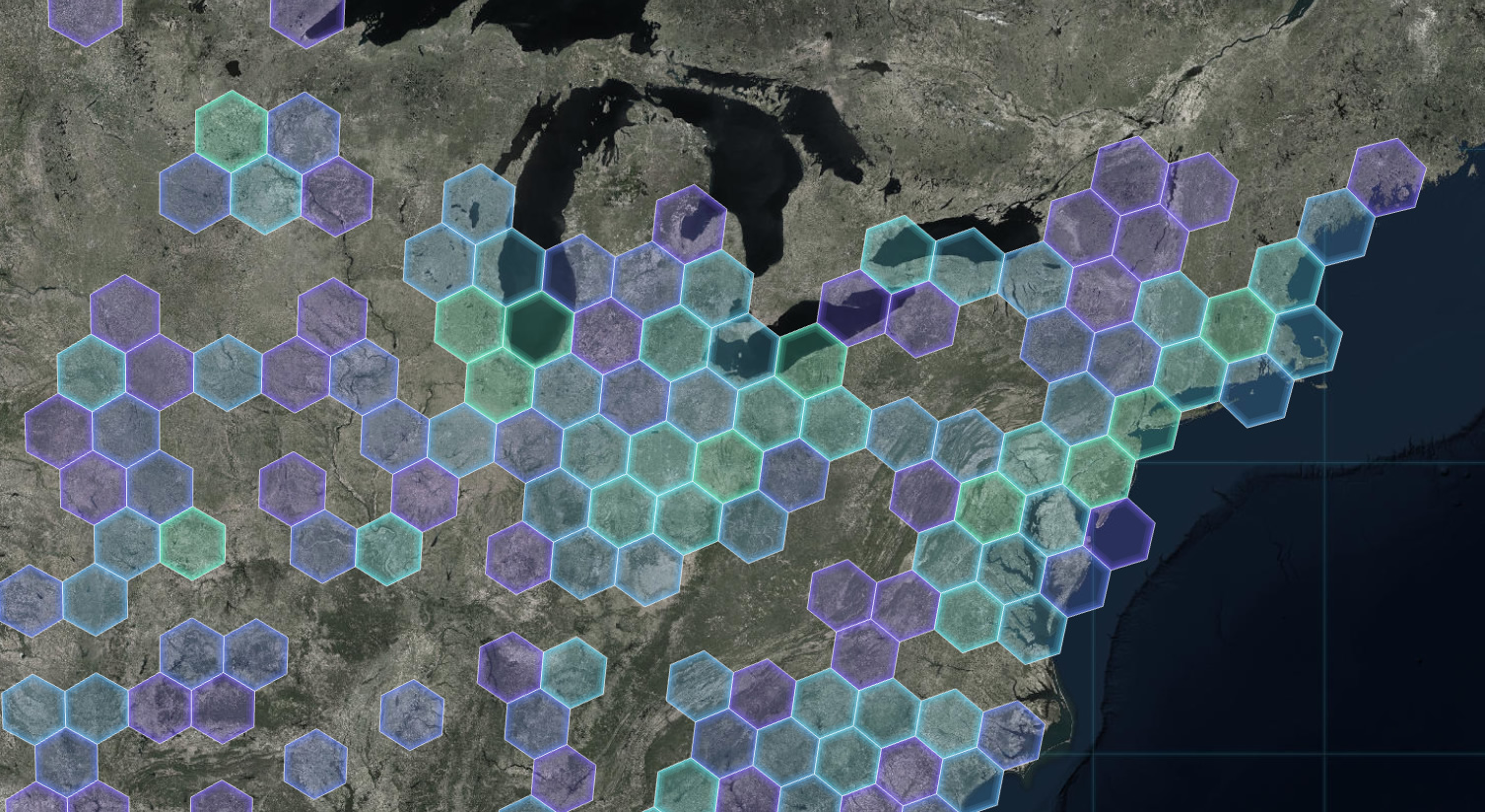

A portion of the United States with the firefly inner glow style applied to polygons.
Polygons with a style from the firefly.stylx file applied

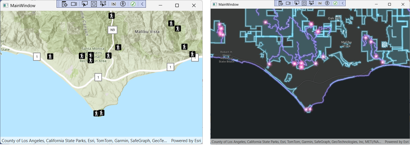

Two images comparing Malibu trails before (left image) and after (right image) the firefly style is applied

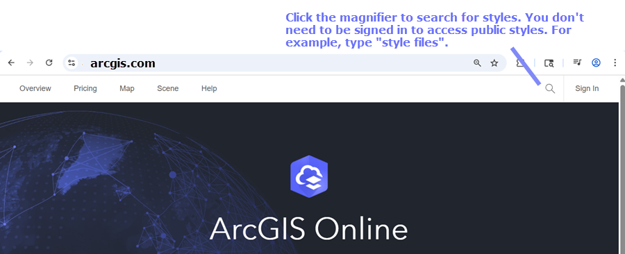

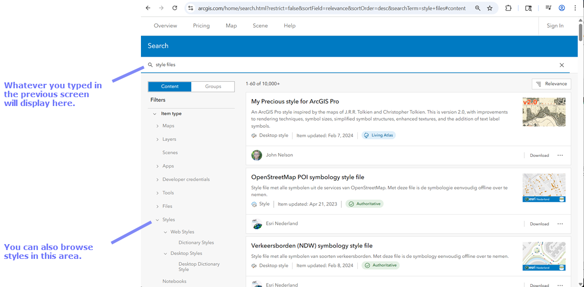

Click the search bar and type "style"
After you enter “style files,” the public style files display. You can type additional or different keywords in the search to filter the results, or you can browse all style files. For example, you can type “firefly style for arcgis pro” to quickly get to the style used in this blog.
Your search term appears near the top of the page

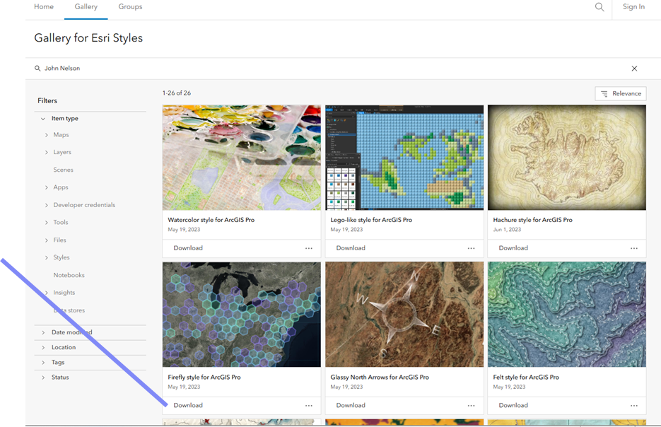

I chose the Firefly style because it can make your map elements appear to glow and sparkle.
I downloaded Firefly to my computer by going to John Nelson’s style files and clicking the Download button for Firefly style for ArcGIS Pro. I downloaded the style to my project folder (the folder with my .csproj file).
Download button is below the thumbnail

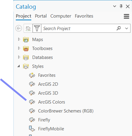

  1. In ArcGIS Pro, in the Catalog pane’s Project category (tab), I created a mobile style by right-clicking Styles then clicking New > New Mobile Style. I navigated to my ArcGIS Pro project folder, then typed FireflyMobile as the name of my new mobile style file, then clicked Save.
  2. I added the Firefly style to the project. On the ArcGIS Pro ribbon, I clicked Insert, then in the Styles area, clicked Add Style.  I navigated to the location I downloaded Firefly.stylx to (the folder with my .csproj file) and double-clicked Firefly.stylx.
    Tip: If you don’t see it where you expect, remember to click the Refresh button near the top of the Add a Style File dialog box.
  3. After I saw Firefly.stylx in the Styles folder in Catalog, I double-clicked it.

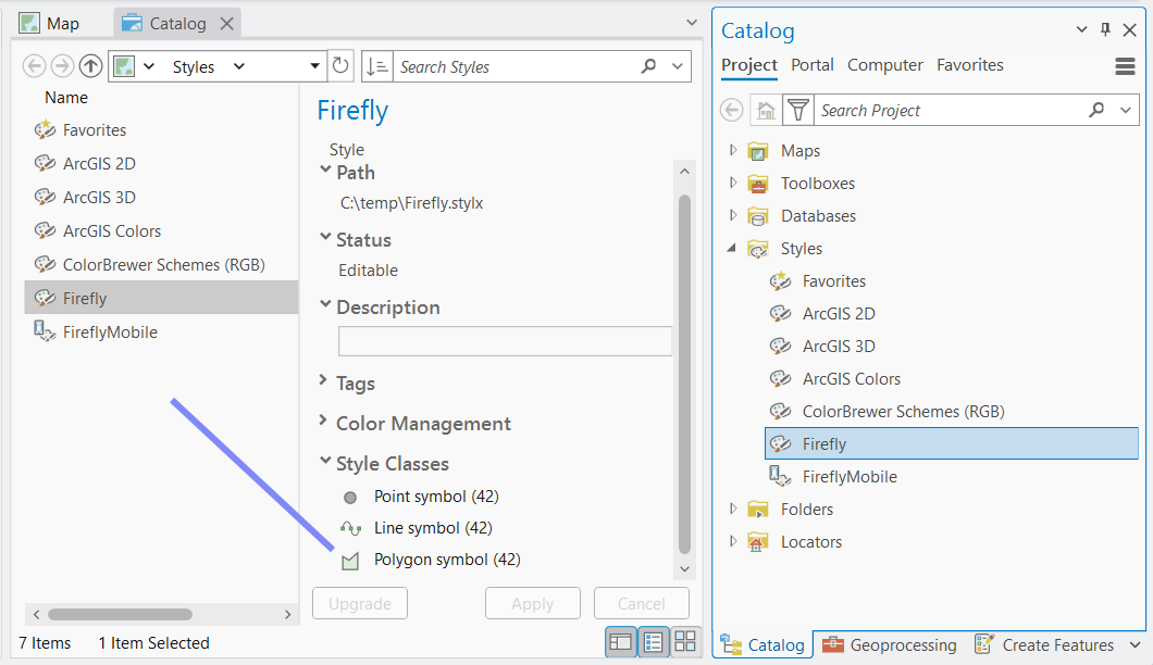

  4. In the Style Classes area that displays, I selected the first style class that stores the styles I want to bring over, Polygons.
Click the style file to display its style classes
Another pane displayed that shows the 42 polygon styles available. From there, I selected the style items I wanted to bring over. In this case I selected FireflyPoly_8 to style my polygons. I used Ctrl+C to copy it, then I Ctrl+V into FireflyMobile.stylx to copy the styles there.
