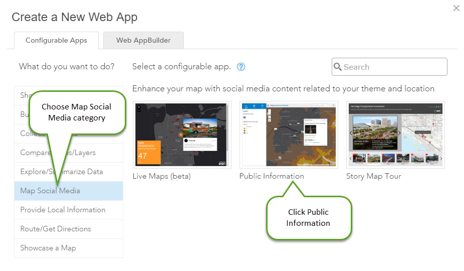

Step 2. Choose the Map Social Media category in the app gallery, then click the Public Information app.

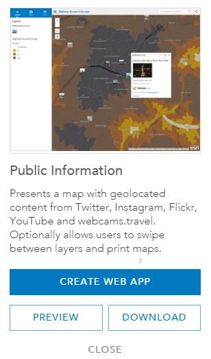

Step 3. You can download the app source, preview the app, or create the app. Choose Create Web App to configure the template.

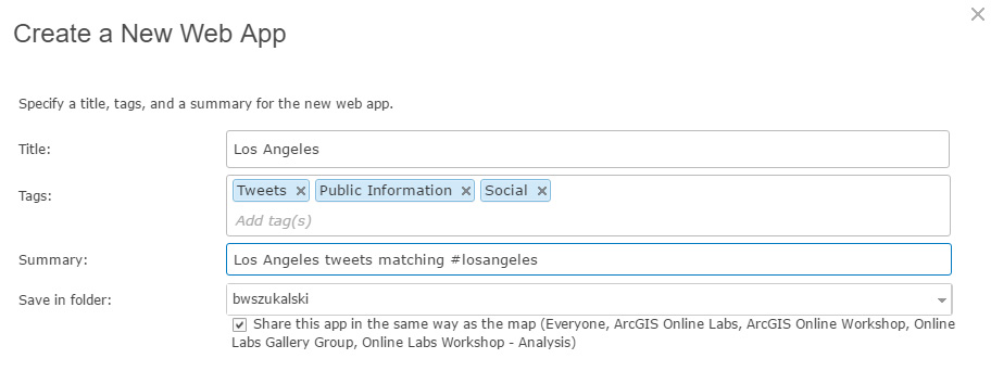

Step 4. Enter a title, tags, and a summary description for the app.
Click Done when finished. The app will display with the configuration panel.

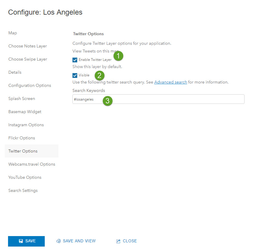

Step 5. Using the configuration panel, configure the application as desired. To display tweets automatically, click the Twitter Options tab and (1) enable the Twitter layer, (2) make the Twitter layer visible by default, and (3) set the search keyword as desired.
Click Save when finished configuring the app. Note that when testing the app you must login to your Twitter account and authorize ArcGIS access if you’ve not done this previously.

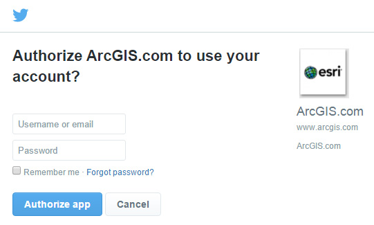

When the app is deployed, users will see a Sign in prompt:
App users must sign in and authorize ArcGIS.com to connect to their Twitter account to enable tweets to be shown.

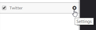

Once logged in, the user can click settings:
And can change the search if desired.
