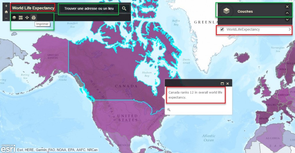

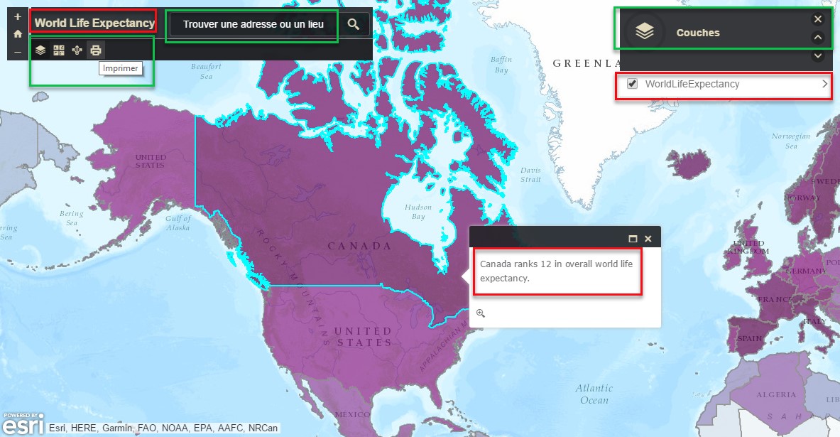

First, let’s start by identifying which data Esri translates as part of the localization process and what you will need to handle.  Esri will display all application elements such as search, element labels, and tooltips in the browser or ArcGIS Organization locale.  Green boxes show what Esri translates and red boxes highlight what is driven by web map content.  In this example, the web map and data is in English and the browser locale was set to French.
2. Translate data and create the second map.
The pop-up, app title and layer titles need to be updated in the French version.  Create a second map and update all required data to fully translate your map and app into the language you need.  Since I am using a custom attribute pop-up I needed to translate it.

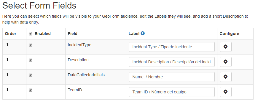

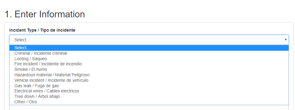

In the GeoForm application, I have four fields I will use to collect data. One field contains a domain to drive the drop-down options in the GeoForm app.  I created the domain values to appear in both Spanish and English.  A bit of planning or updating may be necessary to update your data to contain both Spanish and English values. These domains were created and published from ArcGIS Pro. 2.  Configure the application

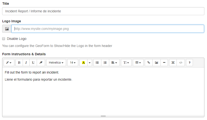

During the configuration process, you can assign a title and short instructions in both languages.
In most cases you should adjust the layer names in the web map, but the GeoForm allows you to change the field name labels in the builder.  This is a simple way to add a second language to the field name.
