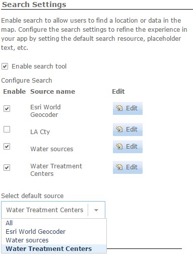

Under Search Settings in the configuration panel (shown below), you can choose what content can be searched. You can select from the Esri World Geocoder, all organizational geocode services, and any searchable layers in your map. You can select which source is enabled by default so that users will not need to change to the most relevant source after opening the map. In the example below, the layer Water Treatment Centers is set as the default.

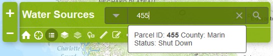

Support for searching by integer values is another new search-related enhancement included in the July update. Searching by integer values is especially useful when features have Parcel ID numbers, like the Water Treatment Centers do in this example.

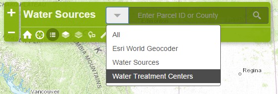

If you include multiple geocode services or searchable layers as search resources, your users can switch between them using an intuitive drop-down list. In the Basic Viewer, that drop-down looks like this:

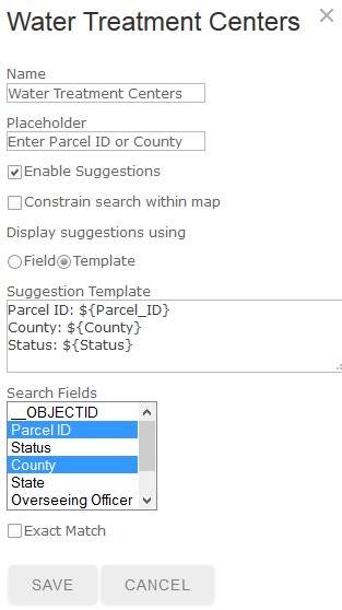

More configuration options were added to the pane that comes up when you select for a geocode service or searchable layer in the configuration panel under Search Settings. This pane makes it easy to customize the search experience for each layer:
Key capabilities include the ability to:
    • Set different placeholder texts that will appear in the search bar for each source source. You can use the placeholder text to let users know which search fields are enabled.
    • Configure which field or fields within each layer that you would like to be searchable. Press and hold the Ctrl key on a PC or press the Command key on a Mac to select multiple fields.
    • Customize a suggestion as either a field or a template. The suggestion template configured above would look like this:
