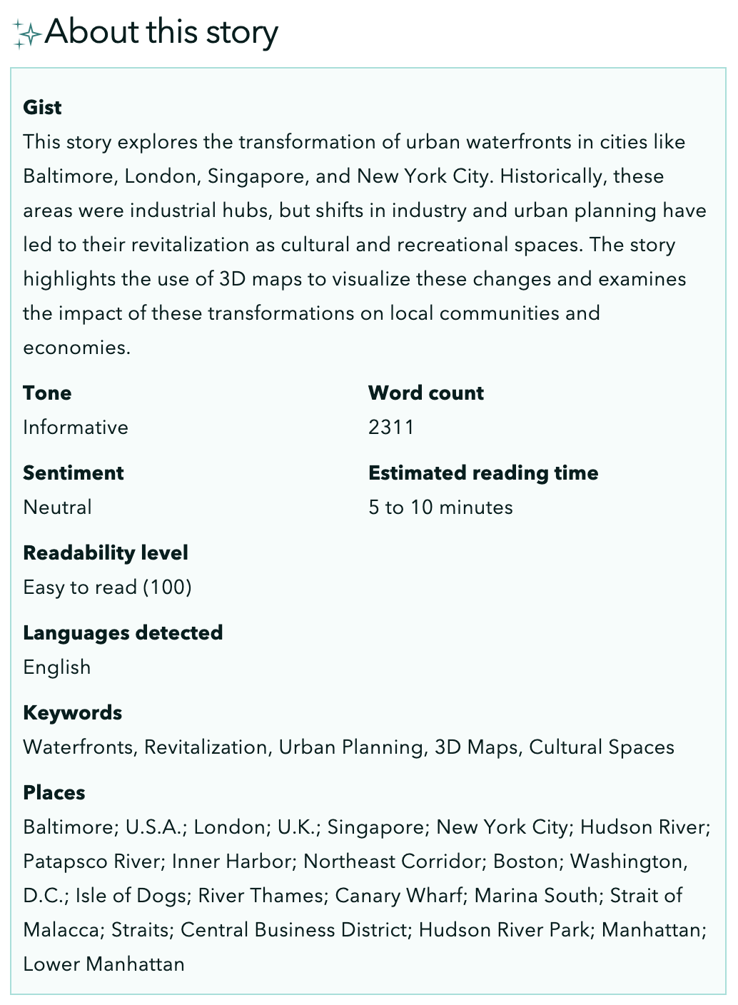

The Insights panel is comprised of two distinct sections: Suggestions (at the top) and About this story (below). About this story uses AI to provide, well, insight about various aspects of your story. Most are fairly straightforward (word count, a list of places mentioned in the story, etc.), but here’s some additional context for a few of them:
A screenshot of the About this story AI-generated information in the ArcGIS StoryMaps Insights panel.
  • Gist — An AI-generated synopsis of the story. On its own, this can already be pretty helpful, but an Update item description button at the bottom of the About this story section then applies that description (and the AI-generated keywords) to the metadata of the story’s ArcGIS Online item. Filling out the item metadata makes it easier to find that item and understand what it is within the entire ArcGIS Online ecosystem, and it’s easy to overlook because not everyone is habitually mucking around in the ArcGIS Online back-end.
  • Tone — This can be useful in conjunction with the Change tone tool in the Writing assistant (more on that in a bit). If you’re writing an academic story for the purpose of trying to obtain a grant, for example, and the Insights assistant is returning a “Casual” tone, it might make sense to run a few paragraphs through the Writing assistant and see where you can bridge the gap to something that comes across as a bit more serious.
  • Readability level — Uses the Flesch-Kincaid readability test as the base for a formula that assigns stories to one of three tiers: Easy to read, fairly easy to read, and difficult to read. If you find that you’re falling into the latter two buckets but you know your intended audience isn’t necessarily going to be comprised of professional technical experts, it couldn’t hurt to try out the Writing assistant’s revising and summarizing features.
  • Estimated reading time — this is derived using an equation, rooted in scientific studies about how fast people tend to read, that also applies weights to non-text blocks to account for the time that might be spent perusing maps or watching videos. The outcome is only intended to be a rough estimate, and the formula will continue to be fine-tuned as the Assistants beta period progresses.

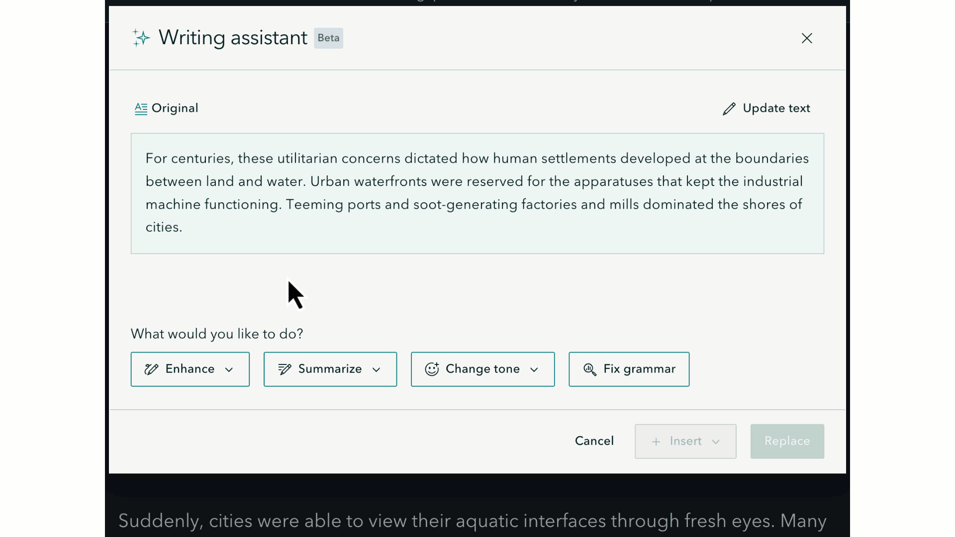

What it will do is modify targeted portions of text that you’ve already written to help add that final level of polish to a story. For instance, I know I have an affinity for sentences that can get a bit long-winded and prose that can drift in the direction of purple. There’s great value in using, say, the Enhance tool’s Readability action to make a text passage clearer and more concise.
As mentioned above, taking a look at some of the Insights assistant metrics, such as readability level and tone, can offer some hints about which of these Refine your writing capabilities might have a positive effect on your story.
What’s especially nice is you can apply multiple tools and actions in one Refine your writing session and see each iteration of the revised text before deciding which version works best for you. And you also don’t need to fully commit to replacing the original text right away; you can instead opt to Insert the revised text above or below the original text in the story builder. And, of course, if you do opt to replace your text with the AI-suggested verbiage, you can then further edit that text in the builder however you want.
