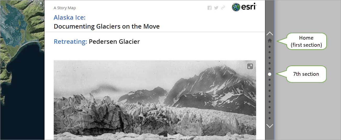

A Map Journal is organized into sections, beginning with the home section and continuing in order until the end of the Journal. The Home section is the first section, and additional sections are numbered in sequence.
You can use section numbers to open a Map Journal at specific section by adding it as a URL parameter. You can use §ion=<number> or ?section=<number> at the end of the Map Journal URL, depending on the form. In either case, <number> is the desired section number.
For example, this is the URL to Mountains of Fire:
https://story.maps.arcgis.com/apps/MapJournal/index.html?appid=4c77a56bbcd743b69232cf3fd9c7a61c
This opens the Story Map at the fifth section (note the addition of §ion=5):
This is the URL to The National Park Bird’s Eye Quiz:
http://storymaps.esri.com/stories/2016/national-park-quiz/
This opens the Story Map at the fourth section (note the addition of ?section=4):
https://storymaps.esri.com/stories/2016/national-park-quiz/?section=4

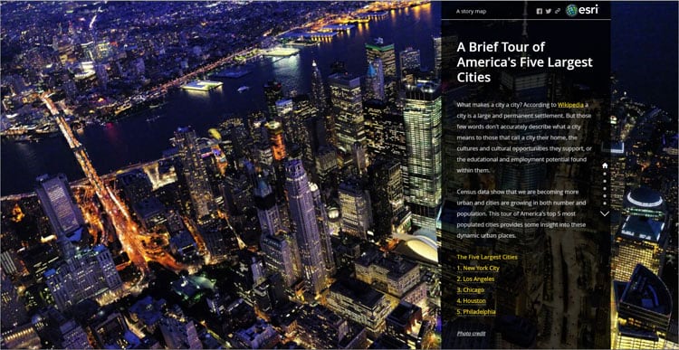

Example: A table of contents
A Brief Tour of America’s Largest Cities describes the top five cities in the U.S. The Home section is an introduction, and each of the five cities is described using a unique section that includes a map and narrative describing each of them. Story actions were used to add section links that create a table of contents in the Home section; Click any of the listed cities to jump to the section that describes it in more detail.
In each section, a Home link returns the viewer to the Home section and the table of contents, and was created using a story action.

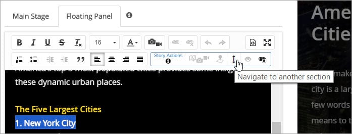

Step 2 – In edit mode, select the text you want to use as the link in the side or floating panel.
Step 3 – Click the navigate button in story actions.

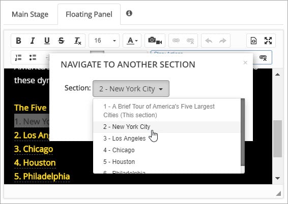

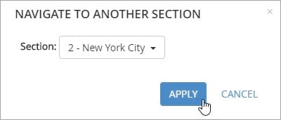

Step 4 – Choose the desired section from the drop down list.
Step 5 – Click Apply to save your story action link.
