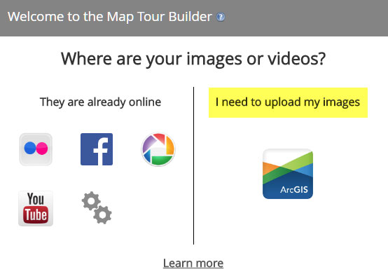

Note: the ability to add a video to your Story Map Tour will not be available if you have chosen to upload your images to your ArcGIS account by clicking the ArcGIS button under I need to upload my images (highlighted in yellow below).
If you have a made a choice from options found under They are already online, then the video button will be available.

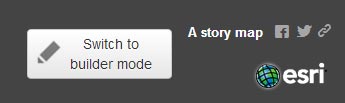

In this example we’ll add a video to an existing tour, a tour of the Esri Redlands campus. After opening the tour click Switch to builder mode found in the upper right of the application. Note that this is available only if you are the story map owner:

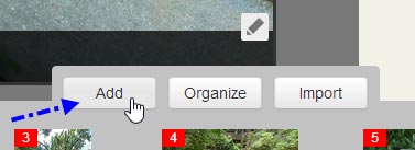

Once in builder mode, choose Add.

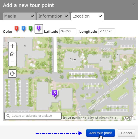

Add a name and caption for the video in the Information tab, and place the tour point on the map in the Location tab. You can change the color if you like to highlight where videos are on the tour. When finished, click Add tour point:

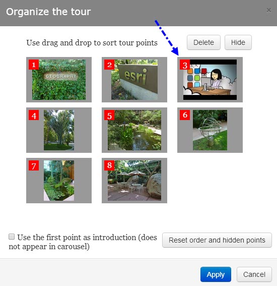

You can change the location of the video on your tour, and make other changes as desired. Below we’ve clicked Organize and dragged and dropped the video to place it at the third stop on our tour:
When finished save your map tour.

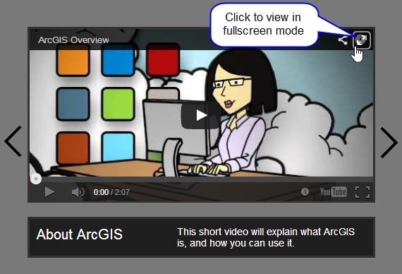

You’ve now successfully added a video to your map tour. You can open the tour and play the video when the newly added tour stop is reached. You can play the video in the panel, or click to view the video in fullscreen mode:
For best results when adding videos to your Story Map Tour, use the default three-panel layout. Using that layout the caption entered for the video is displayed underneath the video. Using the integrated layout, the caption will partially overlap the video.
