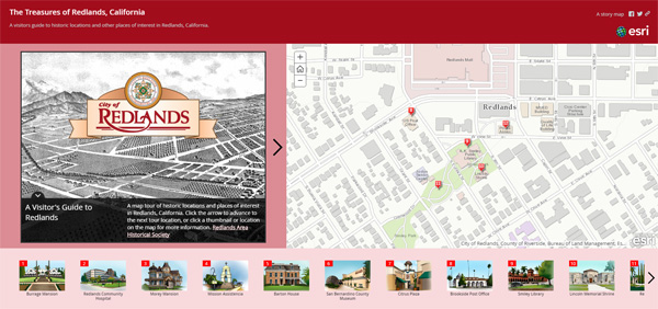

For this project we wanted to create an interactive Story Map version of a printed map included in a visitors guide published by the local newspaper, the Redlands Daily Facts. You might find copies of the guide in the visitor’s lounge in Esri’s reception area, and elsewhere around town. Here’s the printed map:
Here is the Map Tour:

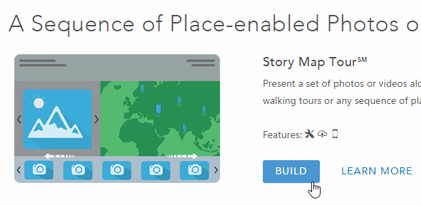

Locate Story Map Tour, and launch the Map Tour builder by clicking Build.

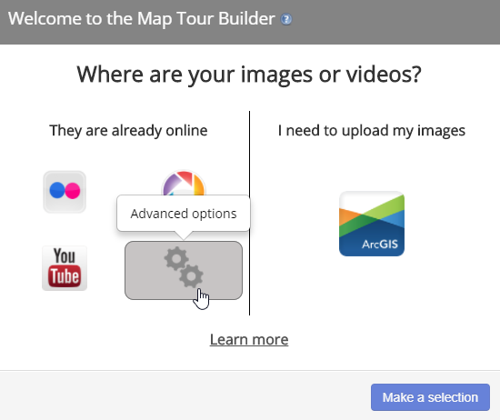

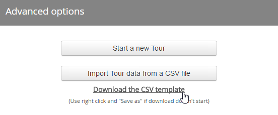

Click Advanced options (the gears graphic):
Then click Download the CSV template:
Once you’ve downloaded the CSV template, you can quit the Map Tour builder without saving. We’ll edit the CSV file and import it later.

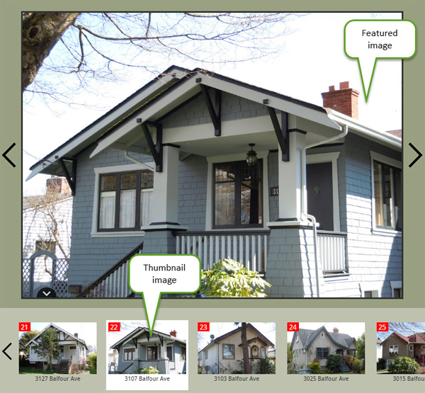

For each location on your map, you’ll need two versions of the same photograph or image. One is a thumbnail that is displayed in the thumbnail gallery, and the other is a larger version that displays in the frame for the selected location.
The size of the photos will have an impact on the performance of the application, so keep these to a minimum. For best results we recommend a size of roughly 1000 x 750 pixels for the larger version of each photo, and size of 120 x 90 pixels for the thumbnails (both at 72 DPI). Your photos don’t need to have these exact dimensions; photos and thumbnails that are different in size or aspect ratio will be fit into the application.
