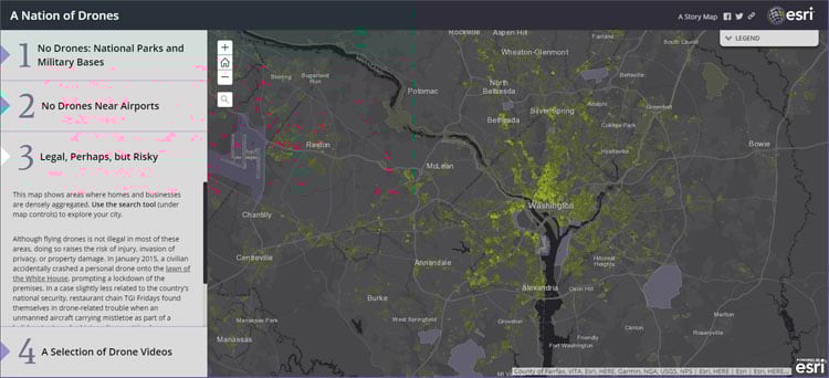

The bulleted and side accordion layout options include numbers which are ordered starting with 1, and sequentially displayed until the last entry. Below is an example of a Story Map Series using the side accordion layout (Nation of Drones). Note that the entries are display in ascending order, from 1 to 4.

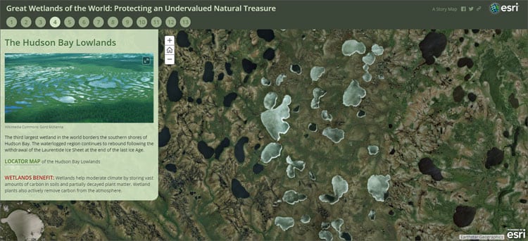

Below is an example of a Story Map Series using the bulleted layout (Great Wetlands of the World). Note that the bullets are displayed in ascending order, from 1 to 13.

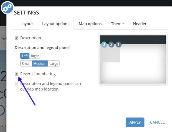

To reverse the order, in builder mode click Settings:
Then check the box to Reverse numbering:
Apply and save your changes when finished.
Instead of ordering 1 through 10, your Story Map Series will countdown from the last entry to the first. Note that reverse numbering only applies to the bulleted and side accordion layout options.
