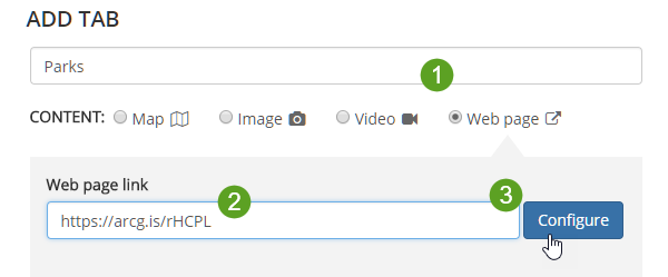

Step 1 – Using the Story Map Series builder, add a new bullet, tab, or entry and choose Web page.
Step 2 – Paste the URL for your map into the Web page link input.
Step 3 – Click Configure.

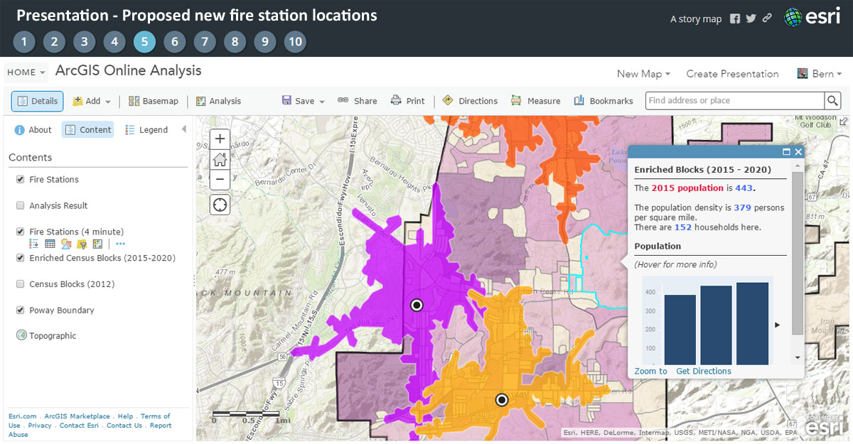

Tip: Shown below is the use of the Map Viewer in a Story Map Series (bulleted layout) for briefing purposes. The bulleted or tabbed layouts are best when using the Map Viewer within a Story Map Series.

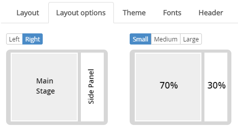

Because of the side panel in each section, Map Journal is not an ideal choice when you need to add the Map Viewer. In the Layout options tab in Settings, try placing the side panel on the right, and reducing its size. Avoid using the Floating Panel layout.

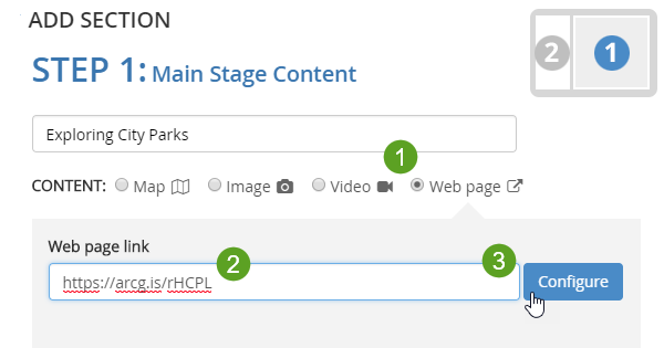

Step 1 – Using the Story Map Journal builder, add a new Section.
Step 2 – Paste the URL for your map in the Web page link input.

Tip: Because of the side panel in each section, Map Journal is not an ideal choice when you need to add the Map Viewer. In the Layout options tab in Settings, try placing the side panel on the right, and reducing its size. Avoid using the Floating Panel layout.

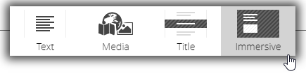

In a Cascade, the Map Viewer works best in an Immersive section.
Step 1 – Add an Immersive section.
Step 2 – Click Add media in the Immersive section.

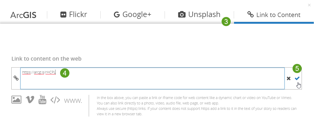

Step 3 – Click Link to Content.
Step 4 – Paste the URL for you map into the Link to content on the web input.
Step 5 – Click the checkmark to verify the link, and add the Map Viewer.
