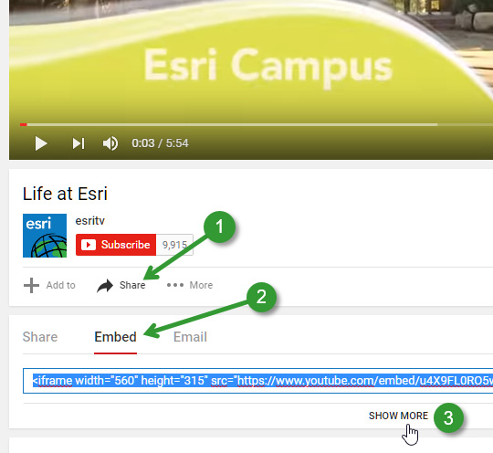

Step 1. Open the YouTube video you want to use, and click Share.
Step 2. Click Embed.
Step 3. Click Show More.

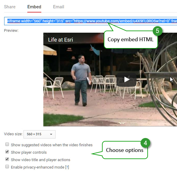

The embed code is displayed, along with options that you can toggle off or on.
Step 4. Toggle the options as desired.
Step 5. Copy the embed code to paste into your story map.
Below, Show suggested videos when the video finishes was checked off, omitting a display of related videos after your chosen video has finished.
The embed code generated is as follows:
[sourcecode language=”html” gutter=”false”]
<iframe src=”https://www.youtube.com/embed/u4X9FL0RO5w?rel=0″
frameborder=”0″ width=”560″ height=”315″></iframe>
[/sourcecode]
Note that the parameter rel=0 is what toggles related videos off. Changing the value to 1 (the default if the parameter is omitted) will toggle related videos on.

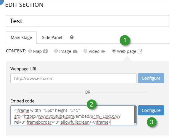

To add a YouTube video using its embed code, on the Main Stage of a Story Map Journal or Series, do the following:
Step 1. Choose Web page (instead of Video)
Step 2. Paste the code in the Embed code input.

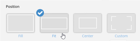

Step 3. Click Configure to choose a Position.
A good Position choice for video is Fit.
Note that the video dimensions are ignored when using Fit, the video will size automatically to fit the dimensions of the main stage.
