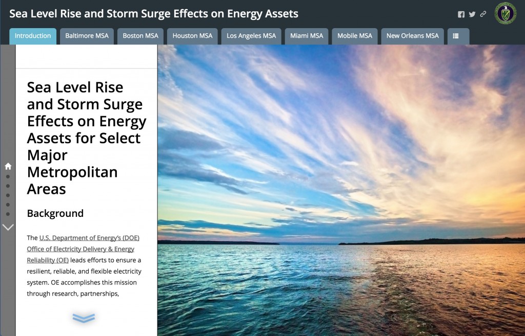

A good combination of story maps can be using one or more Journals or Cascades inside a Series (Bulleted or Tabbed layout with no side panel in sections that have a Journal). This can be a good way to break a long Journal into chapters. Here’s a nice example of this from the U.S. Department of Energy.

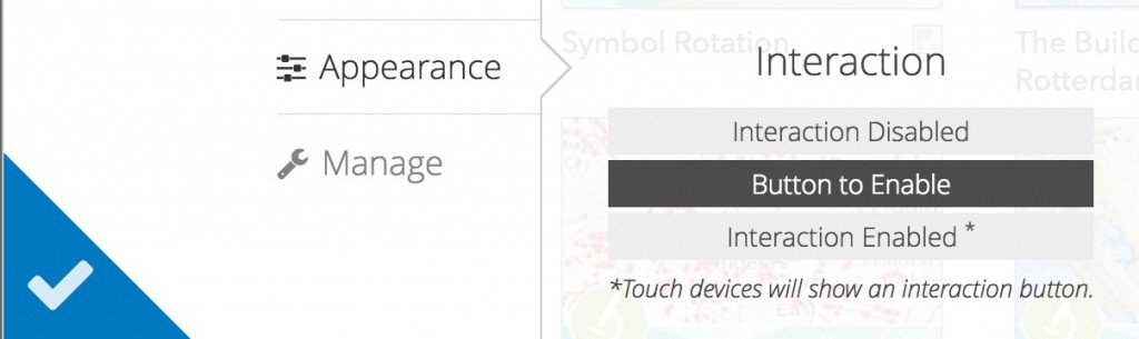

When embedding apps in Story Map Cascade, use the Button to enable option in Appearance > Interaction to prevent the scroll wheel from inadvertently interacting with the app. While embedding apps can work well in a Cascade story, it’s not recommended to embed websites in a Cascade since it can create a confusing scroll experience for readers.

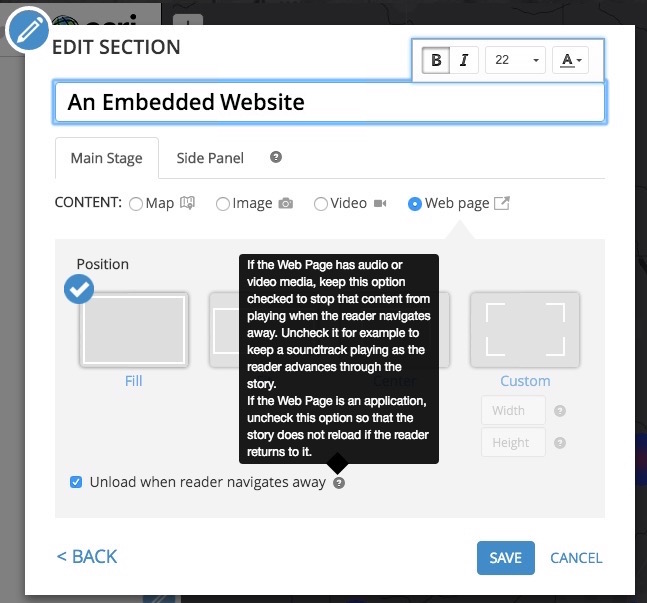

When embedding apps and web pages in Journal or Series, always use the Fill position (this is the default) so the content fills the entire main stage. Also consider disabling the option to “Unload when reader navigates away” if it makes sense for your content according the the instructions shown in the help tip.
