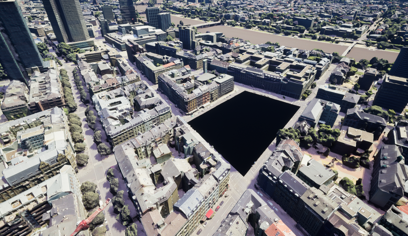

A 'clip' mesh modification applied to an integrated mesh scene layer in the game engine Unreal Engine.

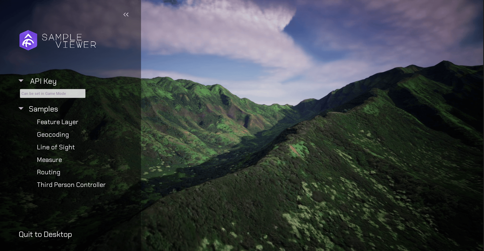

In response to your feedback, the samples viewer available from the GitHub repo has received a makeover and now has a beautiful, streamlined user interface, with many of the samples updated to follow the new style.
Redesigned ArcGIS Maps SDK for Unreal Engine samples viewer.
