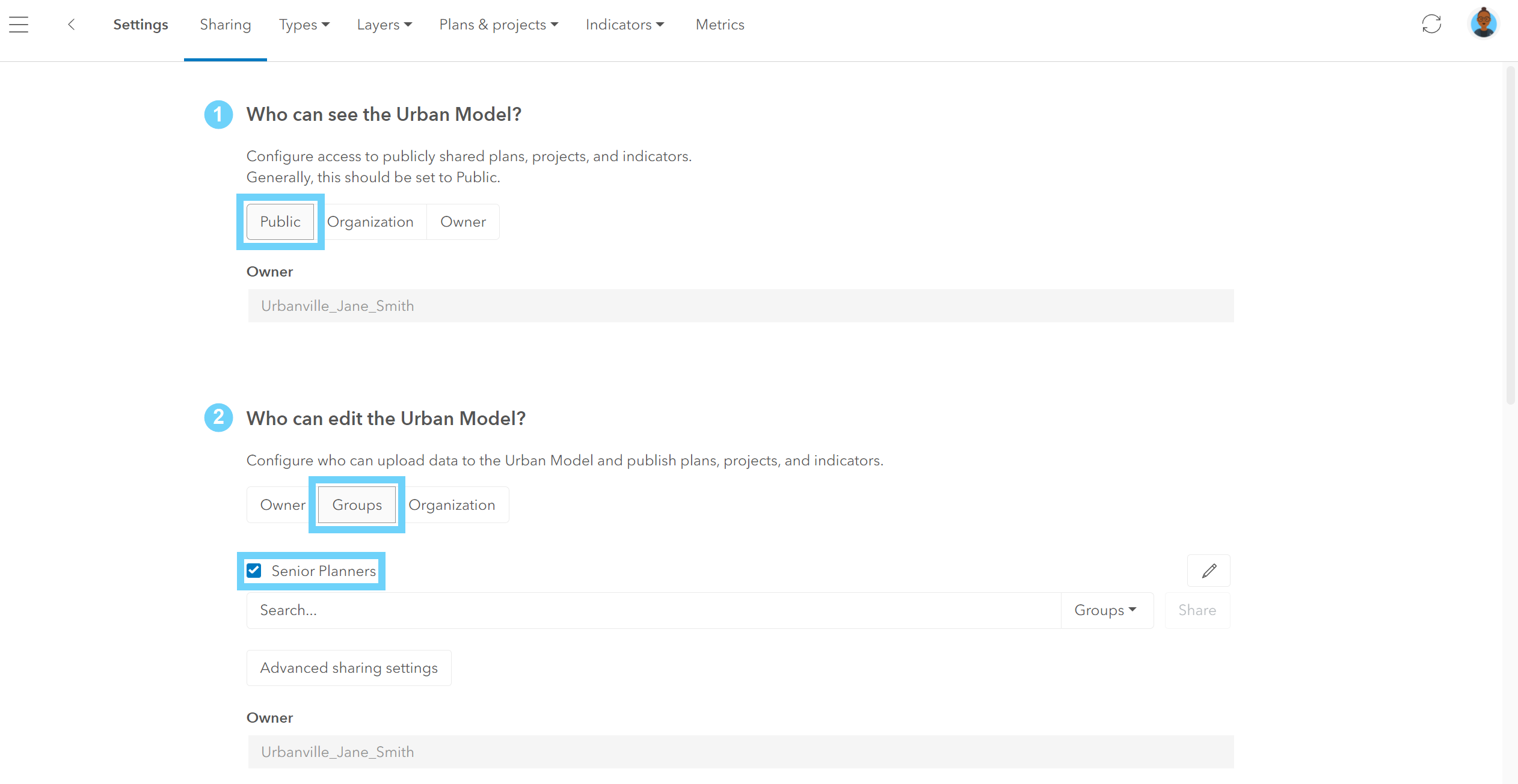

To meet the requirements of Urbanville, the creator of the Urban Model needs to configure it in the data manager as shown below:
  1. The public content view is accessible to the public.
  2. The members of the Senior Planners group can edit the Urban Model and are therefore administrators.
Sharing the Urban Model to accommodate use case 1

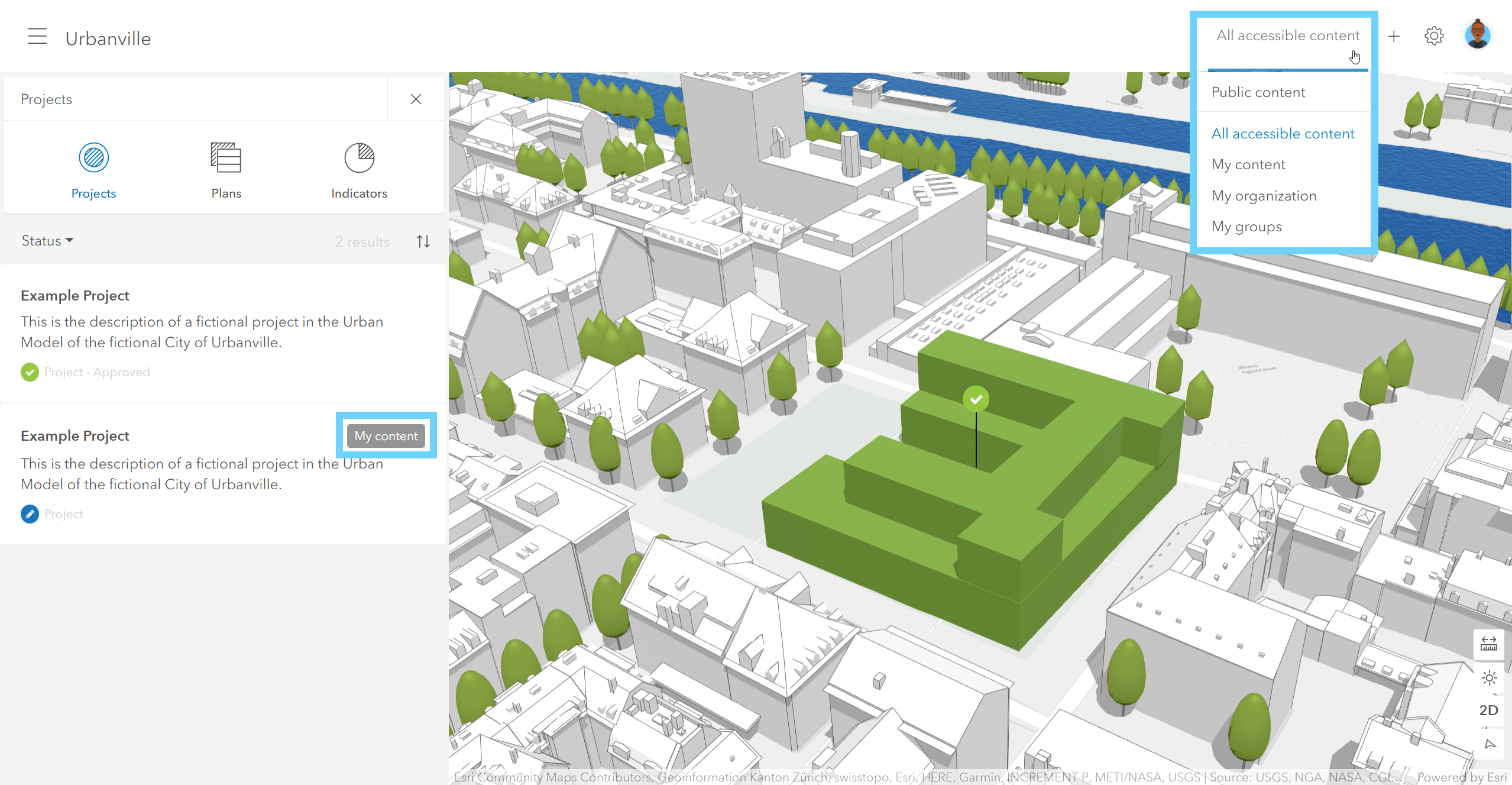

Laura, a planner working for the fictional City of Urbanville, copied a project to the public content view. In the list of projects in her content view, she’s now seeing two entries of that project. She is wondering why there is a duplicate and if also the citizens of Urbanville will see it.
Solution:
When a design plan or project is moved to the public content view, a non-editable copy of that plan or project is created. Laura has access to both, the public content view and her own design content view. That’s why in her list of projects she can see both, the original project as well as the non-editable public-content copy of it. A badge on the original project allows Laura to distinguish between the original and the copy. In the design content view, users can also use the content switch to filter the list of plans and projects as well as the map view to display only public content. Users accessing the public content view will only see the non-editable copy.
Use the badge and the content switch to distinguish between public content and design content plans and projects

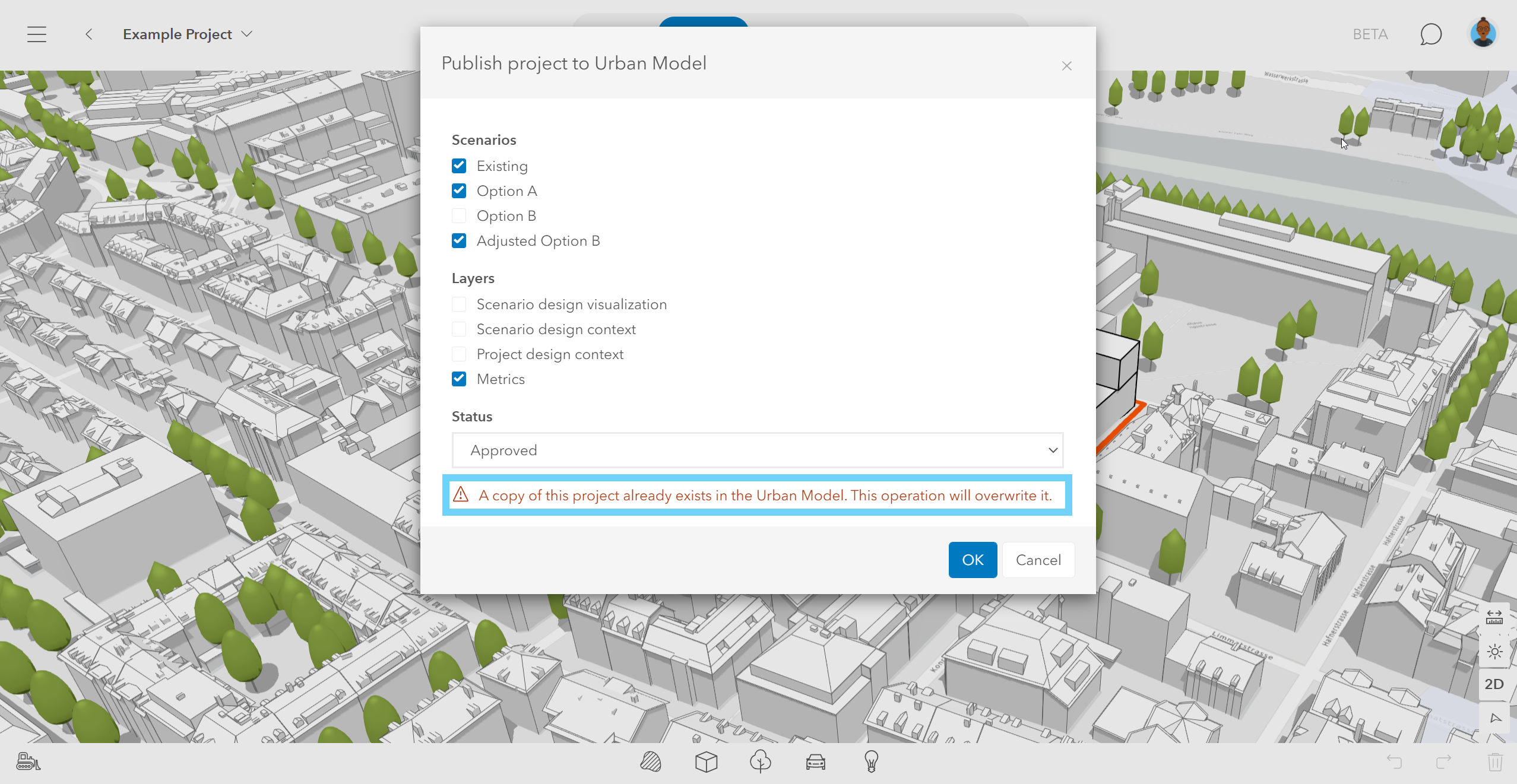

Scenarios of public content plans and projects cannot be edited. To adjust the project scenarios according to the feedback from the citizens, the planners of Urbanville need to make the changes in the corresponding project. Once the scenarios are updated and ready to be shared with the public, the project itself can be copied again to the public content view. The previously published copy of that project in the public content will be overwritten. Users see a warning message when publishing a project that has already been copied to the public content earlier.
Republishing a project to the public content view
